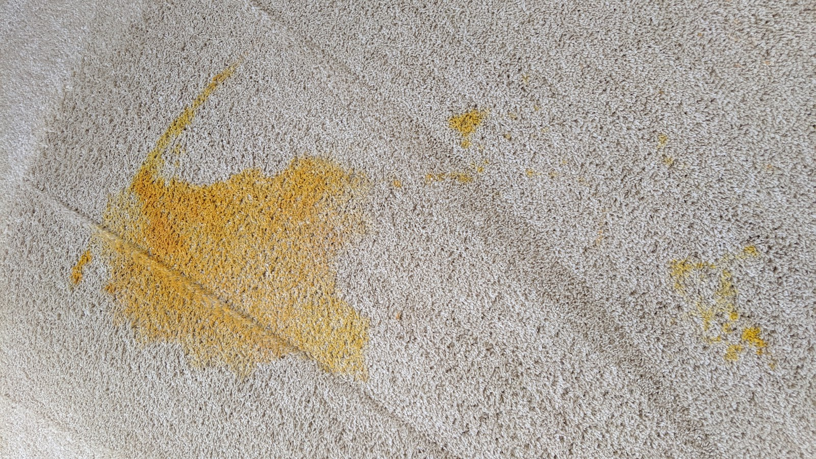

Human urine with cranberry juice and medication in it

This is after just water rinsing to remove as much pee pee as possible
To be honest I'm not sure wtf the fiber is, it's one of those that gets very dark when wet and the wand really grabs. You'd think it was wool, but it has that oily feel and no wet hair odor..
That told you all you needed to know and jibes with your following results. If a proper water rinse yielded absolutely 0% improvement...

So I tried the RedX it, which says on the bottle to use heat and almost instantly the carpet turned snow white. :icon_neutral:

I have not used heat in years. That stain is pretty bright, not a normal urine stain. I have had more success with OSR products than with 40 volume. Dwell time is the key. I doubt if it would work on that stain but I leave a 2 part oxidizer on and just let it evaporate. Usually takes about 4 hours to work. Very difficult to get something to work immediately without doing damage.
