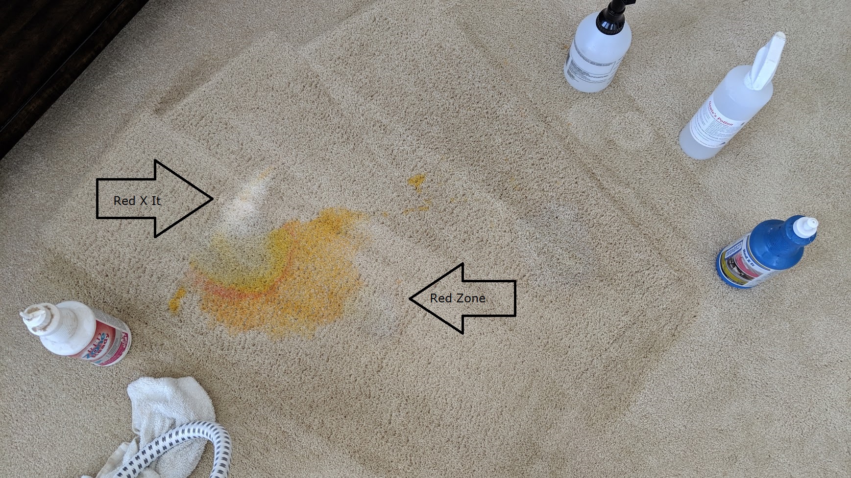

116,265

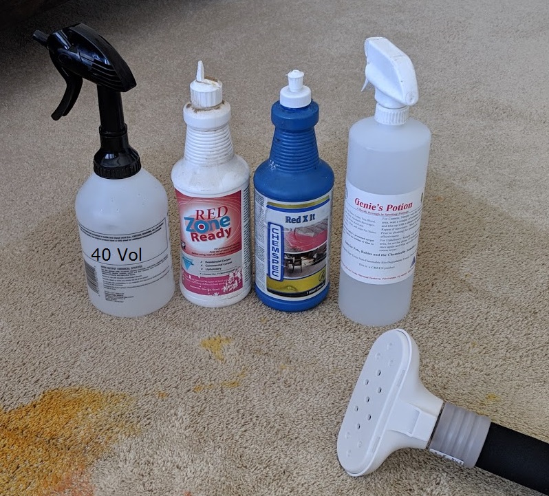

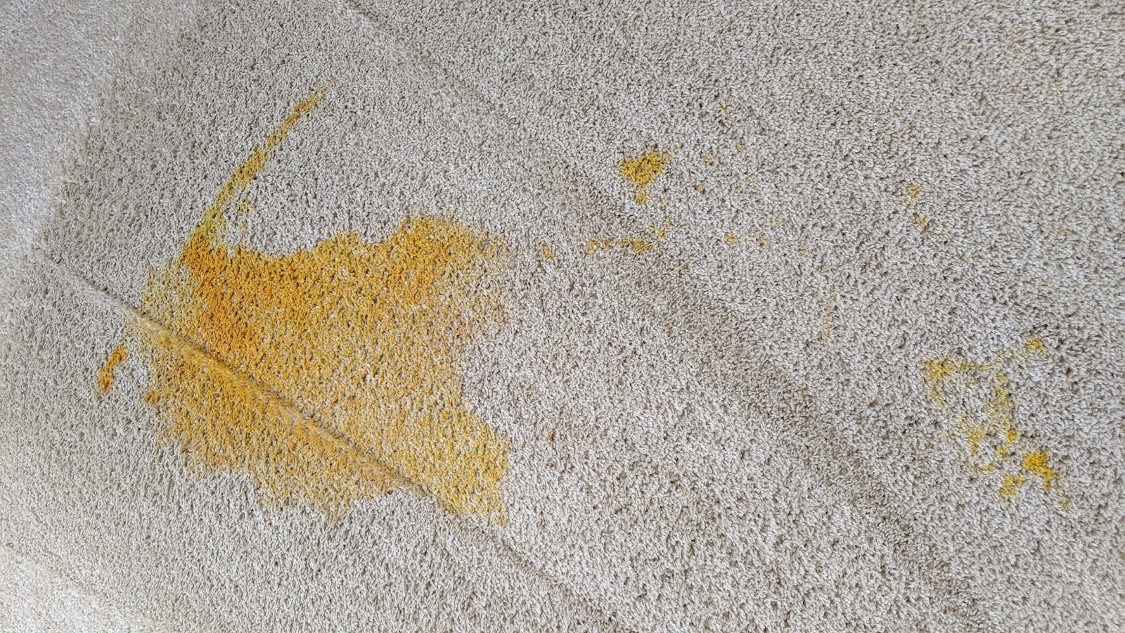

This is after just water rinsing to remove as much pee pee as possible
To be honest I'm not sure wtf the fiber is, it's one of those that gets very dark when wet and the wand really grabs. You'd think it was wool, but it has that oily feel and no wet hair odor..
90459
116,265
First I tried 40 vol and dwell time...
nada
Then I used some steam and 40...
nada
Rinsed and tried Genie Magic and heat
nada
Then Red Zone and dwell
nada
Red Zone and Heat was then tried but it was super slow and one quart would not have been enough..
So I tried the RedX it, which says on the bottle to use heat and almost instantly the carpet turned snow white. :icon_neutral:
But to be fair, the carpet turned a pinkish hue around the Red Zone'd areas.

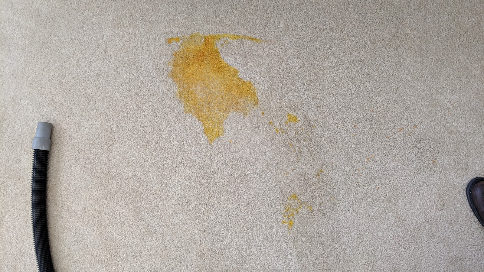

116,265
90461
I told her up front color loss was a serious risk when using heat and "dumb" dye removers that don't know which dye is which, but we both agreed what do you have to lose.
She hates the color and will veto hubby for new carpet but I left them a repair guy's number.
She watched the whole time and saw my efforts and assured me that they would not be using Google Guaranteed to get their money back. I gave her all sorts of helpful flooring tips and we talked sex, drugs and rock and roll...
