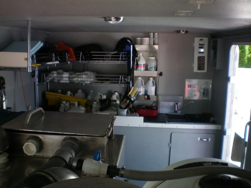

The ONE thing I over-looked when buying a box truck... LIGHTING IT! My box has no dome light in the back, and a flash-light just doesn't cut it.
What are some 12v light sources that you all have used?
