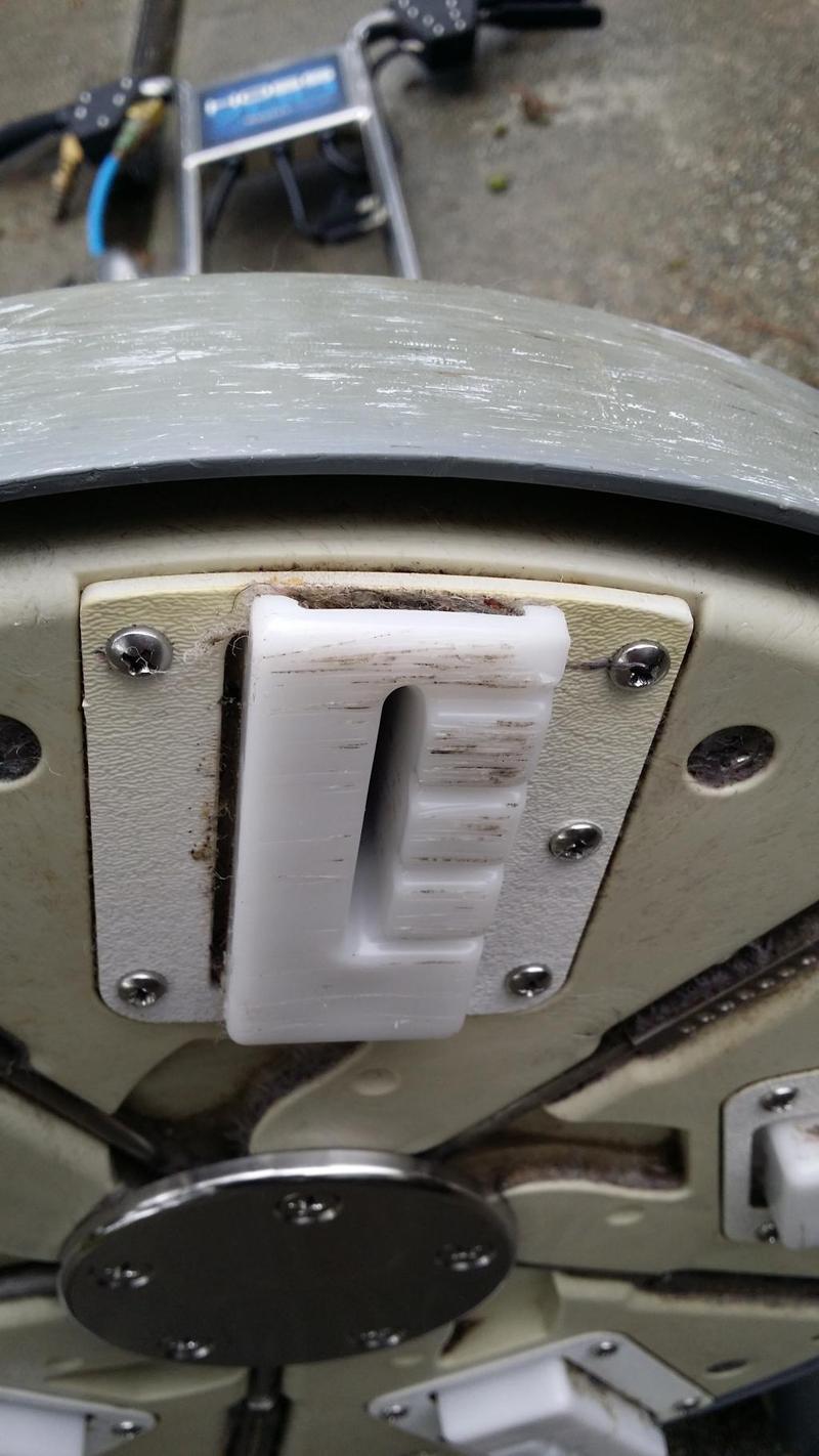

Kris, have you tried reducing your flow to help with dry time?
Check your spray bars to insure your getting full coverage.
Try a different cleaning pattern/ side to side on first wet pass then forward and back on 2nd.
I noticed your using the dripod. I find it better to groom as I go and then put air movers down.
What unit are you using?
Just thinking out loud.
116,042
here you go Keith..
