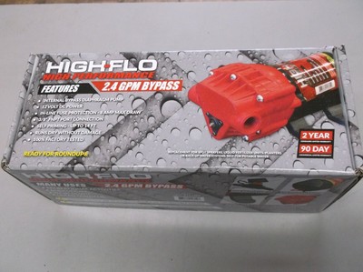

Demand pumps turn on and off with a pressure switch,usually attached to the pump.
Bypass pumps trickle a small stream back to the fresh tank and run continuously.
14,109
Do I need to install a bypass hose to send the water back to the tank somehow? Because it seems I have a bypass pump. I hope there’s some type of switch I can install to make this setup a Demand pump.
27,876
I think that has a pressure switch. It's that little square thing on the end of the pump. The only to tell is to hook it up, put a spring loaded garden spray nozzle on the end and turn it on. When you spray, the pump should turn on. When you let go, the pump should turn off.
