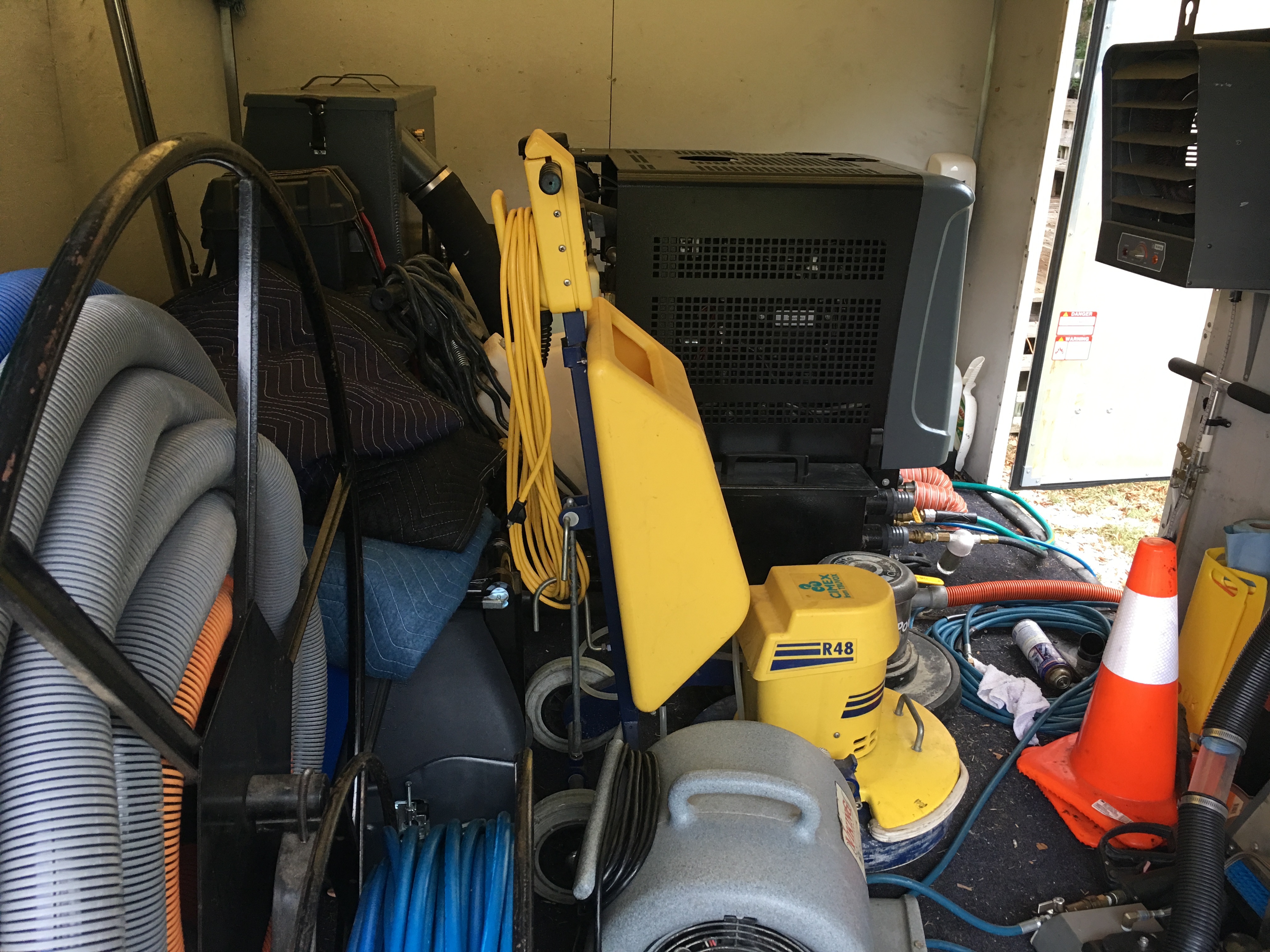

I'm on my 16th year of cleaning carpet without a supply tank and the number of apartment complexes that I'm cleaning are too much for a setup without a tank. It's a pain. I've been needing to pull my hose 200+ feet at some of these apartments just to get water. So It's time.
Can you help me find the best tank, filter and water pump?
14,109

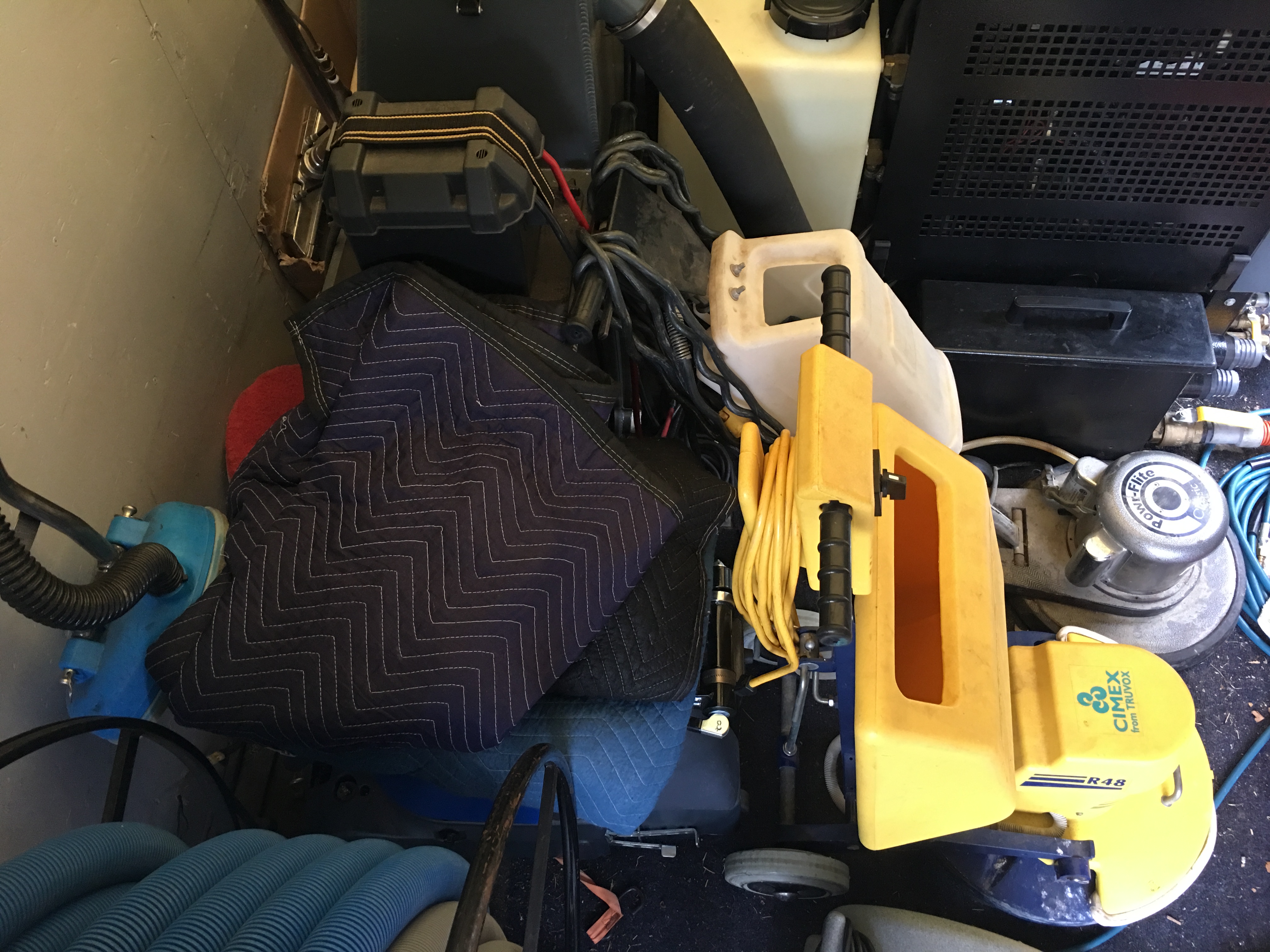

I’d like to squeeze it right where those blankets and cimex are sitting parallel to my truckmount in between the hose reel and waste tank
