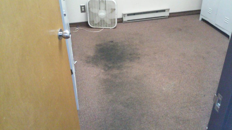

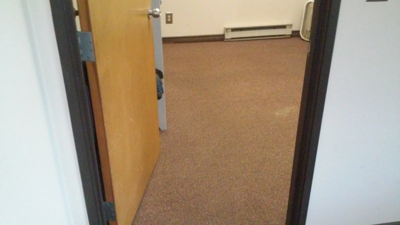

It looks so foreign to me now to see someone relying on a wand to clean filthy carpet..
I relied on a wand to clean this last month at a factory. This carpet is older than the walmart's carpet.
No hack here.

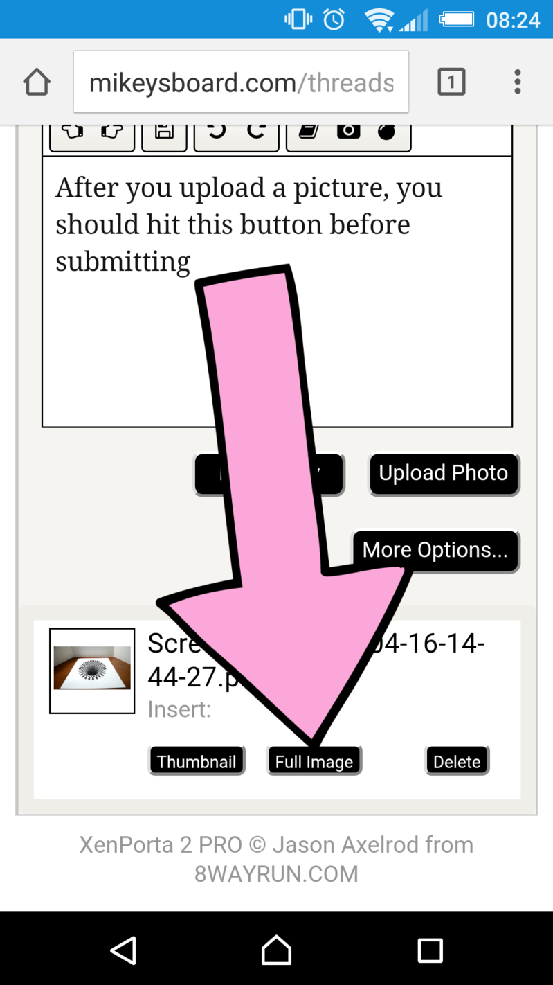

After you upload a picture, you should hit this button before submitting:
That wasn't my problem. It was how it recorded it. I laid the phone on it's side to make it record full screen, instead of laying it upright, but it still recorded like it was on upright position
I meant for you to show your pictures... I didn't even look at the video.
