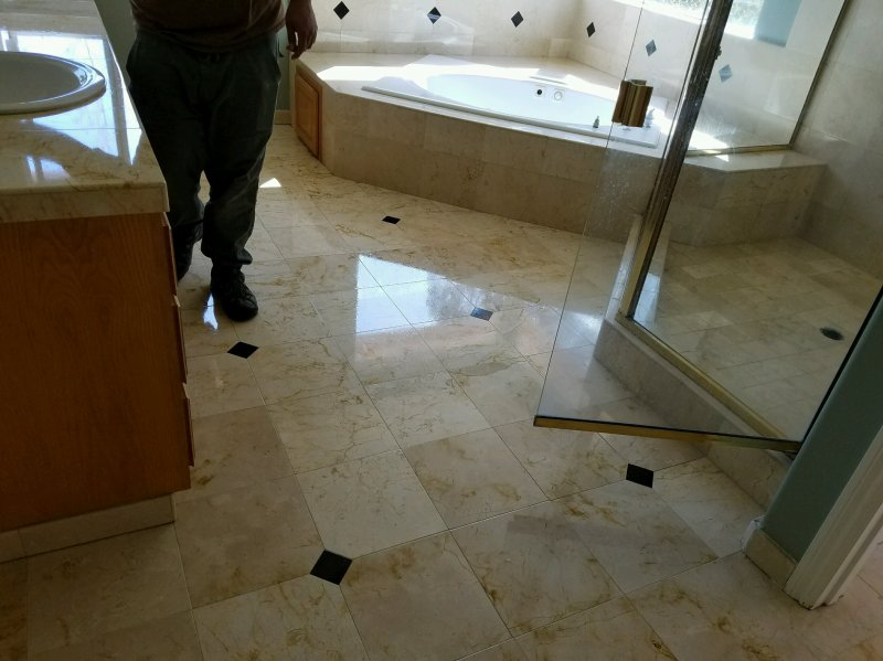

Davis wants to know how to polish this floor without scratching the inserts...
And not using a Makita to go around them..

If running diamonds. Then, yea, you want to go around. If it's damaged near the granite we will hone and polish the black granite and change accordingly

Where's the toilet?
Or is that job in Russia?
I would guess the toilet was removed to be out of the way because Davis was trained well and wants to do a quality job. great attention to details--
