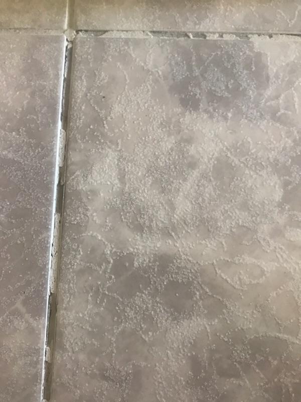

I know this is an old thread but unfortunately is an ongoing issue for me. Last year (2017) we completed a little over 5100 tile jobs. We get theses calls probably 5-8 times a year. We clean tike usually around 1250 PSI with a spinner. With this issue arising only once every 700ish jobs, it is clearly a faulty instillation. Unfortunately most customers accusing us of ruining their homes are unwilling to hear this. Usually I’ll ask them to get a repair quote and play it by ear (just pay to fix it as long as it’s reasonably priced).
It’s a tough balancing act. Too low of pressure people are pissed it didn’t clean up better. But still ensuring we aren’t causing unnecessary damage. 1250 has seemed to be pretty safe in the past.
117,320
We never have to go over 1000 because we use scrub like the dickens and are not afraid to use acids..
And carry these VERY effective stain removal Nano Aggitators..
But no cleaning will allow Color Seal to adhere properly if the grout has pre exisying conditions such as urine and oil saturation, old topicals, even if stripped, certain grout bonding or strengthening additives and most likly that nasty ass sludge you Floridians call tap water...
CJ-FL
Jan 28, 2018
448
CK-FL

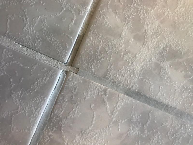

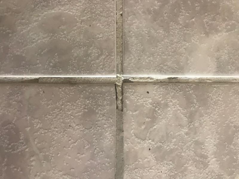

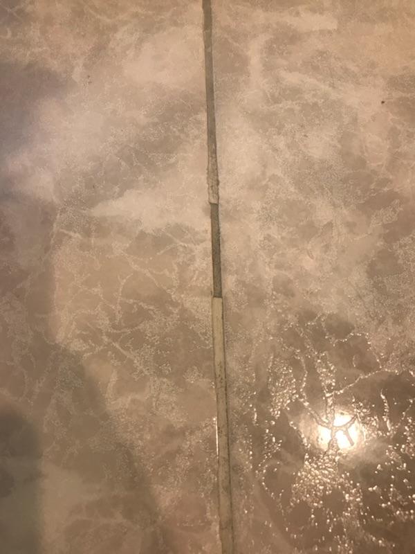

Well this most recent “grout gouging” fiasco has come to a conclusion. Come to find out a few months before hiring us to clean the tile & grout the customer had a competitor apply s “skim coat” of grout over the existing grout. Quite literally did not attempt to remove any grout prior to regrouting. Simply filled the recessed grout line with new grout probably 1/32” thick making it completely flush with the tile. Then is pissed at me when it blows out. He littered said he is “selling the house” and wants me to “re skim coat it so he can sell the house”. He “doesn’t care how long it lasts”. Just wants to be able to sell it. I told him I refuse to redo an already improper installation and pass the buck to the next homeowner. Now he is “taking me to small claims court”, and telling everyone how we ruined his home and don’t stand behind our work. SMH
