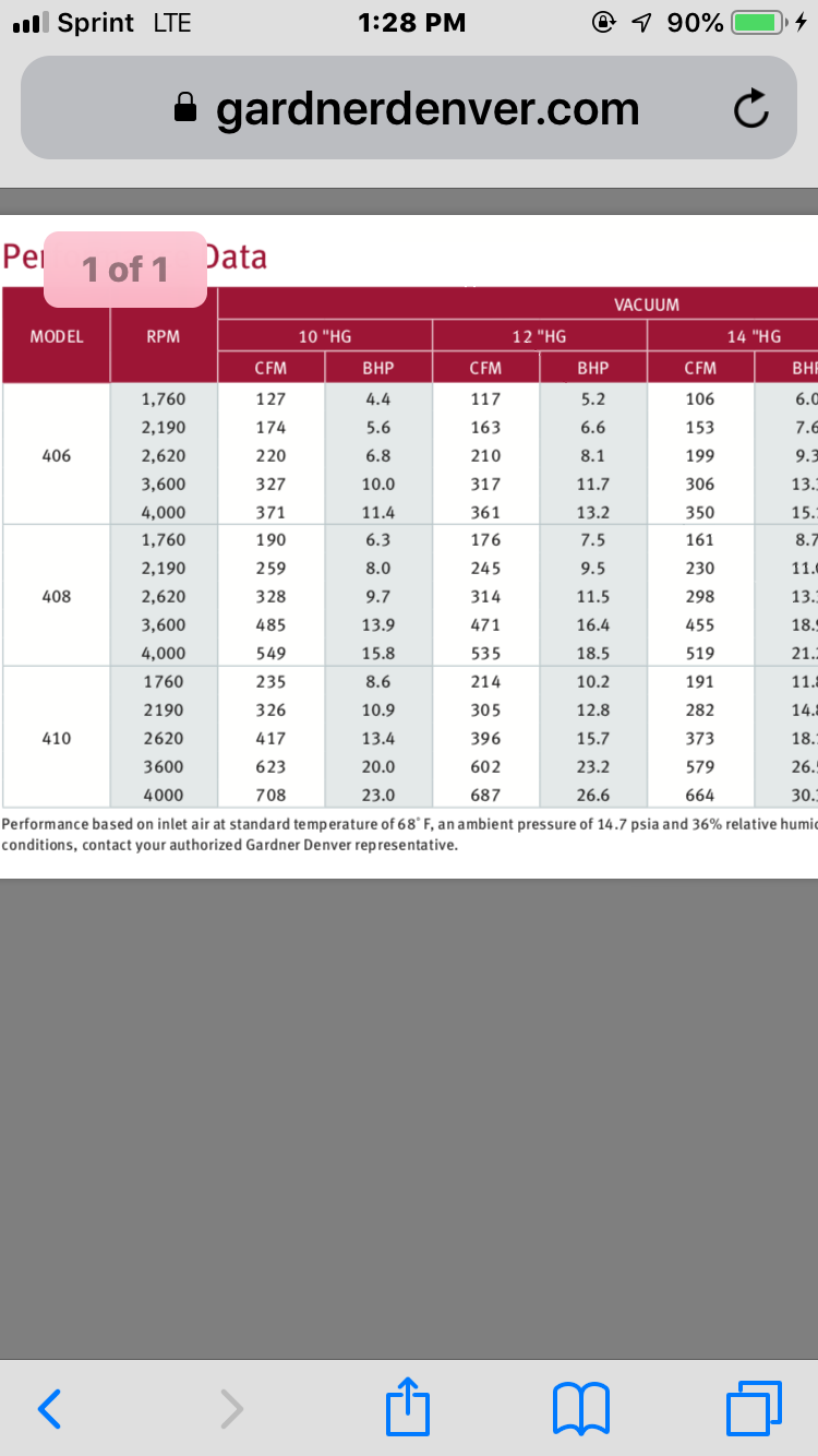

I believe the model number for that tri lobe is 410. It's the biggest one they have on the performance sheet for the Gardner Denver tri lobes. The 650 is probably just an advertising number for cfm.
Correct it’s a 4:10 blower also 650 is probably with a larger opening then the spec sheet
27,935
You also notice that as the inches climb, the CFM goes down. I don't think there is any advantage to increasing the lift beyond 13 or 14. Maybe if you're running 300 ft plus hose lengths or dual Wanding.
