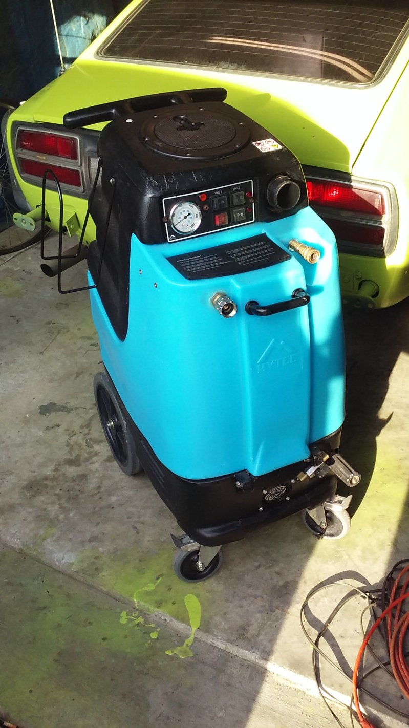

I'll only use this when I cant get there with my tm. Picked her up today for $500. Mytee 1003hx.
When I first puchased the old 1003 I had to run descaler to get it operating. Unit had been sitting for many years. Do you think its time for that again?
This time I lost pressure while cleaning. I used Flowade last time.
