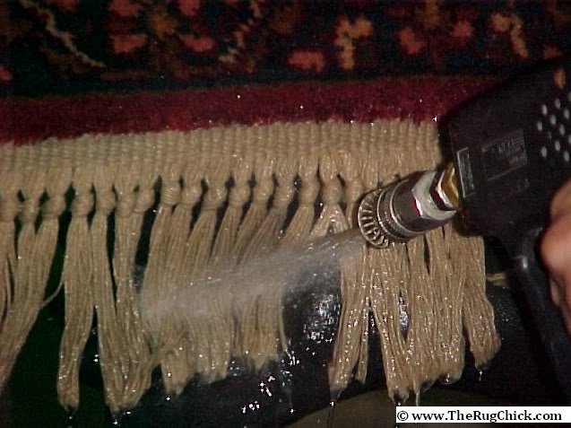

If the fringe is too fragile for scrubbing, or you are worried about untwisting strands (good question by the way...) - then you can use warm/hot water and help spray out the soil.
In this photo, you can't quite see - he is wearing a black electrician's glove to protect his hand and arm as he sprays hot water on the fringe to clean it.
Now... if the fringe is really bad .... you can charge $15-25 a linear foot and put some new fringe over the old. Problem solved! :)

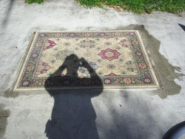

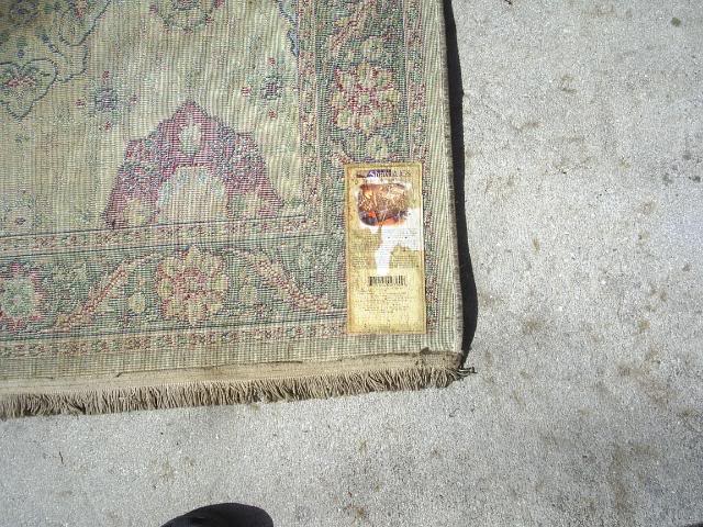

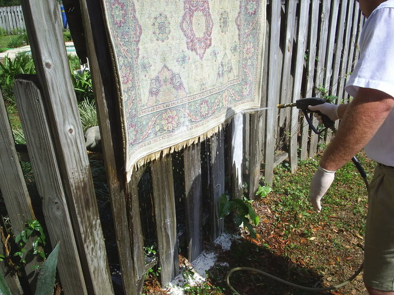

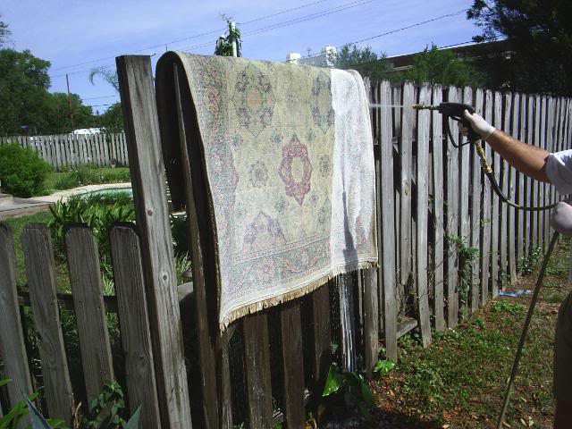

The cleint requested the rug be cleaned as an "add-on"...She was Quoted $250.00 to
have the rug Pit Washed. Her response was... :shock: ...
The rug was "Riddled with Cat Urine"...& The fibers were "Brittle" from NUMEROUS cleanings
with "Woolite" Rug cleaner..!!!! The rug smelled HORRIBLE...
She ask if there was anything we could do at a ChEaPeR price... :?: We told her we could
FLUSH the rug out & treat topically with Hydrocide & leave outside to DRY...for $150.00..
There would be "NO GUARENTEE"...&...She would have to "SIGN-OFF".. Thus the PICS.. :wink:
No sHaMpOO...here...The gloves are to protect the tech from the URINE... :roll:
Rug was vacuumed ...Flushed at 500 PSI... hot water...Fab-Set was metered @2gph...
Rug was then...Steam cleaned.Hydrocide was topically applied,and groomed & left to dry..
Customer was contacted the following day...Rug was still "Damp"...but cleint was :D
We have since cleaned the rug, in place with the RDM.It looks great..MISSION ACCOMPLISHED.
