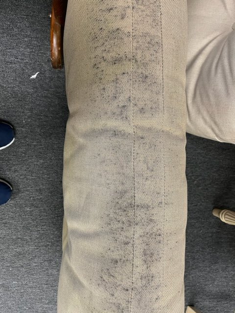

Any recommendations on what to try next on these patio cushions with black mold that is not moving. Tried, zep, bleach, and water with Fels Naptha and Oxiclean. This is the only set of cushions that nothing we try gets the mildew off.
Use the Zep, let it dwell a bit and then as heavy a brushing as the fabric can take. And of course follow with steam extraction.
Not all cushions used outdoors are outdoor cushions.
Chinese "outdoor look" fabric, natural fiber fabric, UV sensitive thread... and something we're seeing more and more, the wrong foam that holds water.
