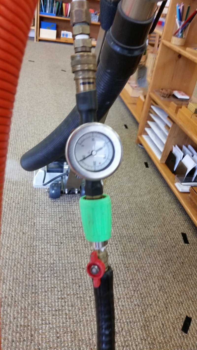

13" Zipper Jr. PSI 450, 9503 x 5 =15 flow, slot front glide, holed rear glide, 250° + temp gauge pegged, 4.5 blower out 200' hose, 25' of 2" the rest 2.5".... Granted the temp would be between 230°-250°+ depending on how long I hold the trigger down.... The longer I hold it, the hotter it gets...
I'd choose the Cimex/Zipper Jr on commercial jobs...... Works for us...
