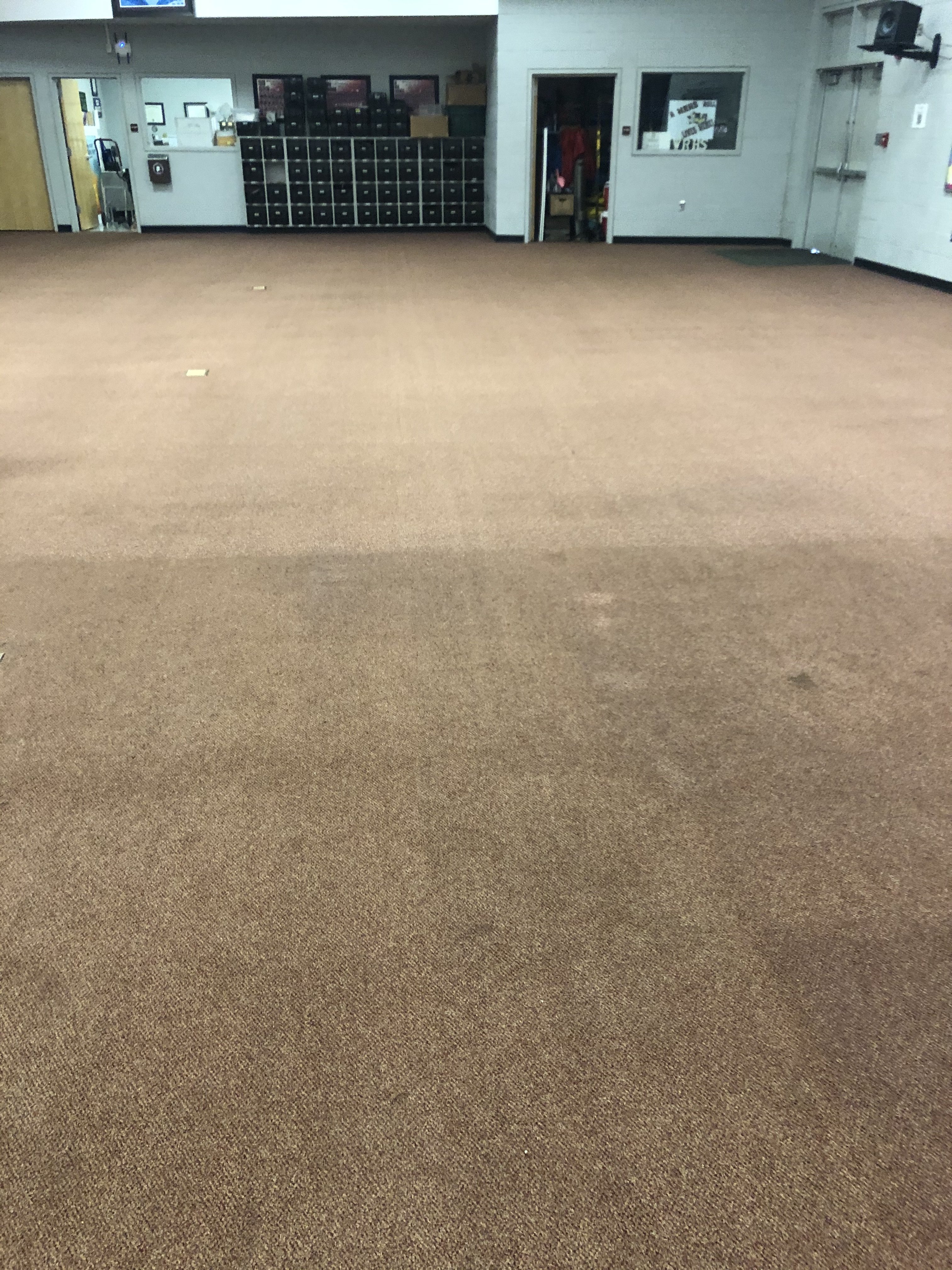

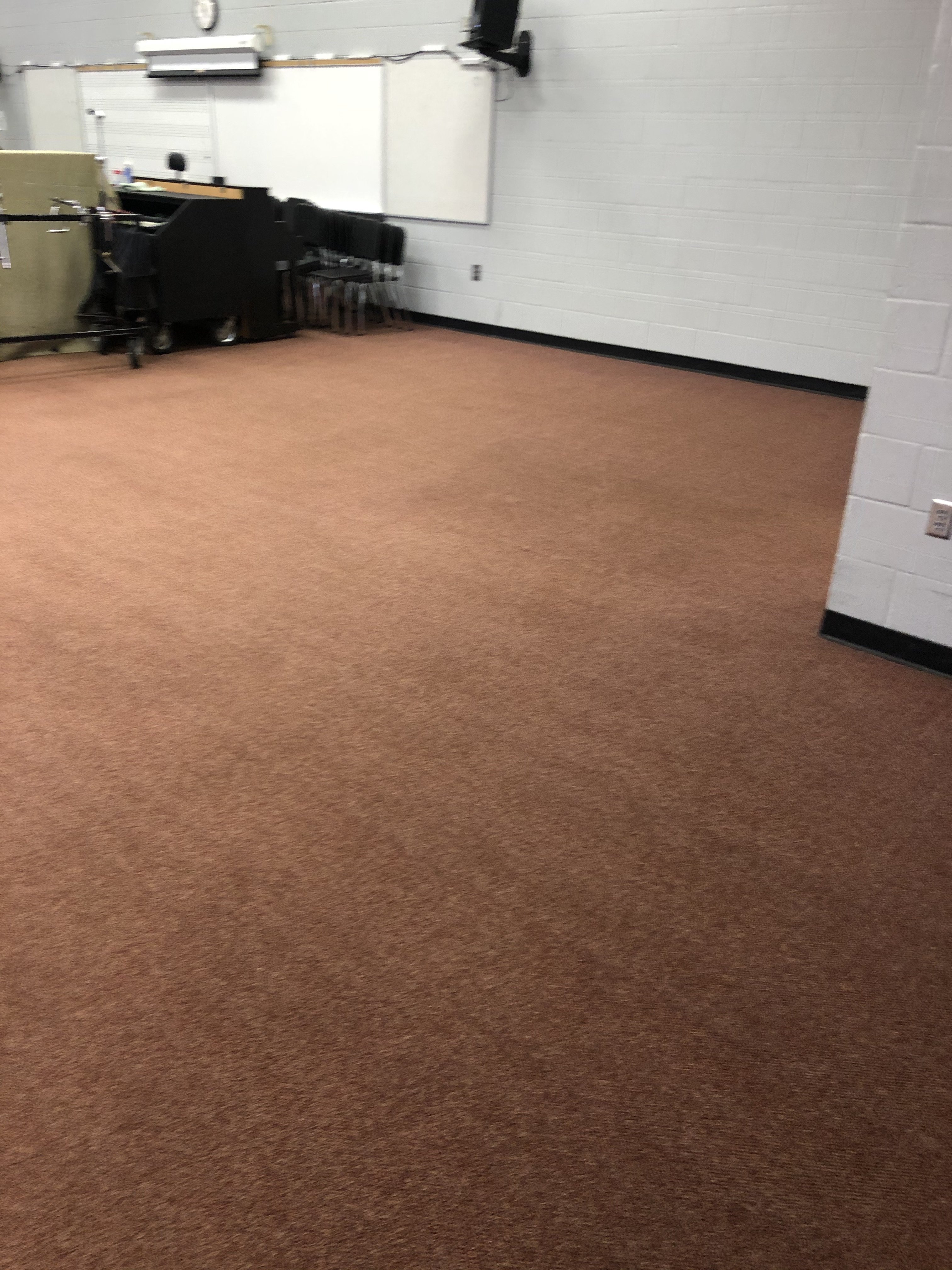

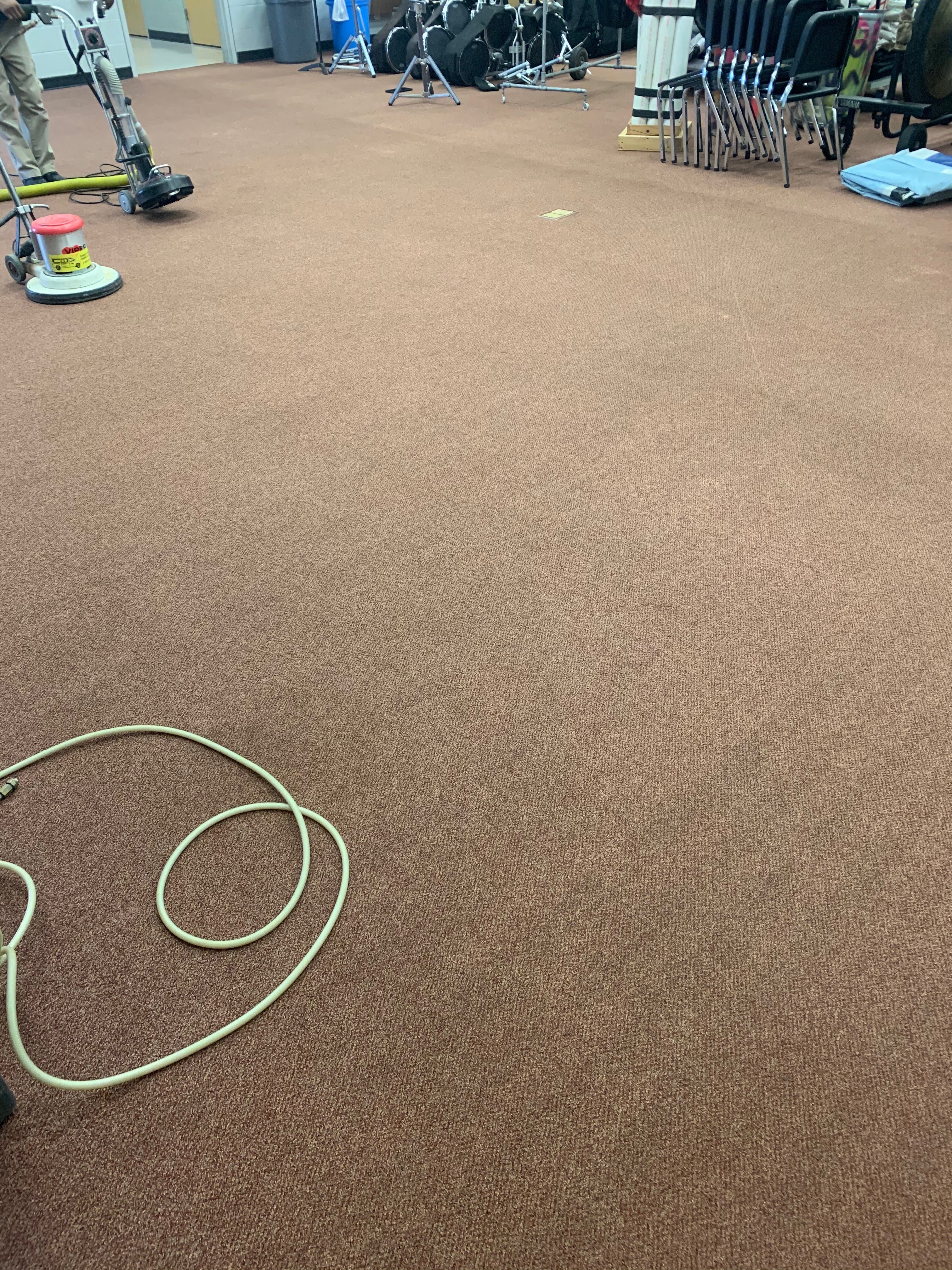

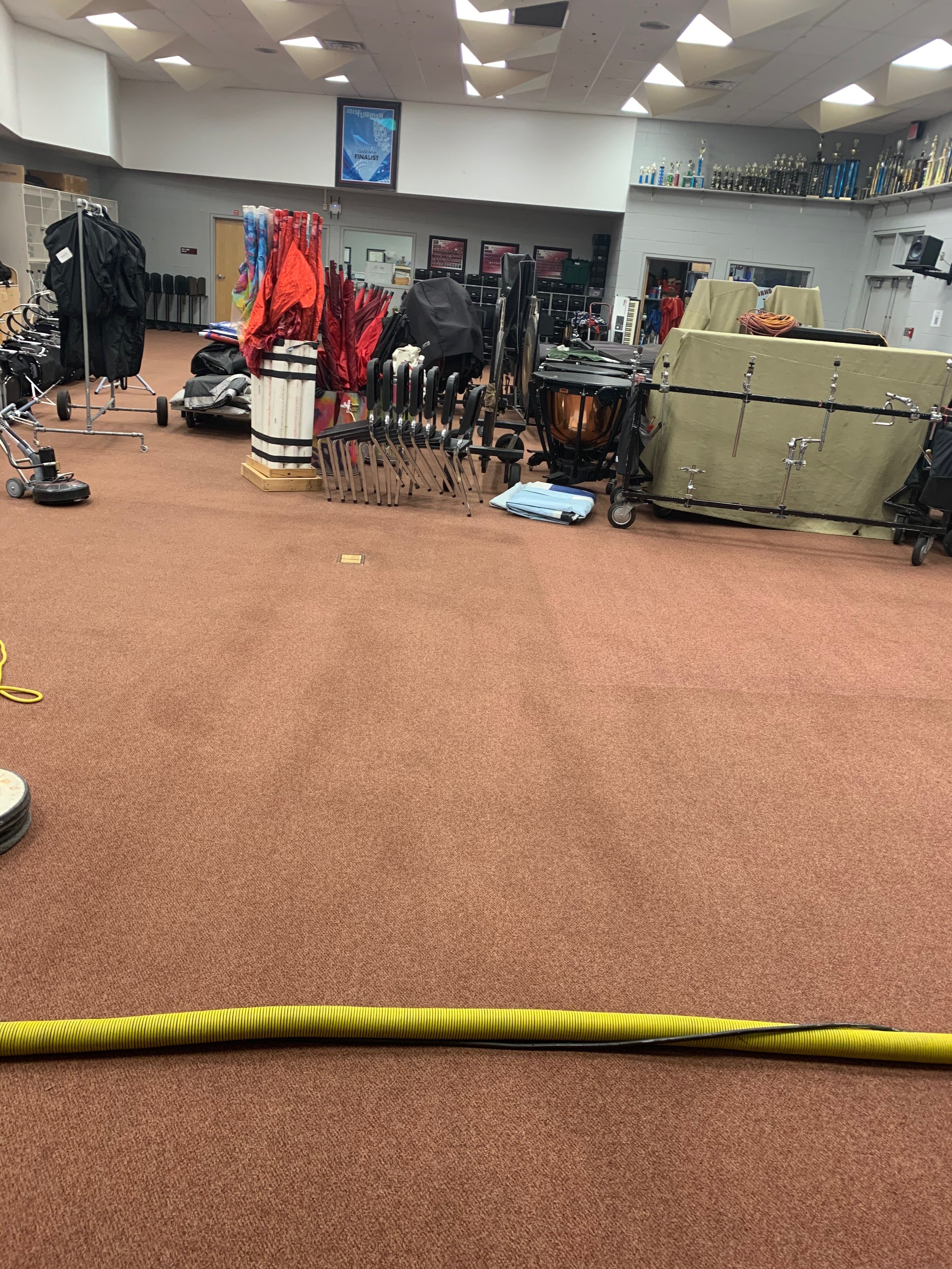

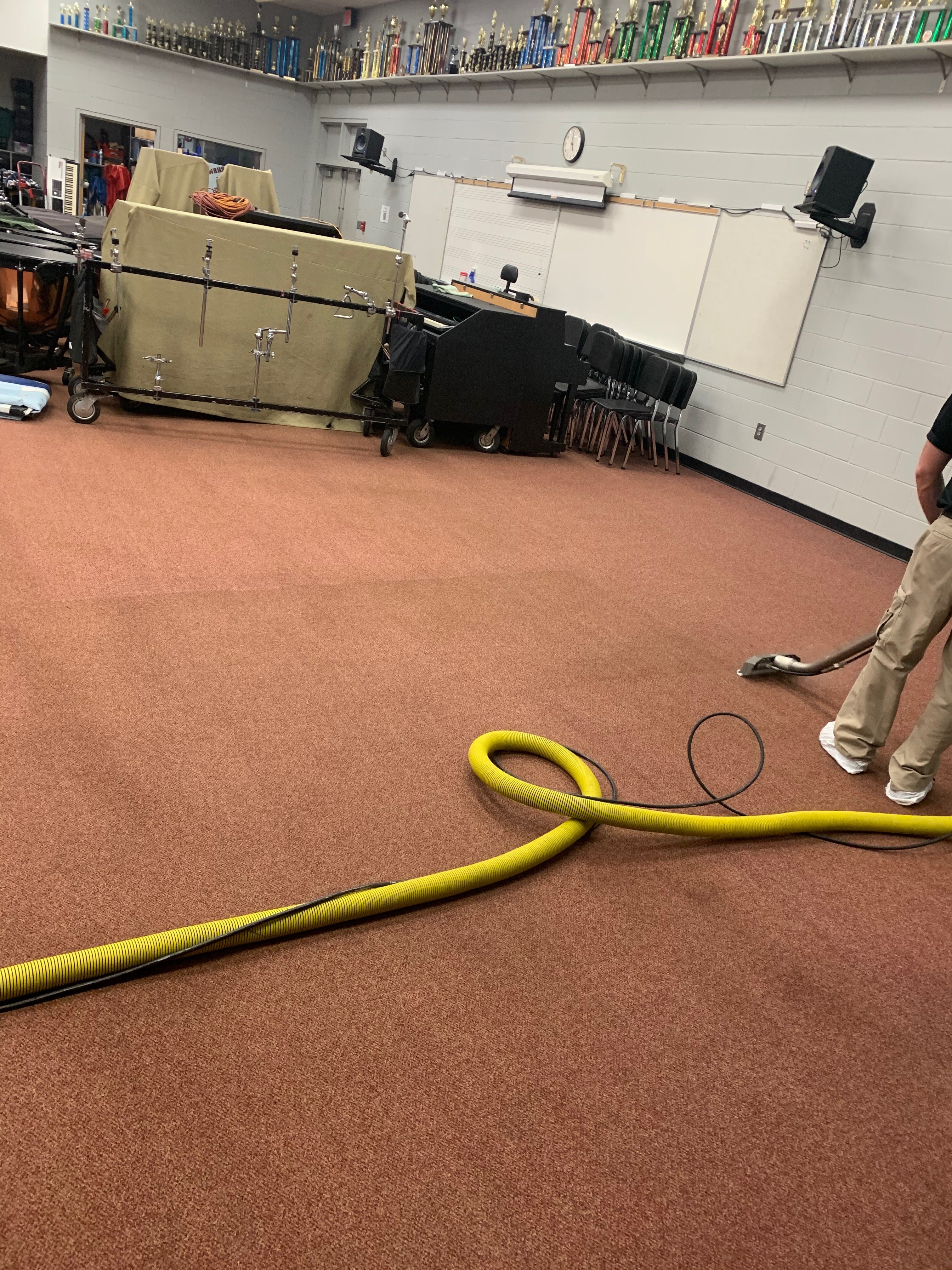

I had a crew do a job today. A school to be exact. And in one of the room the maintenance department previously used Host GVX and Host SJ on half the room. The crew used out strongest Butyl Commercial Pre-Spray, scrubbed with a CRB and extracted at 600 PSI with devastators and couldn't get the 2 half's close to matching. Our half didn't look nearly as clean and/or light as the half the maintenance department had done. We're going back later this week to encap. it to hopefully get it more uniform. I have a couple questions hopefully somebody can help answering.
