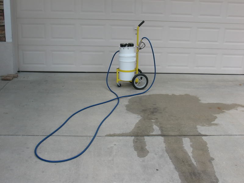

Does anyone know the gpm for some of the electric sprayers out there?

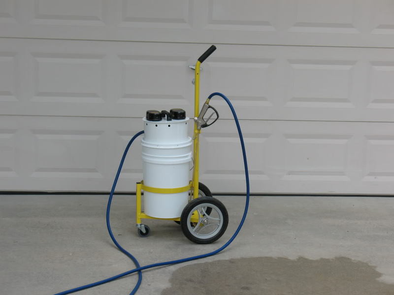

This is the sprayer that I am working now. I have used it for some outdoor applications that we do, but will be testing next week indoors for carpet. It gives out 1 gpm.
The top part sits on top of the bucket (3-7 gal). So you can mix up different solutions and keep them in their own buckets. It has a 25 ft hose.

The electric and 12vt sparyers we use and have used all have the standard Flowjet by-pass pump (50? 60psi??)
I've bucket tested both.
The one with the worn out, 10 year old, unidentifiable numbered, brass jet puts out about a GPM.
The newer one with an 06 flow jet spits a gal in a minute and 15 seconds if I recall right
I'm not positive, but "think" those pumps are rated at 1.2 GPM
with the set up you're using, bet it would be a cinch to drop in one of those 2+ GPM ag sprayer Flojet pumps.
I've seen them at the farm supply store.
That should put down more juice than a hydrosoaker

2 - 18 volt dewalts.
That is my favorite part of the sprayer. You get a lot of usage and you can keep 2 spares with you at all times.
We plan to use this on big commercial jobs where prespray is necessary for portables or CRB machines for encap. We can place 5 gal pals along the halls for easy refill and keep trucking on.

It is a 12 volt shurflow pump. The 18 volts drop down to 14 volts pretty quickly to a steady flow to the pump. I am not a pump or electrical expert.
We use the sprayer when cleaning and sealing pavers outdoor. I never pushed the issue until I was trying to set up a very large commercial job that was going to need to be all presprayed.
I am going to put it to the test over next few weeks to see how it performs. I really like the battery setup, since that is what I have struggled with on my omni for a while. It probably puts out too much for protector, but will use a pump up for that.
If it works out, then we may see how we can make some more of them. The manufacturer of the cart just went out of business, so we are trying to find another one now.
