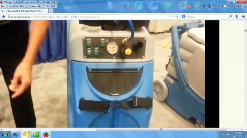

I bought the EDIC Galaxy 2000CX-HR back in mid September. It is the model with 2-3Stage vacs, 500psi adjustable pump - All running on one cord. Same one JZ is talking about I believe. I use it every day on every one of my jobs. I'm not a TML. :stir:
I'm very happy with it. Lots of suction. Previously I had been using an older model EDIC extractor. This one is more powerful, only uses one cord - I love it. The ONLY thing that I'm not in love with is that it seems to be a tad bit more front heavy, making it a tad bit harder to pull up stairs if you need to do that. Probably has something to do with the configuration inside the body.
I specifically wanted the one cord model. When you need 2 cords to run the pump and 2 vacs and then add a 3rd in for a heater, well most of the time something gets left not plugged in. As far as having a problem running the pump and both vacs on 1 cord and blowing breakers, that hasn't been much of a problem at all. I was told the total amperage would be around 18 amps or less, using the 2 vacs and the pump at 500 psi -which I never do unless I'm cleaning tile.
18 amps you say? When most home circuits are 15 amps? It just has not been a problem. In 2.5 months I've flipped breakers 3-4 times. And that only usually happens because the house is wired funny and the outlet I might be using in the back of the house is incorrectly wired to the outlet in the front where the machine is plugged in. I do not recall a single time the machine by itself has caused a breaker to blow.
All EDIC extractors do not have a heater inside the machine. (The HR in the model number stands for 'heat ready') They will sell you a EDIC inline heater which will hang on the back of the extractor, which uses a 3rd cord. I already had a MYTEE inline heater which is what I use when I need heat.
I bought the machine thru Padre Janitorial Supply in San Diego. Sorry I don't have their number handy as I type this. You can't buy direct from EDIC. I paid around $1800. I went and picked it up directly from EDIC as they are only about an hour away from me and I need it immediately rather than waiting a few days for it to be shipped. The people at EDIC were very helpful and friendly. Thanks Rick Hernandez!
Hopefully this will answer any of the questions you guys were wondering about! Happy Thanksgiving everyone!!!:winky:

It looks to have some interesting design features, but one of the first things I want to know in looking at any porty, is what components are they using? Before considering any porty, you should familiarize yourself with the most popular brands and models of vac motors and pumps being used across the industry..
Exactly what vacs are they using?
Exactly what pump are they using?
The fact that they offer a dual 3 stage vac, 500 psi unit that draws ONLY 17.1 amps, makes me even more curious about what they are using in it. 1.5" vac ports worry me further.
As a comparison, my beastly M-5 uses dual high performance 3 stage Ametek vac motors (144” of water lift and 230 CFM) that draw around 12 amps EACH....so thats 24 amps for vacs alone, plus 4 amps for the 500 psi adj Pumptec pump puts me at almost 30 amps. In fact almost all the 3-stage vac motors I have looked at as possible replacements have been between 10-13 amps, so again, what are they using?
One thing I do not like to see in the vacuum specifications of any machine, which seems to be the case here, is ONLY the cfm, or ONLY the lift numbers. This leads me to believe that they vac motors being used are weak in either one or the other, as opposed to having the right balance of the two, which you will find in the most popular quality motors being offered, and considered a key in efficient water recovery. This imbalance could explain for the lack of amp requirements.
When considering a particular truckmount, you want to know what the motor/pump/blower, but with a porty its mainly just the pump and the vac motors, so before I look any further, I want to know what is at the heart of any machine.

Also you need to look at cooling in the motor cavity. If there's no cool air available to the motor compartment, I know for a fact that the motors will fail prematurely. 17.5 amps seems pretty low for 2 vac motors and a pump.

Goomer,
Excellent questions, thank you.
The Galaxy 2000CX-HR (available in 17 gallon as a 2700CX-HR) has a set of standard performance three stage vacuums. These vacuums offer plenty of power with a conservative amp draw.
We offer several Galaxy sub-models with configurations designed to fit the unique needs of different operators.
We do have a more powerful and specialized version of the CX-HR available which has the same amp draw as your M5. The model I refer to is the 2000FX-HR (available in 17 gal as the 2700FX-HR). That unit has the same pump as the CX-HR but offers high performance three stage vacuums. This then requires an additional cord to power the machine. That makes two cords for the machine and one cord for the heater. Each cord requires it's own 15 amp circuit.
It's a great unit and it's very popular but we understand that not everyone has that much power available to them.
As far as what motors we use? We use Ametek and Electro motor in different applications and have taken advantage of the advancing technologies and increased performance both companies have offered over the years.
Because these particular units are run in series, we designate the water lift as the primary, and more accurate, unit of measure. Had they been run in parallel, we would have designated the CFM as the primary unit of measure. I will try to get the Air watt measurement of two motors when I return from the holiday. Air watts should give you a better idea of the performance a motor offers because it factors both CFM and water lift at the working end of a hose.
Thanks again for the great questions.
Hope you all had a great Holiday!

You're welcome.
We offer several brands, across different sub-models, that, based on our experience, offer the best longevity and performance in their particular range.
For this 500psi Galaxy unit, we use a PumpTec head mated to an ametek motor.
