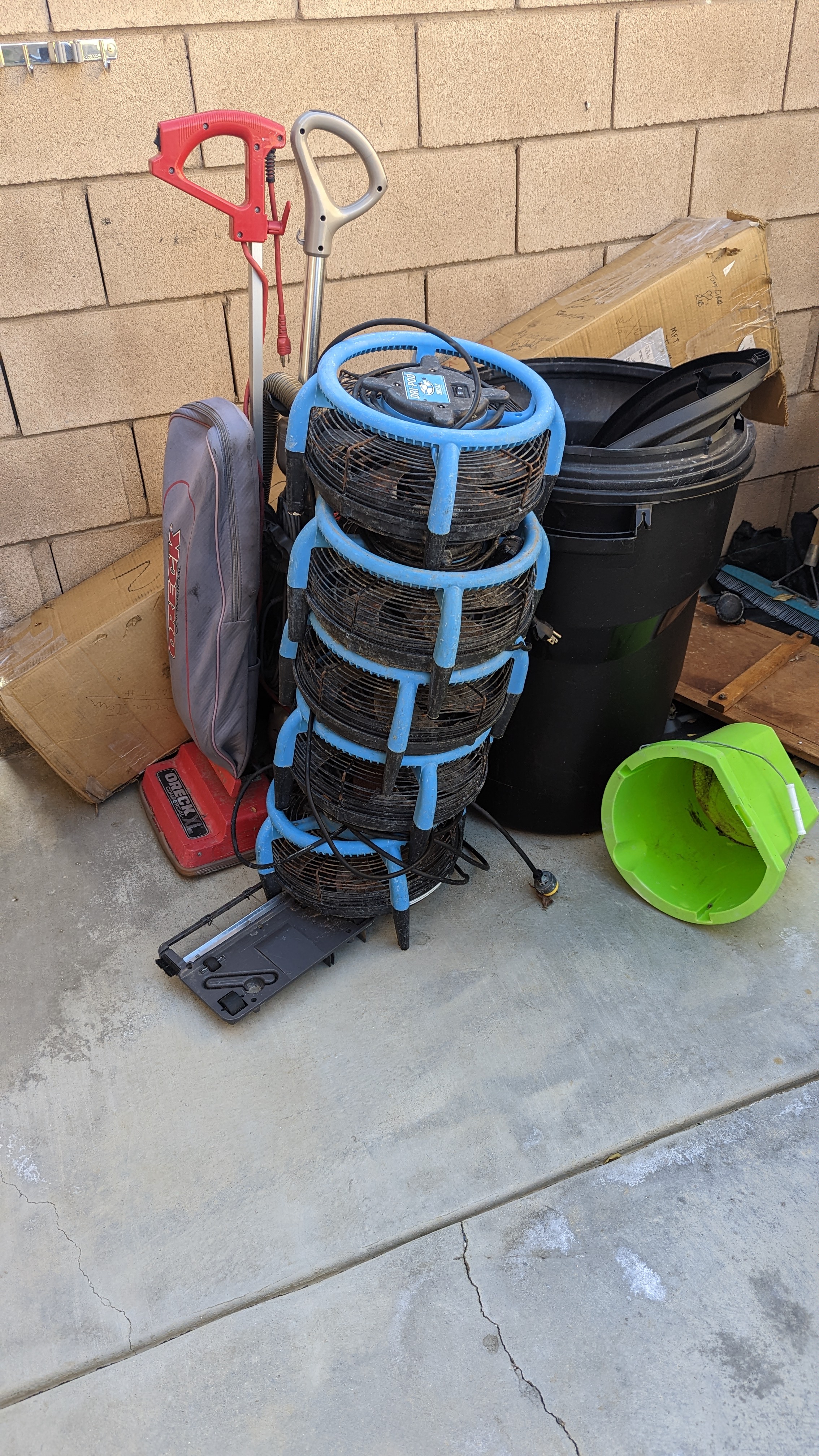

Snapped a leg off a Dri-Pod a year ago. Fixed with epoxy, which worked well until a few days ago when I hit an unseen speed bump that launched all the fans in the back of the truck. All survived except the one I epoxied :(
Spoke with my distributor who said parts are not sold for the fans. Can this really be true?? I need the bottom diffuser with the 4 legs. The rest of the fan is in great shape.

It’s the new bolted together model. Why go from rivets to bolts and screws if you still can’t replace a broken part. Easier to build? Perhaps. It still seems stupid to not be able to purchase a part as opposed to a new fan.

Thank you. I’ve epoxied the parts back together. I’ll look up German glue for future use.
As to Mikes comment that the fans might cost 350.00 if a handful of parts were available, I say pishposh. I believe it’s environmentally unsound on the part of Dri-Eaz to have to trash metal, electronics and plastic of an otherwise perfect fan for the sake of a simple plastic leg, whether a fan costs 119 or 350 dollars. Basic parts should be available for repairs.

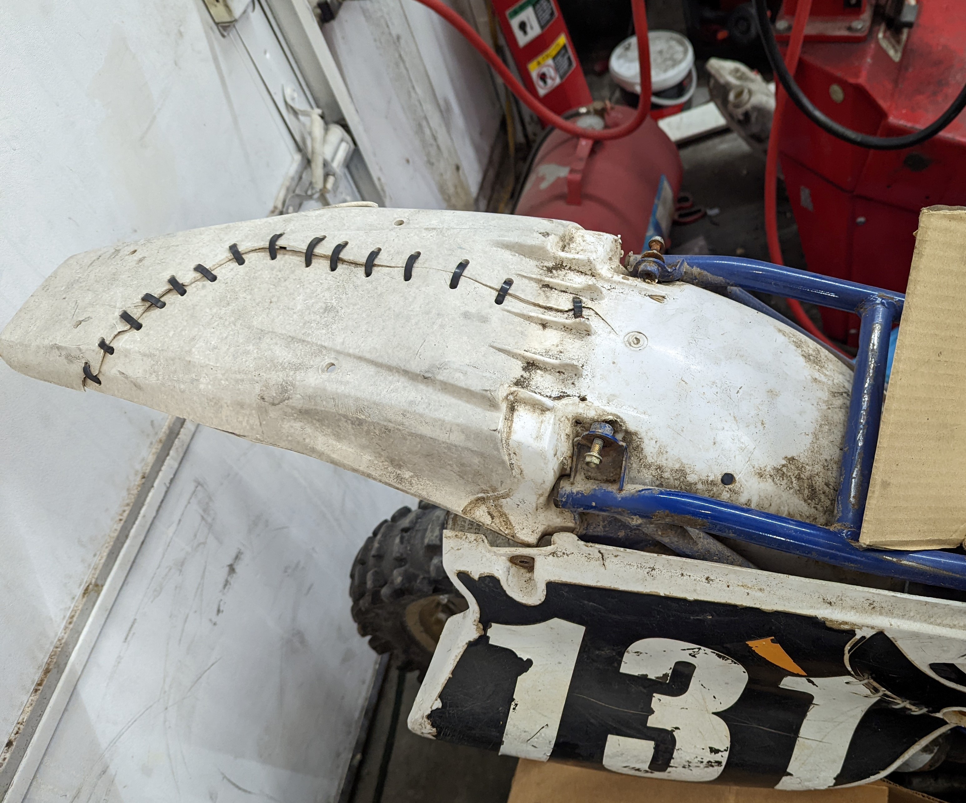

Have some fun with it. Use one of these.

My friend has one of these.. Works well for a lot of things.. You can get the cheaper ones.. It uses staples that heat up and you melt it into the plastic to repair it.. So far it's holding a bumper on a car, a proteam vacuum head, and a few other bits I've tried it on..

can confirm....used one to put the rear bumper assembly of my kid's car back together
