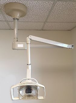

It would have hi-power UV lights like a dentist uses, mounted on a movable track.
When necessary, you could push the light up or pull it down to examine the rug closer.

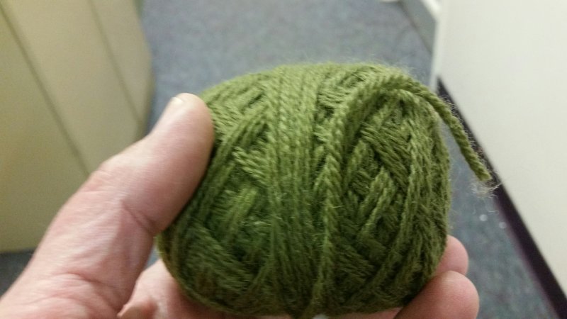

Brian H
You may want to make sure that your lights have a high CRI (Color Rendering Index). Our repair area has florescent lights that have a 90 value, while the general office lights have a 70 value. The higher the number, the closer to true daylight it actually is.
We have a spool of yarn that we use as a demonstration of the lighting. In our office area, the yarn is a plain brown. In the repair area, it is a khaki green. It had caused us issues in the past before we got the 90 value lights. The yarns used for repairs looked great in our shop but looked terrible when viewed at the customer's home.

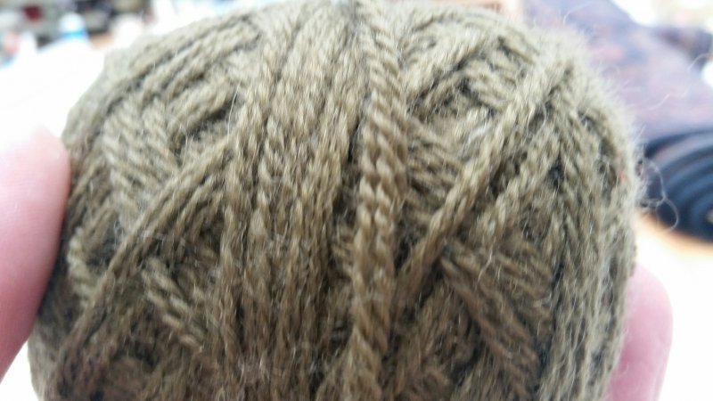

Brian H
Here's an example of lighting...
Same spool of yarn, same camera (actually my phone) and same settings on the phone. The first picture was taken in our repair room, the 2nd in our office. The funny thing is the camera changed the color too. In the repair area the first picture was brown. In the office it was closer to the 1st picture in color.
