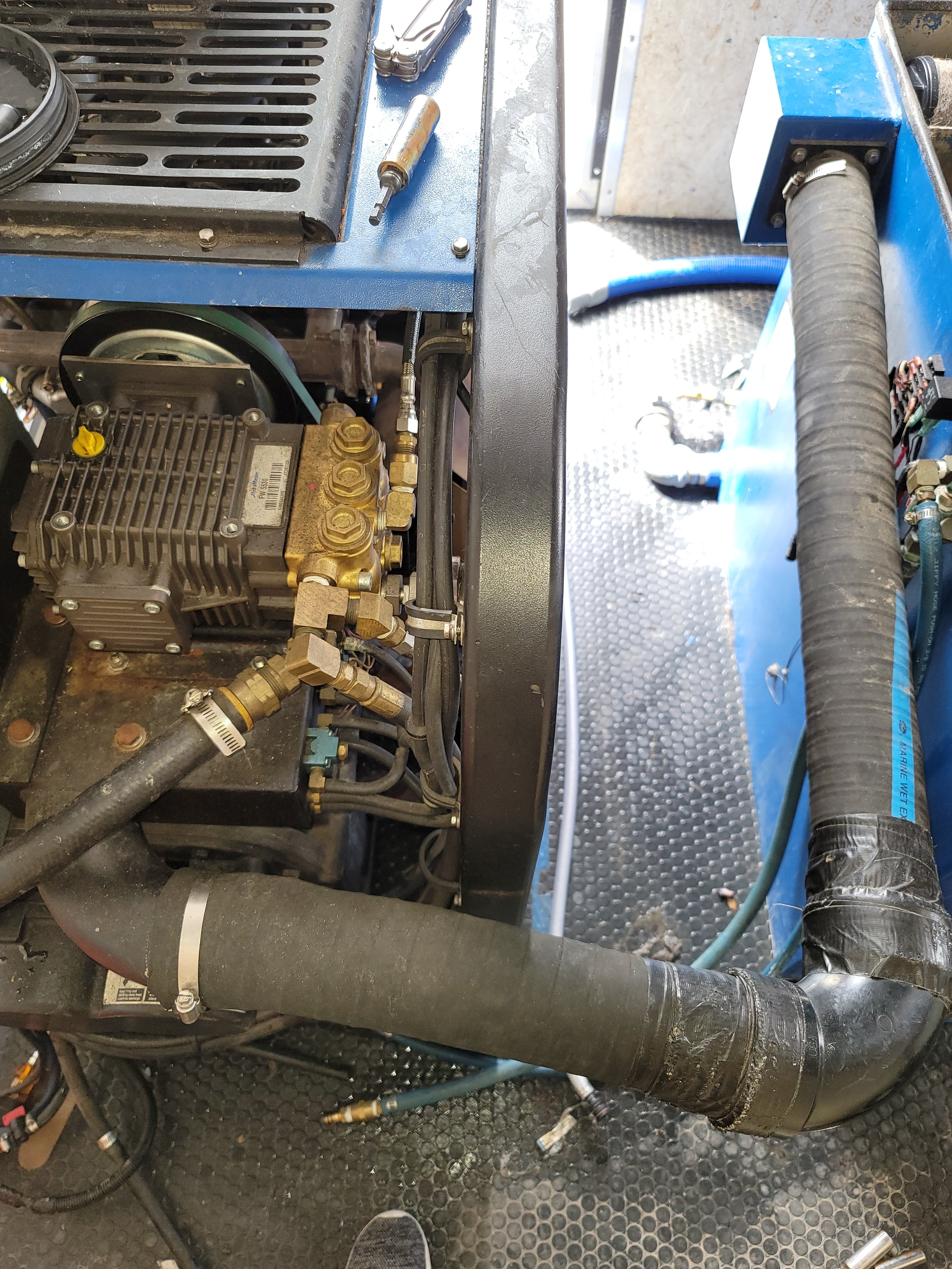

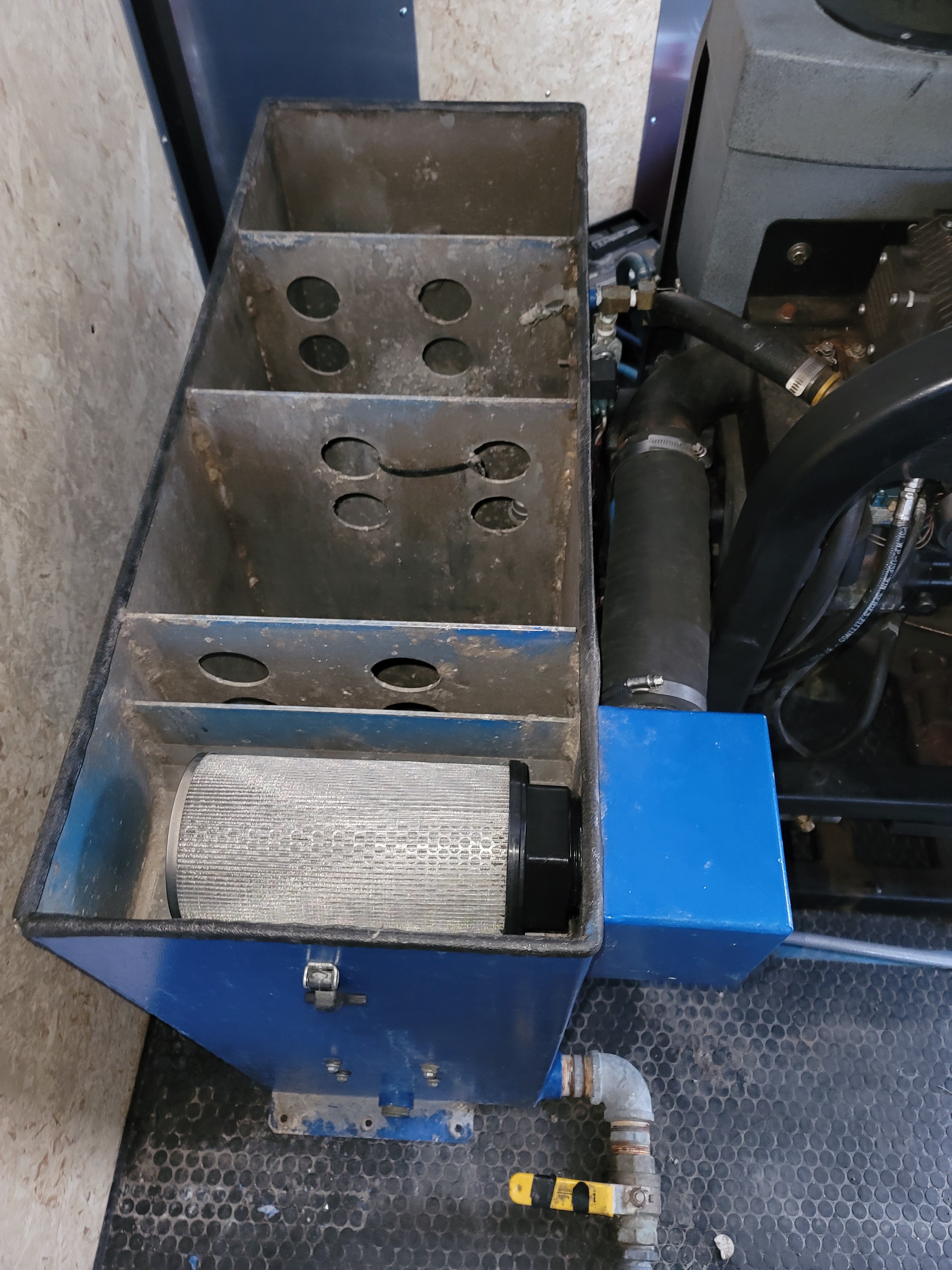

I made a few adjustments today. I shortened up this hose that went to my blower and took out the elbow and moved the waste tank. What do you think?

Looks much cleaner. Any concerns with heat? I just wonder if the closer position will block airflow.???
That actually crossed my mind but I don't think it will be an issue. It's in my trailer so I usually have the side and rear open with lots of air. I'll take a better picture tomorrow showing how I have it laid out. I would have taken one today but I had everything tore apart and it looked like a junk yard in there and I knew everyone would ridicule the shit out of me for it looking like a shit hole.

The heat if a factor can offset with
High heat insulation an or maybe a cooling fan mounted on roof of van?
But regardless nice job ,the elbow gone helps fer sure ...
Good luck feedback in a week or two...
