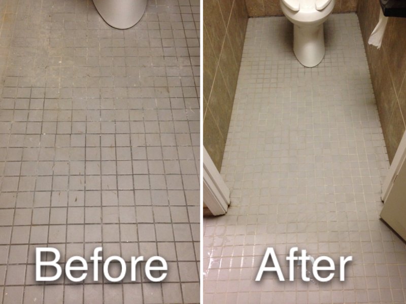

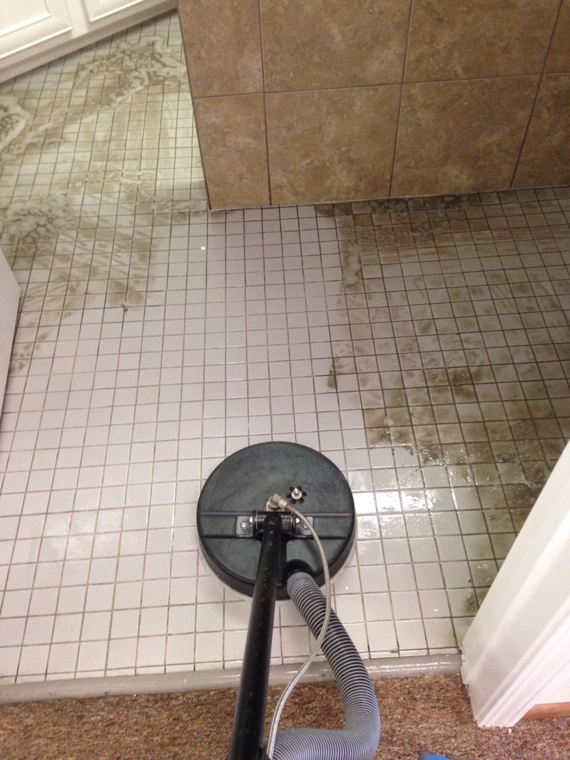

Looks great, Ross. This pic was CRB only? Being the hack that I am, I have to ask:
Is the spinner necessary after this?
Every job.
No such thing as a perfectly level floor, if you don't agitate you will get pooling and uneven coverage. Nothing worse than spinning and seeing that 6 inches of grout line you missed pre-spraying.
CRB usually more than good enough.

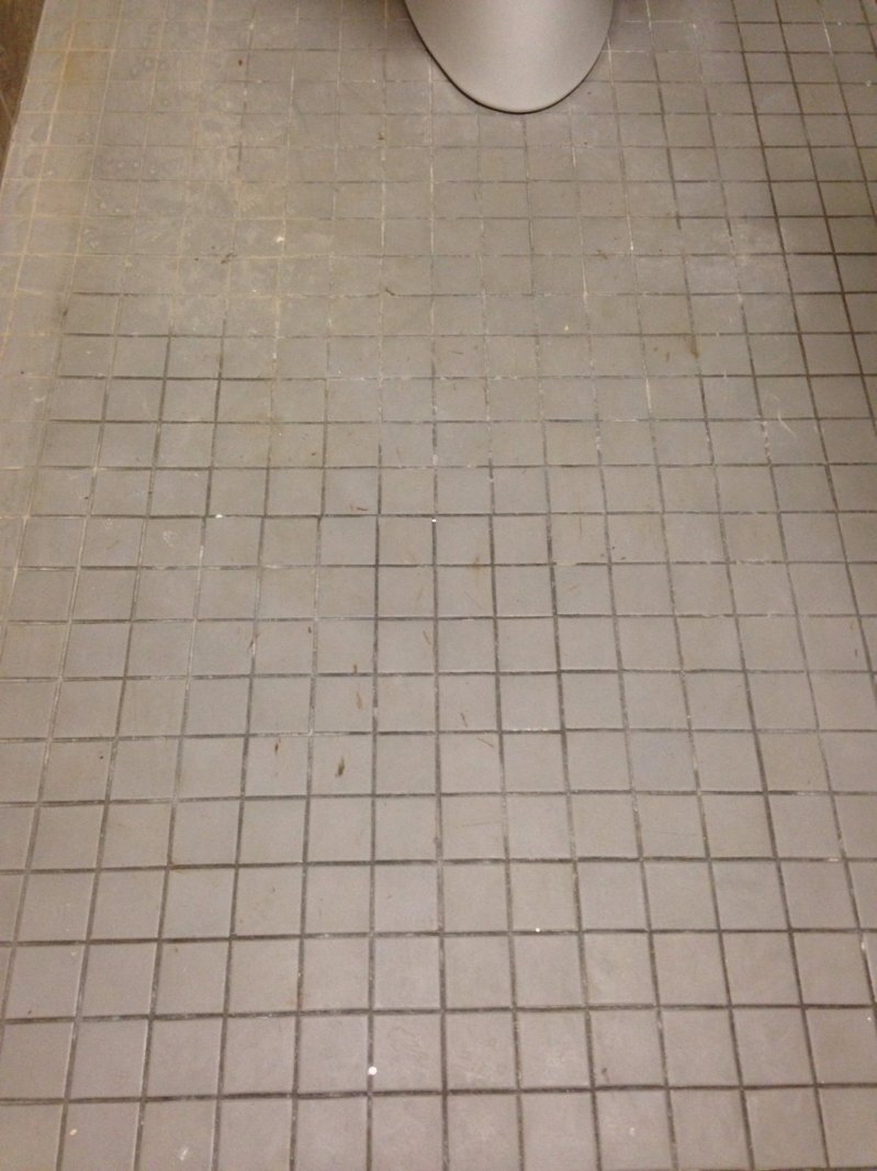

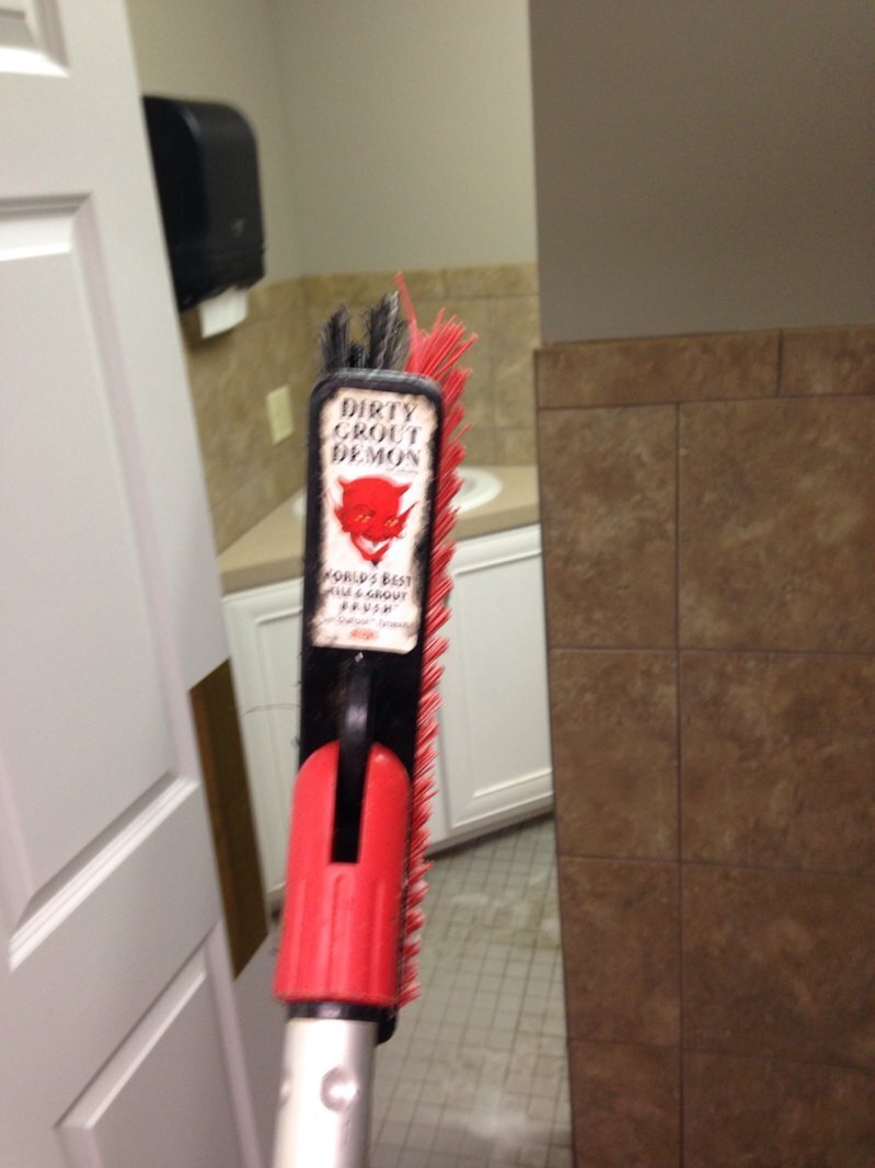

Brent Norman

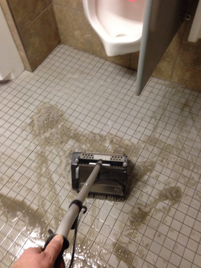

30 year old plus tile grout never cleaned professionally. Used "snake oil". Prespray dwell and set up. Tried using tile spinner alone. Oh I mixed it on the strong side too. Wasn't happy at the results. So redid it. This time scrubbed with crb and shark tool. It did clean up really good. But it needed scrubbing. Most of my tile jobs do. I used to use the 360i tile head which is a brush and does a good job because you're scrubbing as you're cleaning. But the crb/tile spinner is still faster and does a great job. I did just order a new cleaning chem to replace my snake oil. I think it'll be better we shall see. But I'm planning on still pre scrubbing my tile and grout.
Hey Damon, thanks for your comment.
To answer the point of your question, no. But it is the easier most efficient way to extract.
You could used a glided wand, brush wand or I guess a mop and bucket. But a spinner is the way to go.

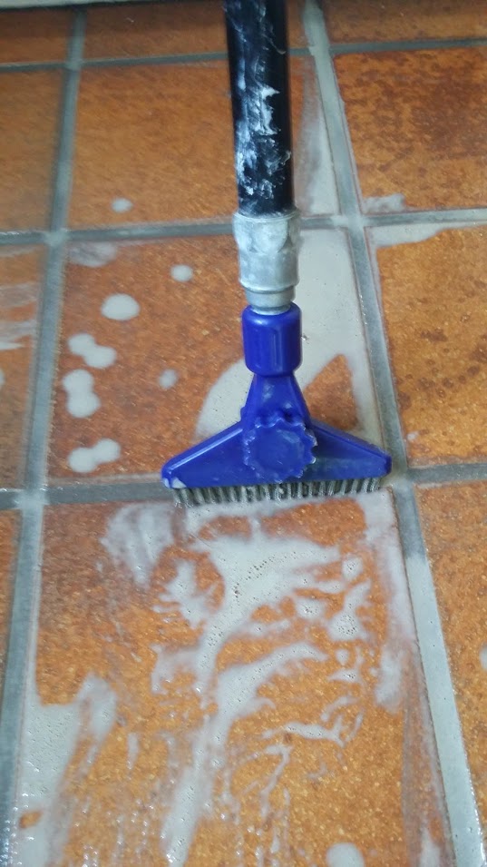

Does it tend to leave smudge marks on the grout? I've had stainless brushes do that, so I stick to nylon.
117,317
Not on the grout, like the cheapie toof brushes can.
But...
Beware on most stone and plenty of ceramics and even porcelain.
Always test.

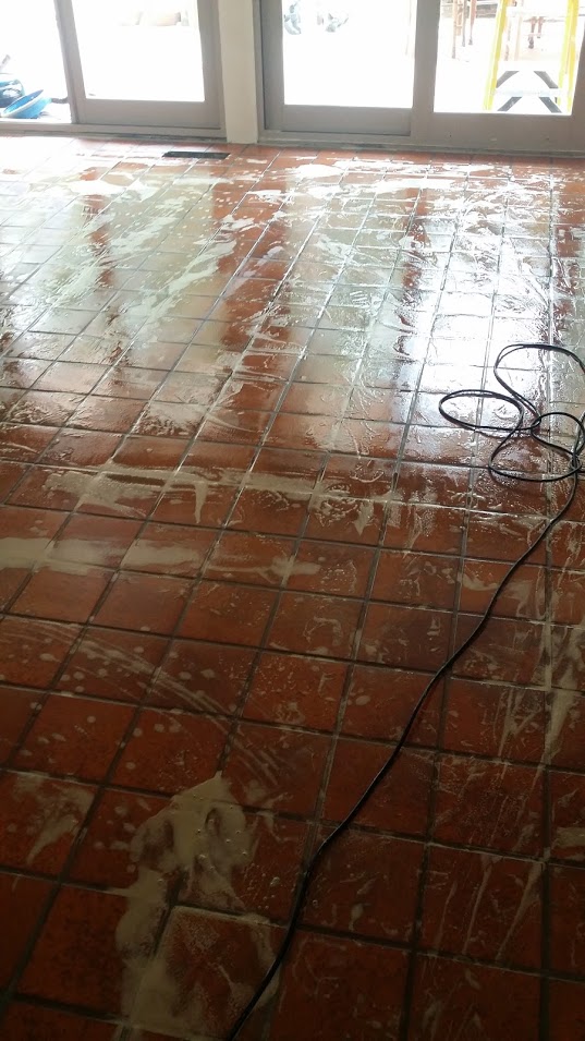

Terracotta and the natural place where its installed, is where this brush is a must.

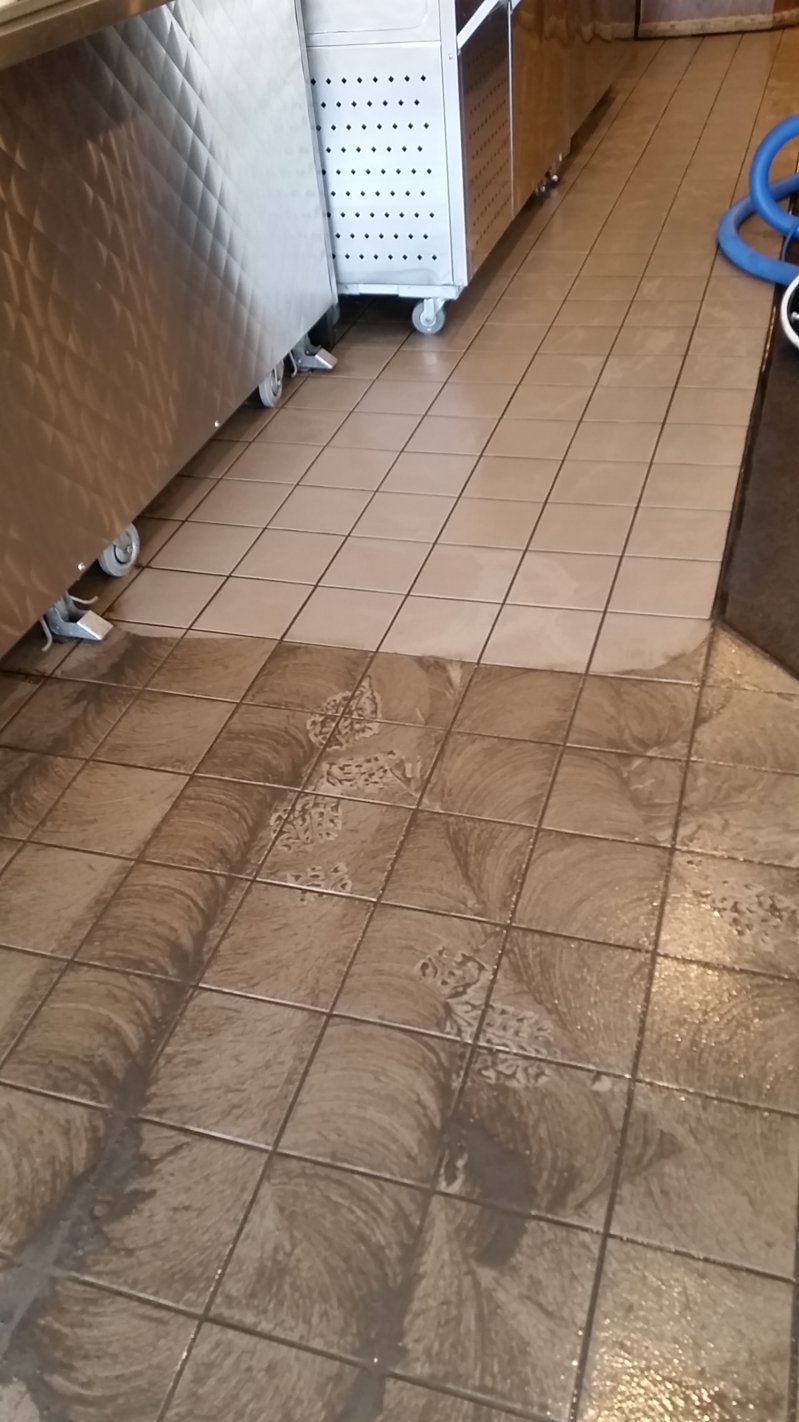

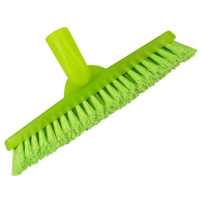

1,5oo pounds shared between 2 jets really pushing the envelope. I cleaned a sh.. load of food chains with 1,300 pounds and 250 degrees. Telling you for fact if u slow down or stay in one spot just 1 second to long you can get perminant swirls even on glaze fired tiles.
Is 1000+ to high for residential? I sure as hell don't need it. Not even close. Do my detergents always pop the grout soil, hell no. Kitchens need a wee bit of help and pantries. Doesn't take much brushing action either. Unger (sp?) window washing equipment has a green swivel grout brush for under $10. Use to be at Home Depot for $8, now on Amazon. These $20+ brushes at our suppliers are beyond my comprehension.

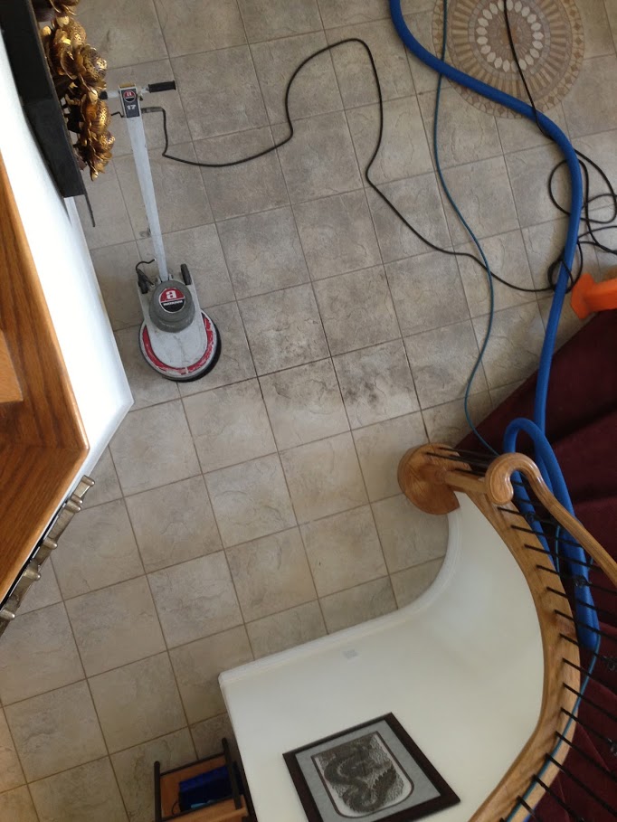

Can anyone shine any light into using the brush pro with the stiff bristles for scrubbing tile and grout? How does it compare to running a smaller 15" floor machine with tile brush head?

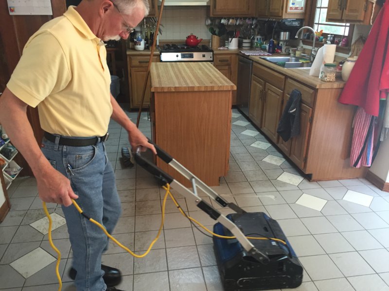

We do this. Oh that is the customer trying it out, hahaha! Great guy and a friend. Notice the dirty tile beyond him.
