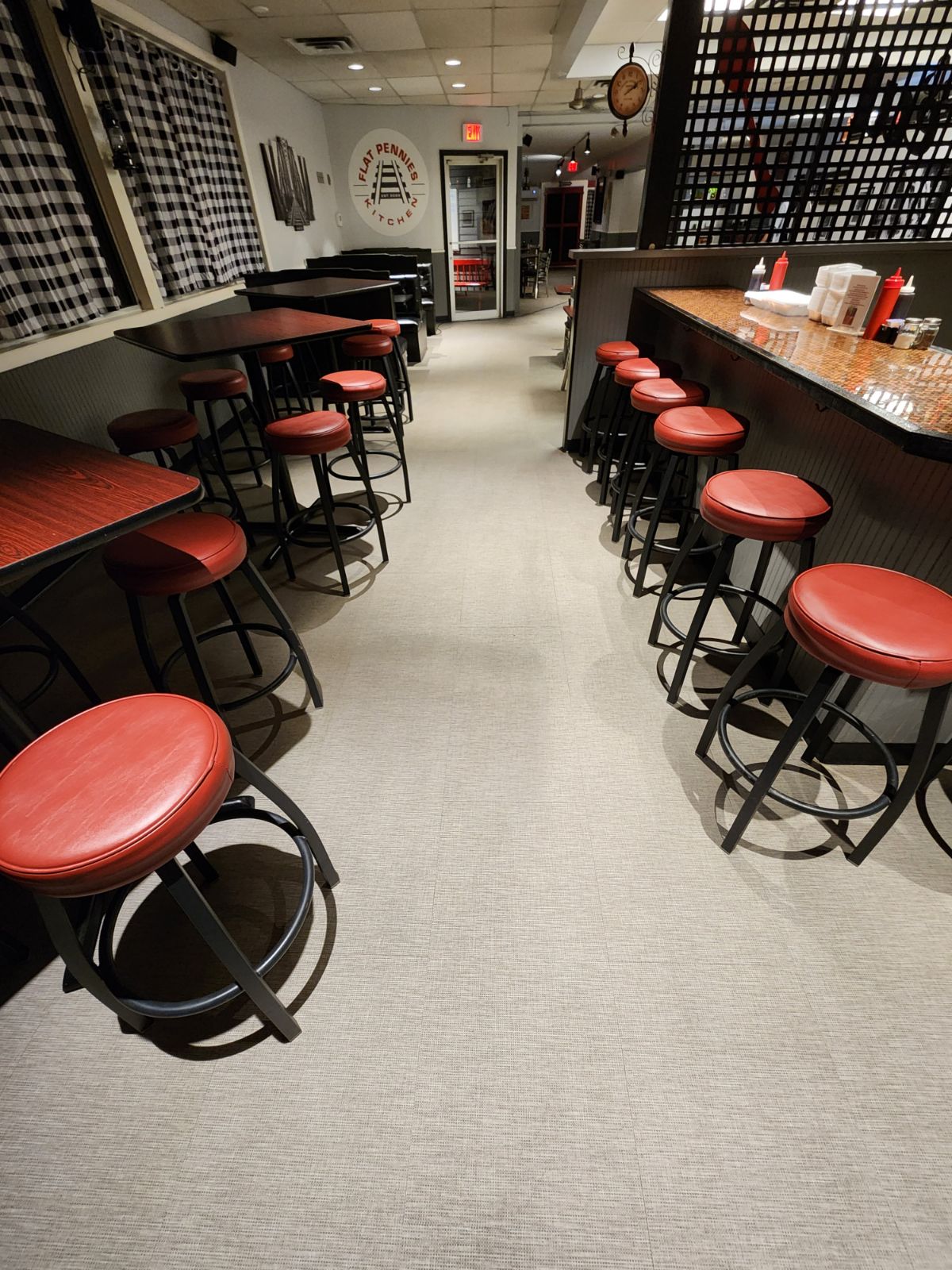

you certainly knocked it out man! lookin good in the after pic!
QUOTE="Bryce C, post: 4863938, member: 59322"]

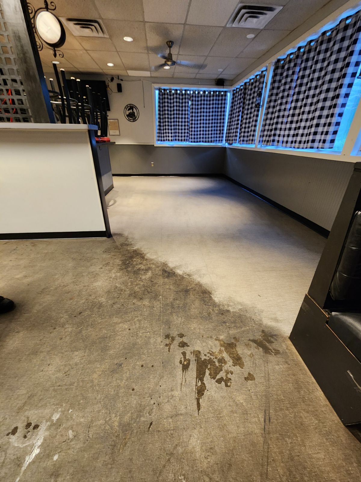

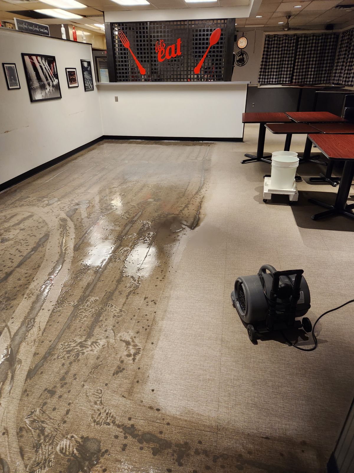

This place was disgusting. Didn't realize just how filthy it was until we got into it. A mentor of mine strongly encouraged me to stay away from dirty restaurants. Now I know why. We got stuck at this place way longer than expected. And didn't charge nearly enough for it. Such is life as a newb. But it's super local and we are friends with the owners so I figured we'd go for it. Good learning experience.
They have LVT floors which seems like a dumb choice for a greasy diner. I recommended afterwards that if he ever gets the floor replaced to go with synthetic carpet or tile and grout as they can be cleaned and maintained much more easily. We used Biobreak at 9.5 to 10pH, blue brushes on our crb, and 400 psi with Mike's hard surface wand. First pass looked unacceptably streaky with grease so we gave each section a final spray, scrub, and wet mop to level it out.
Spent 30 minutes cleaning the filth off of our hoses, cords, and everything after midnight to go back into residential the next morning.View attachment 127381View attachment 127382View attachment 127383
