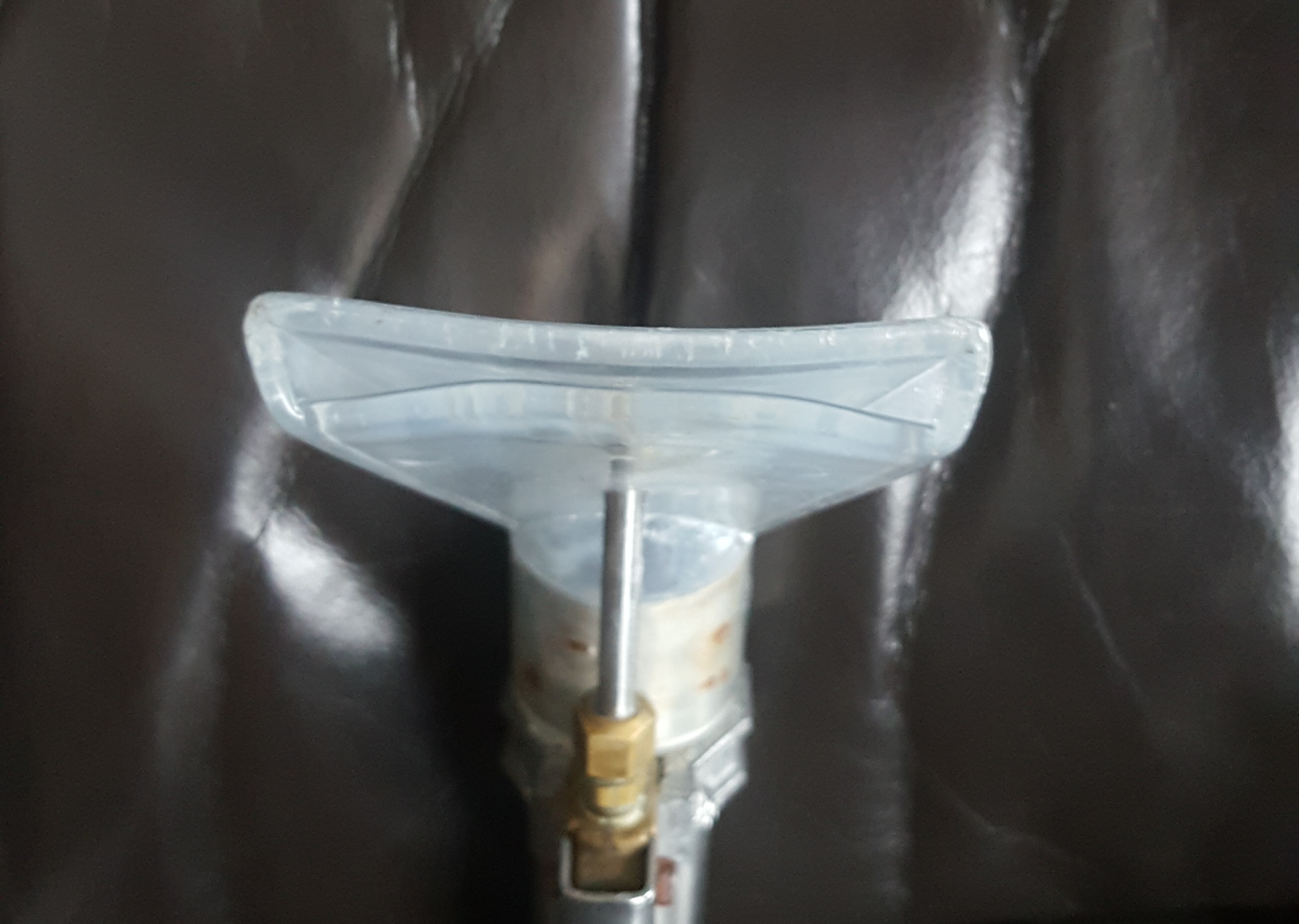

fuel burners and plastic tools. sigh..
Jan 4, 2016
549
Palmer, AK
Scott Turknett
Bob savage touched on it. There are different flow switches for different volumes to control on and off. It comes with a pressure washing high flow switch new because that is the industry the burner comes from and a carpet wand can just barely flow enough to make it go. But an upholstery tool doesn’t, so it actuates a safety and kills pressure. Get a lower flow “flow switch” in it.
