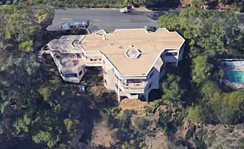

I could have used a swivel wand yesterday, owner was an architect so he designed his house in the shape of a Hexagon, very few 90 degree corners in the entire house, forced to do the clean corners either by hand or trying to maneuver the wand awkwardly, most corners were 60° & several nasty 30° here & there...added lots of extra time & aggravation to the job.

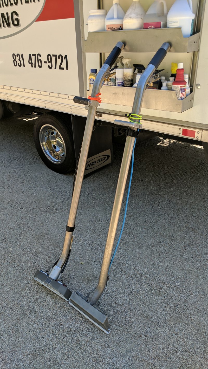

Don't buy a dang wand as they do have many non correctable issues.
They are a value at first but when they go south they have to be heavily modified and the customer service is just not there.
The Swivel sub mount being loose on the undersized wp tube is gonna stress those rivets and....pop.
How much rivet nip is in that tube?
