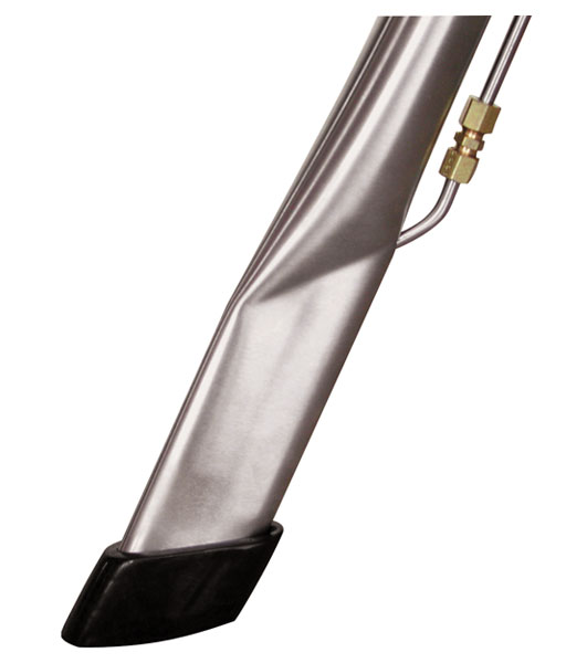

PMF called yesterday, they are sending me a new HS wand to test..
What I like:
12" head
Swivel
Narrow vacuum slot
Vacuum tube not blocked
Killer tufted brush ring
S bend
1.5 tube
Built in M'erica
Concerns:
Confused airflow due to internal jetting
Price
I don't want to be disparaging, though it's hard to say this without sounding like I do.
In my experience, PMF makes stuff that looks like it will work great but ultimately feels like it maybe had 3 total minutes of field testing.
-Swivel stair tool sold with single jet? Trash unless you modify.
-3.5" internal jet uph tool? Works really nicely but cleans about the center 2" at a time.
-Mach 12 Titanium? Great build quality and amazingly light, but many impracticalities.
-Don't get me started on this POS:
91602
Seems like the answer to all of your problems for tile & grout and filtration soil edging but spray pattern is SUPER uneven leading to issues, and yeah, maybe the valve can handle 1250 psi, but the dang thing won't physically trigger if you're over 500, so have fun running back and forth to the van 14 times every tile job.
Phew... again, I don't want to disparage anybody. I know we're mostly just good people trying to do our jobs. I hope they get this hard surface wand right. I will be first in line to buy one.

Bob look inside close and you'll see that the 11 inch long spray bar is now been cut in half, totally unobstructing the vacuum port

Which has a cavernous vacuum head in comparison to the pmf the only Tile tool that doesn't use the big wide opening dry floor tool design so I have my hopes..
Problem with the gekko tool is with the squeegee head, it locks down so you can't move it. With the brush head, it doesn't remove enough water. Hopefully the pmf is better. I don't have any problem with the internal jets. At 1000-1200 psi, it won't be a problem and it will help to contain the over spray. It would be nice to have an automatic vacuum relief if it locks down. I just don't know how easily serviceable those jets are.

Unhook the brass barrel nuts and the whole back plate comes right off and let you easily service it.. you nerds are way overthinking this
From what I see:
Unhook the nuts, back out screws (including on the brush frame), deal with loose brush frame and plate and manifolds, back out jets, clear jets, hope manifolds are clear, but everything is apart so no way to check, reverse process, get everything back together, get back to work...
...jet plugs again 5 seconds later.

I use the pmf upholstery tools often. North the 3.5 and the 4.5. you need to learn to balance the pressure and vacuum to get an even flow. I found I have to sometimes reposition the jet to get a proper flow. When you get it right, it's great. Same with the crevice tool.

This has the narrowest vacuum chamber of the all.
Narrow is best, narrow increases recovery.
When Conway and I tried to work with pmf to design a new HS wand, we thought having the jets in their own separate chamber would be best. Unfortunately that tool never came about.
Who knows, this could be good enough...
