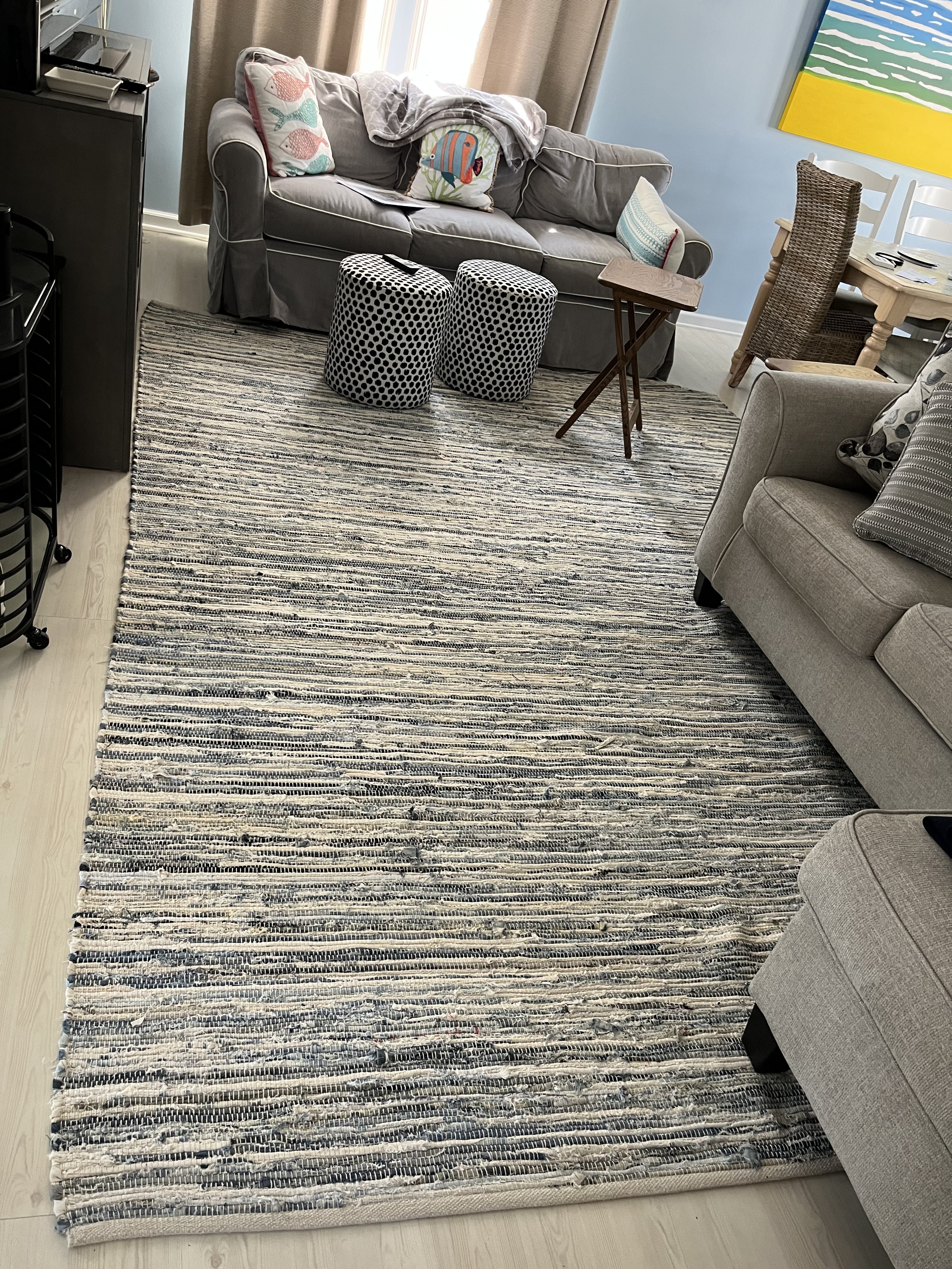

Got a pic of an area rug from a new potential customer.
Not used to doing this by picture, I usually like to see it in person, but incorporated this pic thing recently.
Would y0u schedule this for an in house cleaning? Im thinking $125, easy.
12,851
Browning is in your future if you HWE that with a wand
117,324
It would be highly entertaining if you cleaned THAT! with TOPSPOT...
This is one if those situations where 1.0 would say " if you have to ask, DON'T TOUCH IT"
3.0 says find a real rug shop and pay real close attention to the rug portion of our class in 2.5 weeks....

I turned down a large cotton area rug. I forget the designers name and didnt take a pic. (too busy taking pics of vac hoses,lol).
It is thin, but not paper thin, and was wondering if my Odyssey and Tops spot in my shop would be good? I didnt want to open up a can of worms in the house, end of long day, but I need to follow up and take care of this. I can get pics and info. Cleaning it with the glide in my shop HWE is the alternative. ?
Cleaning in shop HWE is best bet, after letting customer know the colors may bleed a little.

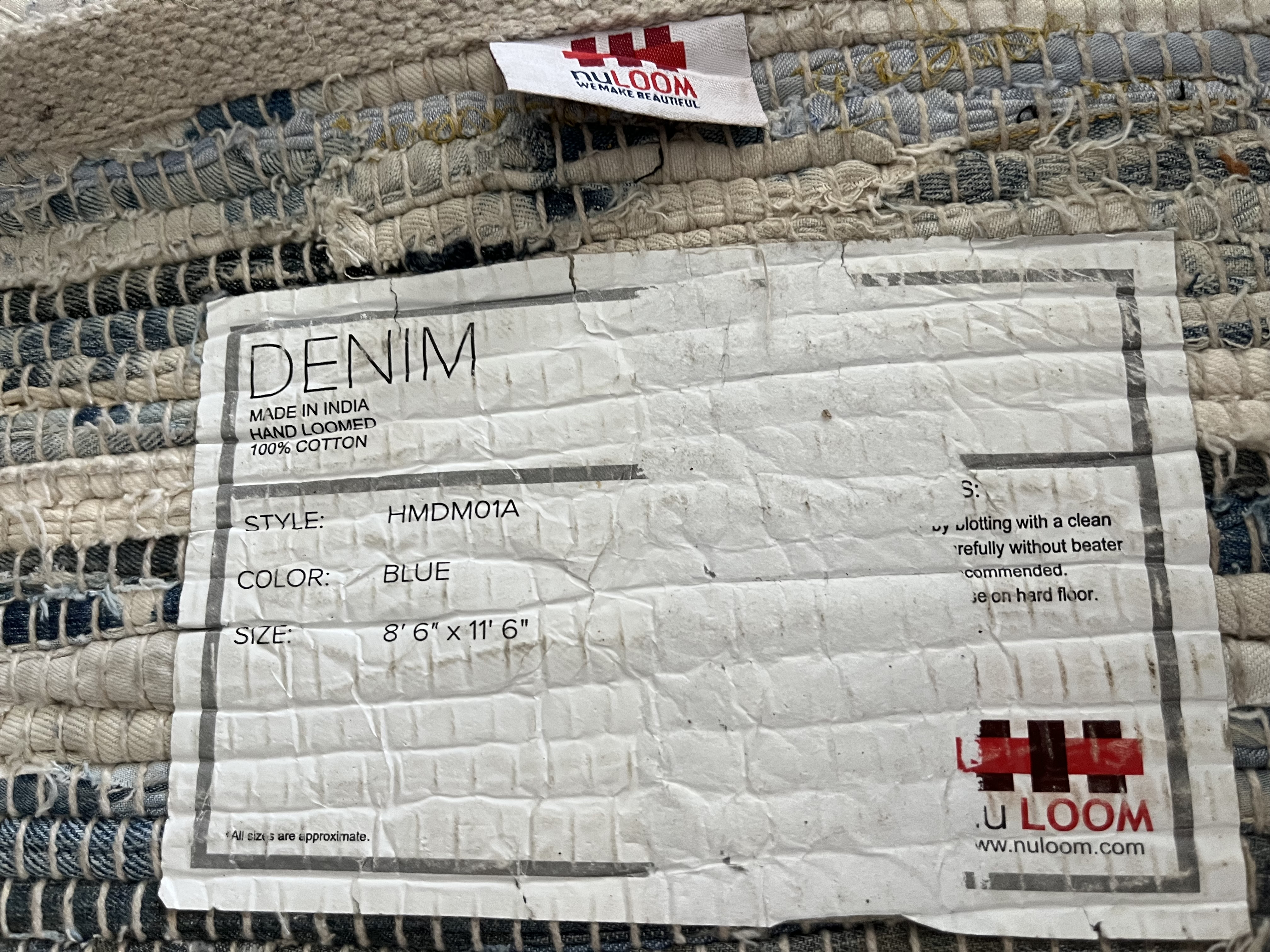

Denim on upholstery or rugs is not the smartest thing to purchase.. You can clean it, but I wouldn't attempt on-location..
It will get lighter and possibly move the darker colors to the lighter colors..
Reactions: KevinL and Mike J

I replied with the risks mentioned, recommended rug washer, and not on site. Told her for $125 I would give it a cleaning after October, probably in the winter if she didnt care and just wanted to try knowing the risks. Pick up and drop off. Easier than digging clams.
