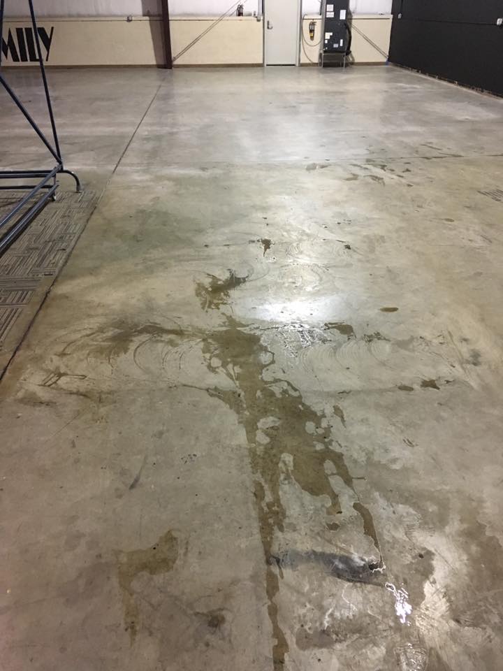

Just did a concrete cleaning job. Removed a LOT of dirt and the concrete brighten up.
But, I was not completely happy with the results. A lot of stains, etc were not completely removed.
This was a warehouse, not a greasy oil-stained garage.
Don't do much of this and not looking to buy new tools. Just want to improve results with my current setup.
What I did:
Pre-spray with tile cleaner with oxidizer.
Pre-sprayed grease, tape lines with de-greaser.
Scrub with 175 and Black scrub pad, dwell.
Tile spinner clean pass.
Final rinse tile spinner.
What can I change to improve results? Chems?
Thanks.
Back section cleaned, not final rinsed:

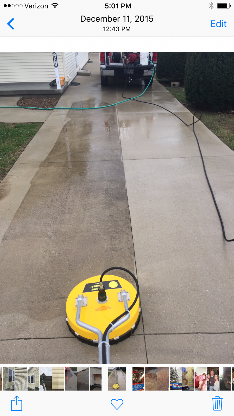

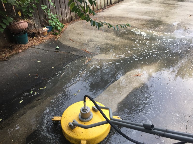

When you do any type of concrete cleaning, which is referred to as surface cleaning, pressure means nothing. Don't let anybody tell you it does. It's all about flow, GPM. The above picture you see is a 2 foot surface cleaner that's being driven by 2500 psi in about 8-10 gallons a minute. That's high flow but low pressure actually. But it's much more powerful than 4500 psi in 5 gallons a minute, although you would not think that it would be. When you use that much flow or GPM's, you will need to have a buffer tank because you were drawing more than a home or business water supply can supply. So it requires trailers and buffer tanks, etc. To turn the jets on a pro surface cleaner you're looking at almost 5–6 GPM minimum fm a pressure washer. An 8–10 GPM PW , preferable, will cost $4000 +. Surface cleaners, trailers etc. are on top of that. As I tell everybody that comes to shadow my work, welcome to the big leagues. :-) But for small concrete jobs that are very occasional, you can get away with a turbo tool & 1000 PSI. It's just very very slow. The driveway in the picture above this post I think was 10 feet by about 220. With my Tools I cleaned that from dirty to looking brand-new in about 40 minutes. - $300 . do the math on why am on the outside working and only doing carpets until noon. Cheers

Volume is great and comes at a cost. This is 3.5 gpm at 3200psi. Enough to cut, but fairly slow. But, if that's what you have, that's what you have.
That particular driveway took forever.

I think that your rig has a tremendous advantage; the lower pressure. How many surfaces have you seen that were blasted so hard, so often, they are degraded and aged by decades?
S
SteveCleans
On concrete it never matters because you cannot damage it with high-pressure. It will sustain much more. The damage on concrete around here stems from all the salt's and stuff in the winter. With that said I wash about 90 homes a year. High-end houses where i do the roof and windows and screens and all of the siding, concrete from the chimney to the mailbox by the road. When I wash the house I use this low pressure washer 2500, 5.6 gpm, . But I only run about 250 psi. It's called 'tipping down' .... you cannot change the flow or the gallons per minute that the machine is putting out, but you change the pressure by changing the tip orifice, very safe for the machine as each tip is designed for that particular GPM/psi machine. and it's done in a matter of two seconds. For instance I can be's rinsing my pre-spray off of the vinyl on a house around the window with a tip that has 100 psi, very safe, and then I could switch up to 250 psi and go back to rinsing vinyl in the open area. And then I could drop in a tip that has 1000 PSI and cut in the driveway concrete where the block foundation meets the concrete, before I hook up a surface cleaner and do the concrete which will be at 3000 PSI and 8–10 GPM . 99% of pressure washing companies do not understand the premise of tipping down. that's why I have a schedule full of people wanting to come here and work with me. Respectfully. I will be having a fest in the spring and having eight or 10 people here for couple days. We will do traditional and pure water window cleaning, we will do some roofs . Acid wash some gutters, soft wash some houses and do some service cleaning. My shop is a dream for carpet cleaners are exterior house wash people so it's like a festival of tools, and I mean the modern cream of the crop tools. I'm blessed. Sorry to ramble. I love to talk shop and I talk into my iPad so it is adds up real quick.

Good question but the answer is no. It's almost all outside and most sidewalks & driveways have a slight drainage angle to them so the water will gradually move down and slide off of the concrete into the grass. I clean X amount of square foot and then I unhook my high-pressure hose from the surface cleaner and hook on my gun with a three or 400 psi tip and I spray everything off real quick. It looks brand-new. And I hook my surface cleaner back up and clean some more and repeat the process
