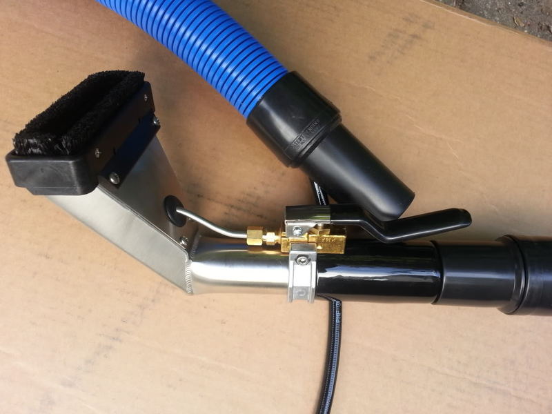

1)Which tool would be best used in, conjunction with a TM, for situations where a customer has tile/grout for the stairs? For the floors (ie: not the stairs), I would be using the Hydro-Force.

This one..
