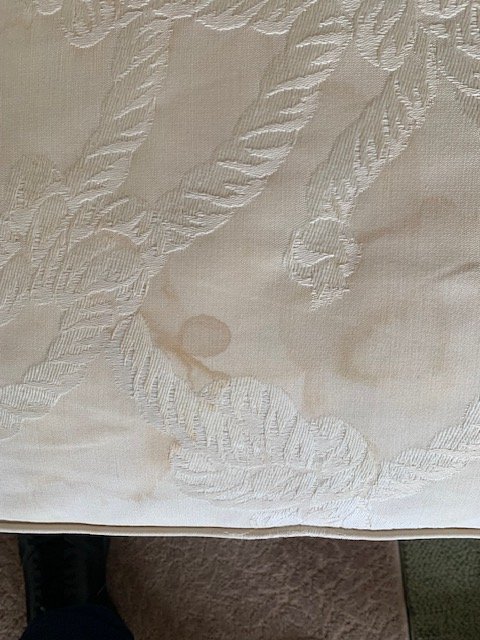

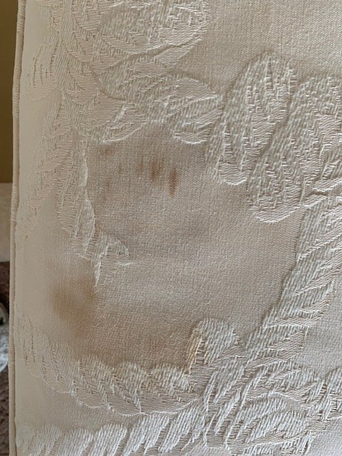

coffee on sofa
sassyotto
Jun 7, 2013
1,331
Paul
two sofas. tons of coffee spills.
Any suggestions?
28,275
Reactions: hogjowl
28,275
applied Stain 1 prior to cleaning, 2 hours later no change.
May be decaffeinated coffee in which case a reducer would work better. Something like Red Vanish. It can work too well, stripping out the original color. The oxy-encap works well normally on coffee as the buffing action provides a gentle scrub. The oxy stays on until it evaporates off, working until it does.

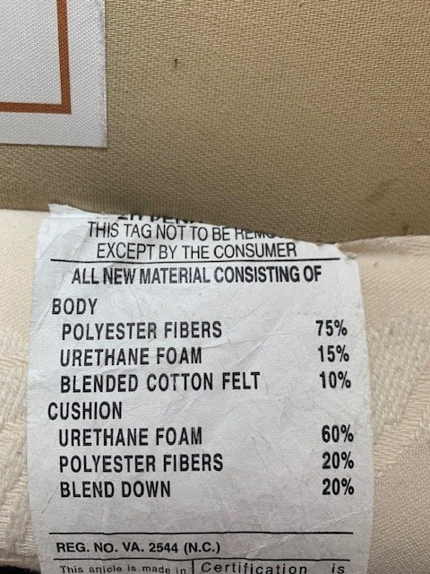

14,634
why are y'all not worried about the risk of color loss (change from white to pink) since there is a natural fiber listed?
I see the suggestions above of using a peroxide encapsulated treatment. That's why Im asking
28,275
Haven't had it happen yet.
11,543
Nevermind the tag, it doesn't tell you anything. I have had good success with Saiger's Code Red of Encaps both as a prespray or just doing low moisture with a buffer and pad. It contains oxy for the coffee stains and is acidic which is safe for fine fabrics.
