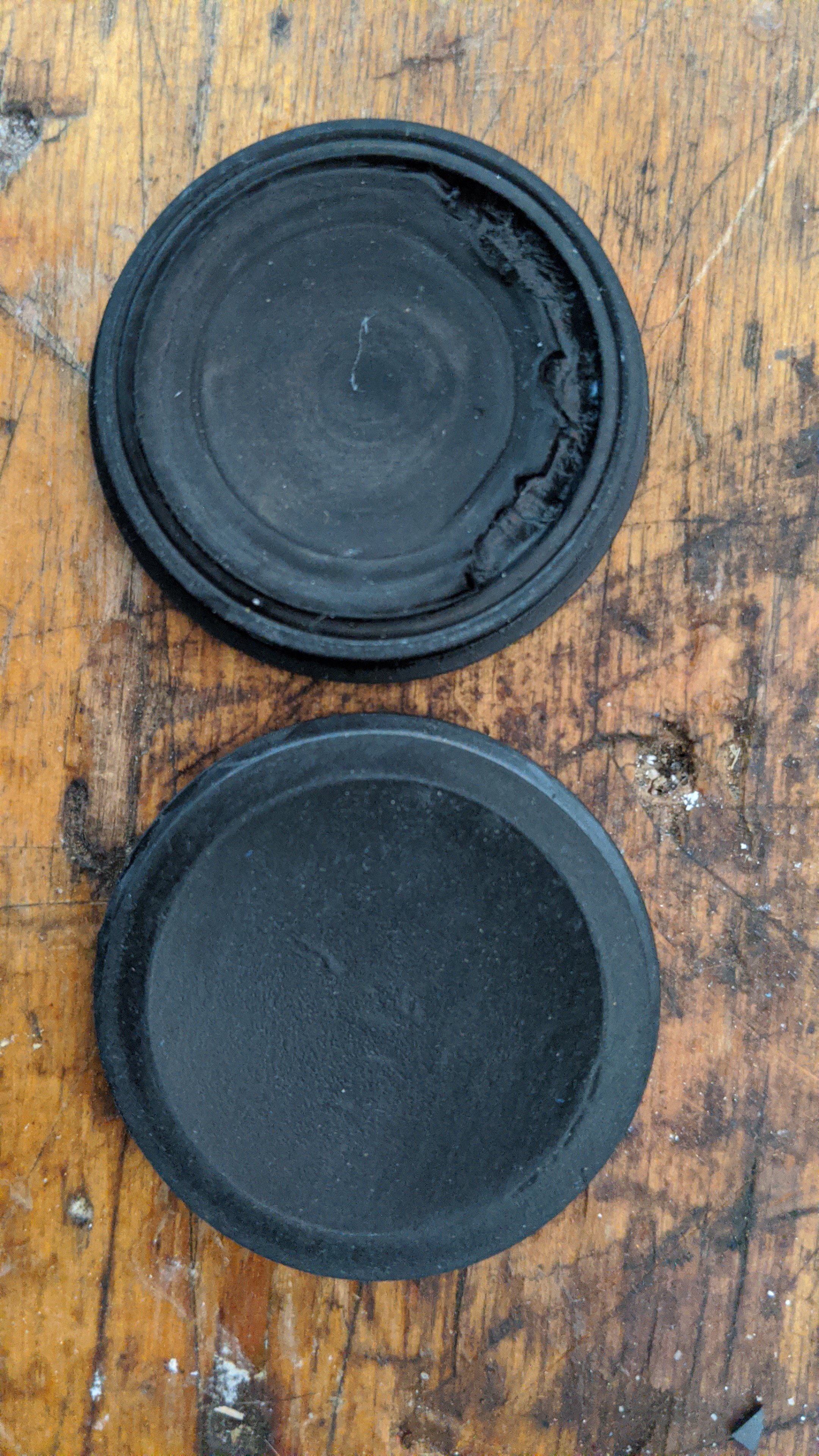

Chem pump diaphragm blues..
Cleaning Professional
117,396

See all the rubber missing from the old one? A lot of it is in the valves now. Take those apart and clean them too, replace the o rings while you're at it.

Yeah, I guess I need to try that next, it still wont draw chem unless wide open
