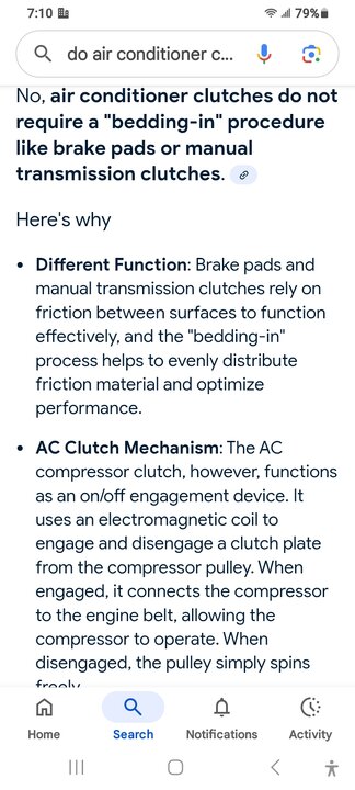

I have no idea what you're talking about when you say burnish im assuming you are referring to bedding/ transferring material from one surface to another ( like braking in brakes) if so i wouldn't worry too much about that . Pto clutches are metal to metal theres no resins to transfer . But i can tell you how to replace it. Assuming that you've removed any thing that is in the way .(aircleaner etc. ) if the clutch will still engage its easier to remove. So with the clutch in gaged and the Serpentine belt still on remove the center bolt. Youll see threds on the inside of the hole use appropriate size bolt and tighten to push the clutch off the shaft. Once it's free but still on the shaft go ahead and disengage the clutch and remove the Serpentine belt. Remove the clutch and electromagnet from the shaft. Be sure to not loose the woodruff key. Now to reinstall to set the spacing between the magnet and clutch can be done 2 ways one way is with 4 evenly spaced cardboard shims ( thats how i do it) but the other way is to evenly wrap electrical tape around the magnet. Enough that it fits snug in the clutch. Then with the woodruff key removed install the clutch and magnet as an assembly put the center bolt in to hold it all together on the shaft. Rotate the assembly to align the magnet with the 4 bolt holes be mindful of the position of the power wire. Install the 4 bolts and tighten. Remove the clutch. Remove the tape used for spacing. Install the woodruff key install the clutch and center bolt . Check to make sure that the clutch doesn't rub on the magnet install the Serpentine belt hookup power energize the clutch and torque center bolt to spec and you B done. Hope this helps. I use 4 pieces of thin cardboard because that way i can put it all together and reach behind and pull out the strips and not have to go thru the redundant steps in order to remove the tape used for spacing
Reactions: Newman and Bryce C

I'v heard you shoud turn the cds key on 5 seconds off 5 seconds a bunch of times.

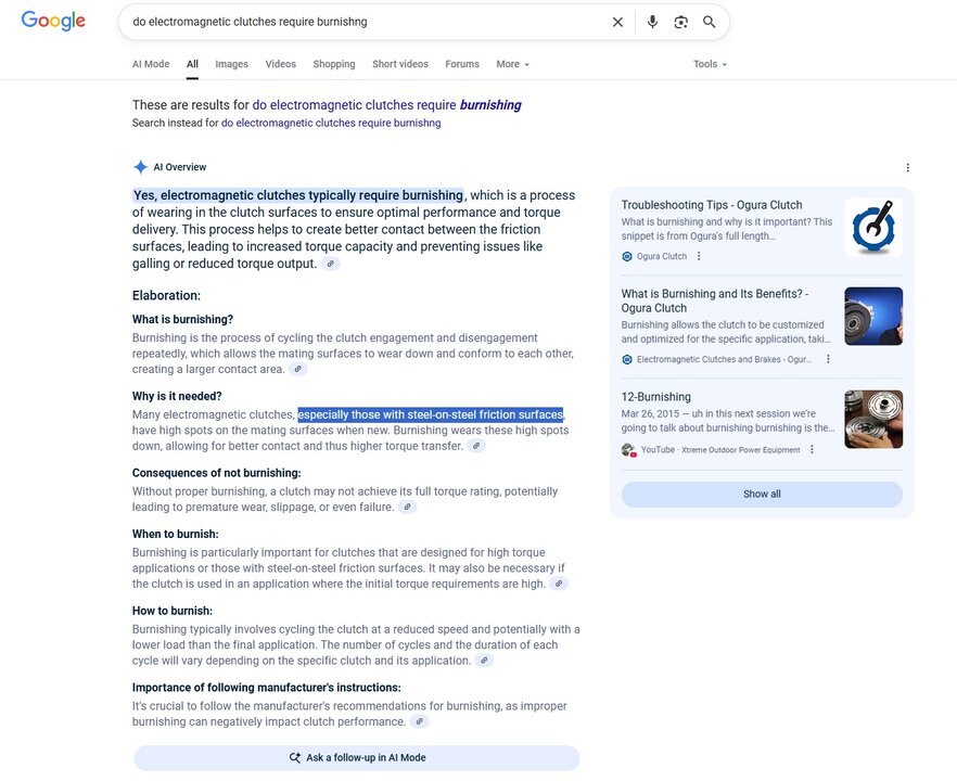

Why??? Ya tryin to wear out the switch??? I told ya and i showed ya there's no such thing a bedding an electric clutch of this type and whoever told you that doesn't know or understand what there talking about.
fredtestseven
Well Ogura, Pitts, etc say you don't know wtf you are talking about and they make the things.
I didn't want to post and I PMd him the other day but I don't want others following your bad advice. Most manufacturers call for the key on 5 sec on then off cycle 25-40 times to burnish a new em clutch. Not doing so potentially reduces its torque handling capabilities significantly.
be careful who you listen to folks...
in case Dwayne needs a google screenshot since I know he loves them
AI/google is not a substitute for critical thinking and proper research especially if you don't know what questions to ask
*the caveat to this is clutches that are specifically listed as pre-burnished

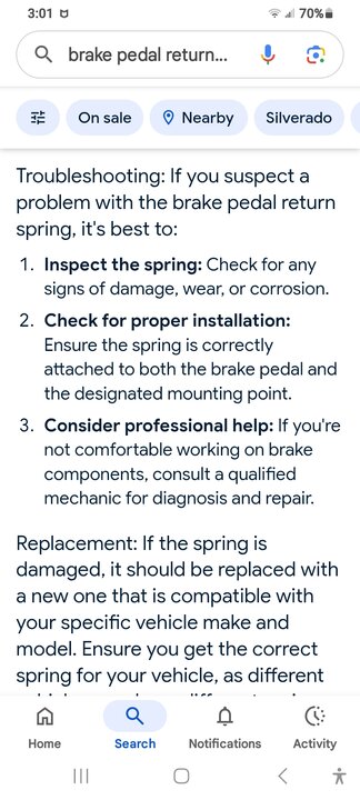

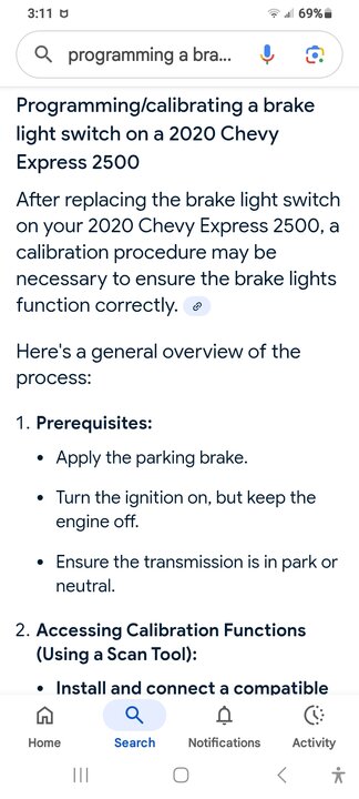

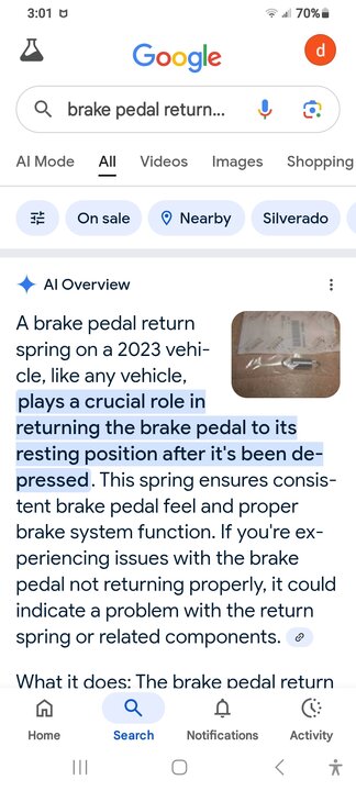

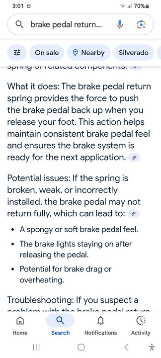

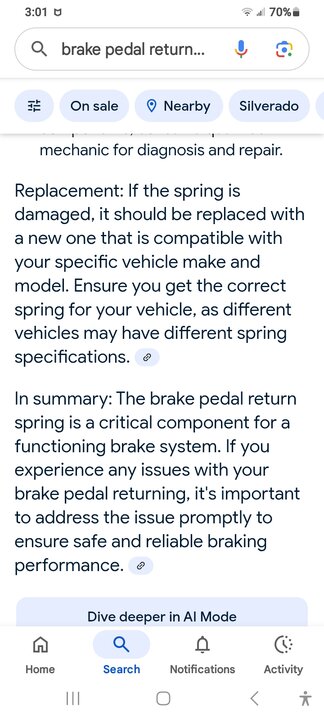

Is it the switch or some sorta spring return on the pedal it's self? If you can hold the brake pedal up with a bungee strap and the switch works perhaps its something as simple as a spring. I don't know about your van but in the research on mine if you can believe this, on a 2020 chevy express the brake light switch must be programed when installed! And that my friend is the stupidest thing i have ever heard but its true. Till the 2020 the newest chevy van i have had experience working on is 2001 and that was not necessary on it but you might check
Screenshot_20250809_150123_Google.jpg Screenshot_20250809_150138_Google.jpg Screenshot_20250809_150149_Google.jpg Screenshot_20250809_150158_Google.jpg Screenshot_20250809_151150_Google.jpg Screenshot_20250809_151231_Google.jpg

I had a brake sensor problem on my Cleanco. I bought two aftermarket sensors and they both wouldn’t work. Went the Chevy dealer and bought one of theirs and it worked.

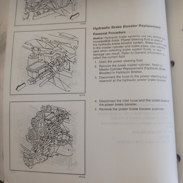

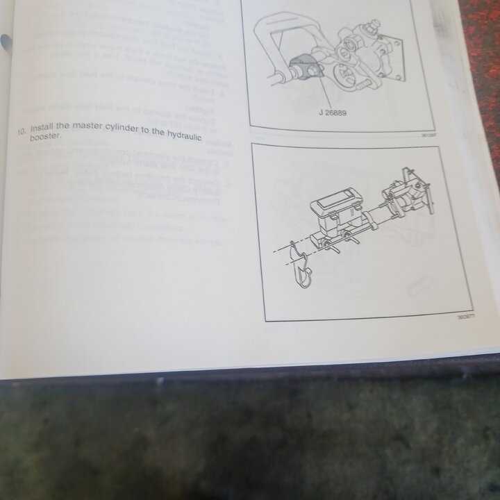

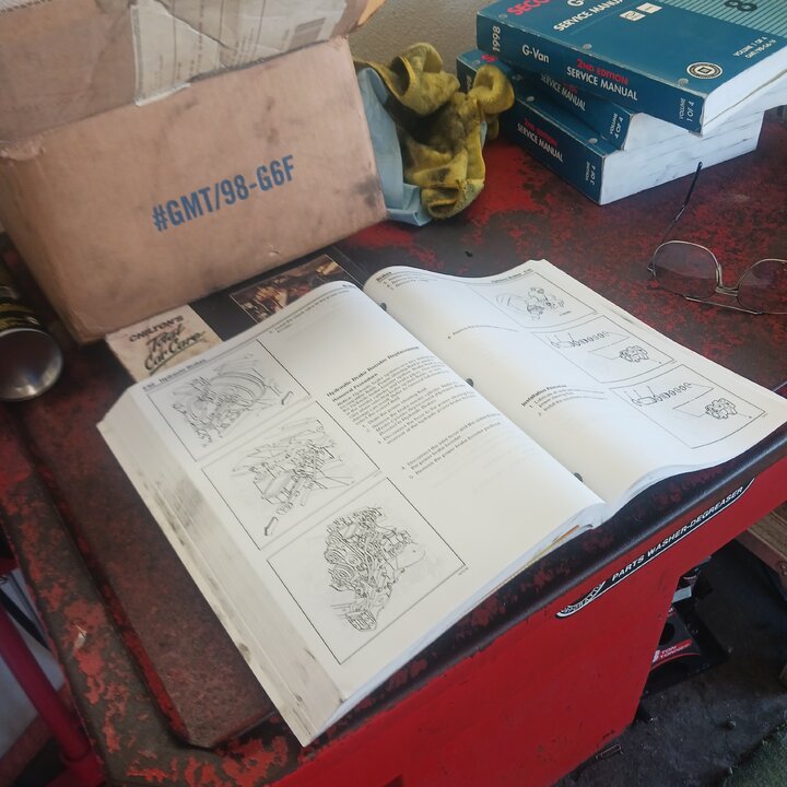

When i buy a vehicle the first purchase i make afterwards (if i can't trick the saleman to add it as condition of sale) is complete helms factory service manuals. Everything that the dealership has on computer i have in book form there year and model specific but are generally good for several years my 2000 i still use the manuals for my 98 and i couldn't get one fot a 2020 so i settled for a 2019. But interestingly the 1998 is 3 volume so is my 07 mustang and 05 ranger but the 2019 chevy is 6 volume s theres that much more shit to do and go wrong in guessing till resently the van's been under warranty and ive only used the manuals for frankinstien's install even then just for wiring info and component locations. I relyed more on the cleanco dealers install 200 page pdf for most because i used a cleanco drive and coolant taps and the same throttle controller

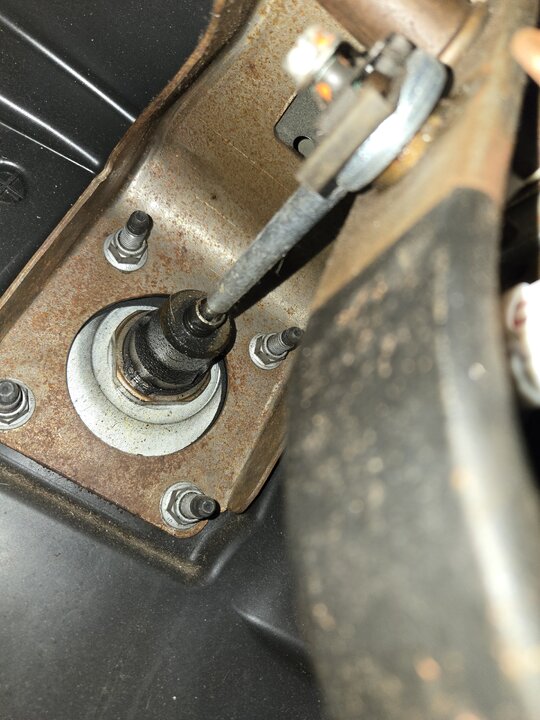

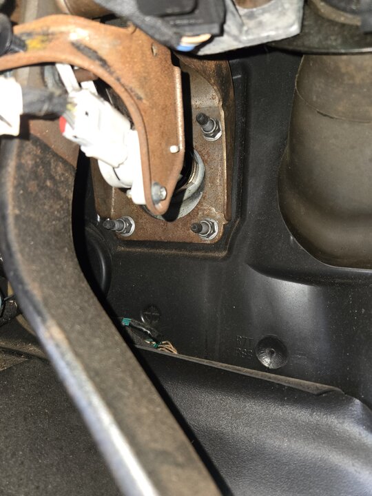

Looking at it the brake pedal has a shaft that goes straight back through the firewall to the brake booster, no spring on that. The brake pedal sensor has a spring mechanism in it, but the dead zone of flop on my brake pedal is about 1/4". When I lift it up to the position where the throttle controller works I don't see the brake pedal sensor move at all. Doesn't seem like it should be causing a problem, but it is 🤷‍♂️

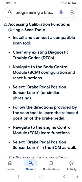

I hope the new sensor doesn't need to be calibrated! My van is a 2013 Chevy Express 2500
View attachment 132116View attachment 132117
Looks pretty simple 1 bolt an arm over a shaft and a wire connector and your done. Is your hydro boost leaking? Or just the light when photographed?
It looks oily when I look at it. I monitor my brake fluid and it seems stable. Or would the hydro boost actually be leaking power steering fluid as that is where it gets power from? I did add some power steering fluid when I first bought it...
Hydro boost is a hydraulic power booster where as most cars use a vacuum boost for power brakes. Chevy uses hydraulic pressure to boost it gets the oil pressure from the vans power steering system thats why under the hood you have 2 hydraulic hoses off the back of your master cylinder 1 goes to the power steering gear box thats high pressure the other goes to the side of your power steering fluid Reservoir. That is return
Thanks Dwain. What is this particular part covered in oil that the shaft behind the brake pedal goes into?
The pedal is connected to the hydro boost. Just like in you car there the pedal is connected to the vacuum boost ( the big black round thingie behind the master cylinder). So if oil is leaking in the cab is power steering fluid if its leaking behind where the master cylinder is bolted is probably brake fluid but could also be power steering fluid there too. Chiltons manual's don't have any information so i pulled out my 1998 helms . Here are a couple of pictures hopefully will help you understand. Youll also see why i get these manuals

If you're going to invest in one of these manuals be settin down when you get the price. There between 480 and frankinstien's was 700.00. But if you got the patience you can grab one on ebay for around 200 just make sure you're getting all the volumes if you go that way. After you get over the initial intimidation youll find them quite informative anything you do is detailed step by step illustrated instructions with cautions hidden parts and torque specs for every bolt and screw along the way. Alot of the test procedures can be a little daunting and you probably won't use much but if you are a complete diy er they are invaluable. Whenever possible i also get the Chilton and Haynes manuals also however i use them mostly as a quick reference book
