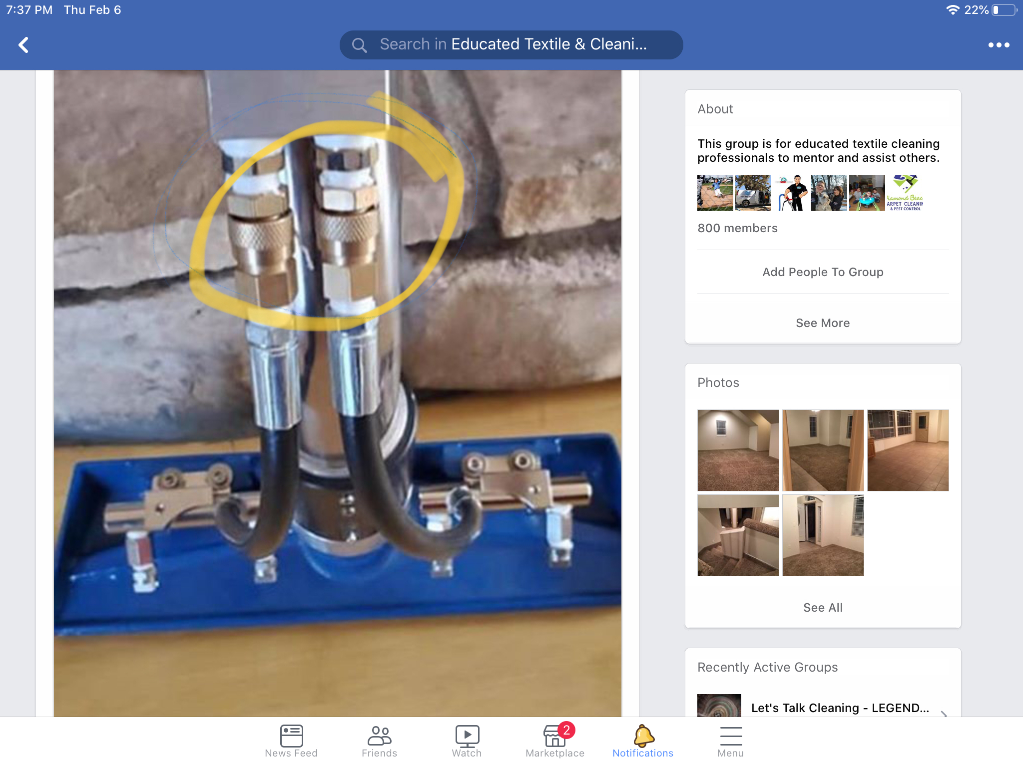

My dev 14 has a bad leak in the brass water area quick connects need to order more quick connects
messaged Tom just wondering if these are available anywhere??????

Thats a dang wand not a tom wand and its not the wand with the leak used for illustration purposes only.

Try pressure washing outlets. Looks like an open flow QC. Maybe even home Depot.

I looked on his website all I saw was hoses for $100 my hoses are fine quick connects leak

If there open flow 1/4 inch home depot should have em. In a pinch sometimes you can flip em around and put the worn side down and the good side up.

They are on the web site, $42 for two pairs.

Thanks I found it needed a new slot glide too.
Is there something in should do to make these brass disconnect last longer? Wd40?

I prefer SS male connects and brass female.

Superlube. Either in a spray can or grease in a tube. Part of regular maintenance.

Because the couplers are NOT repeatedly uncoupled there is likely very little metal to metal wear.
It's all o rings.

I ordered new ones from the website I also needed a new slot glide for my 14 inch dev
