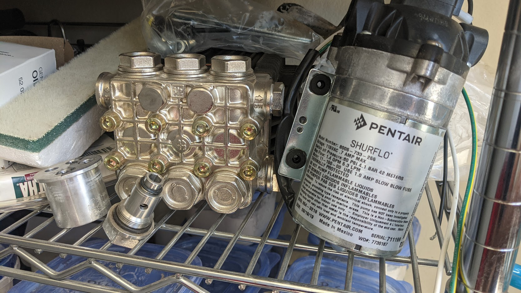

I got that backpack sprayer that Sarti got. I also bought 2 replacement batteries for it. When I get time I'm going to go through my Vibe and replace all the 1/8 ice maker lines. I think your theory may be right about me having an air leak. Hopefully my pump isn't the issue.
I have multiple shelfs of backup parts. But never the part I need.

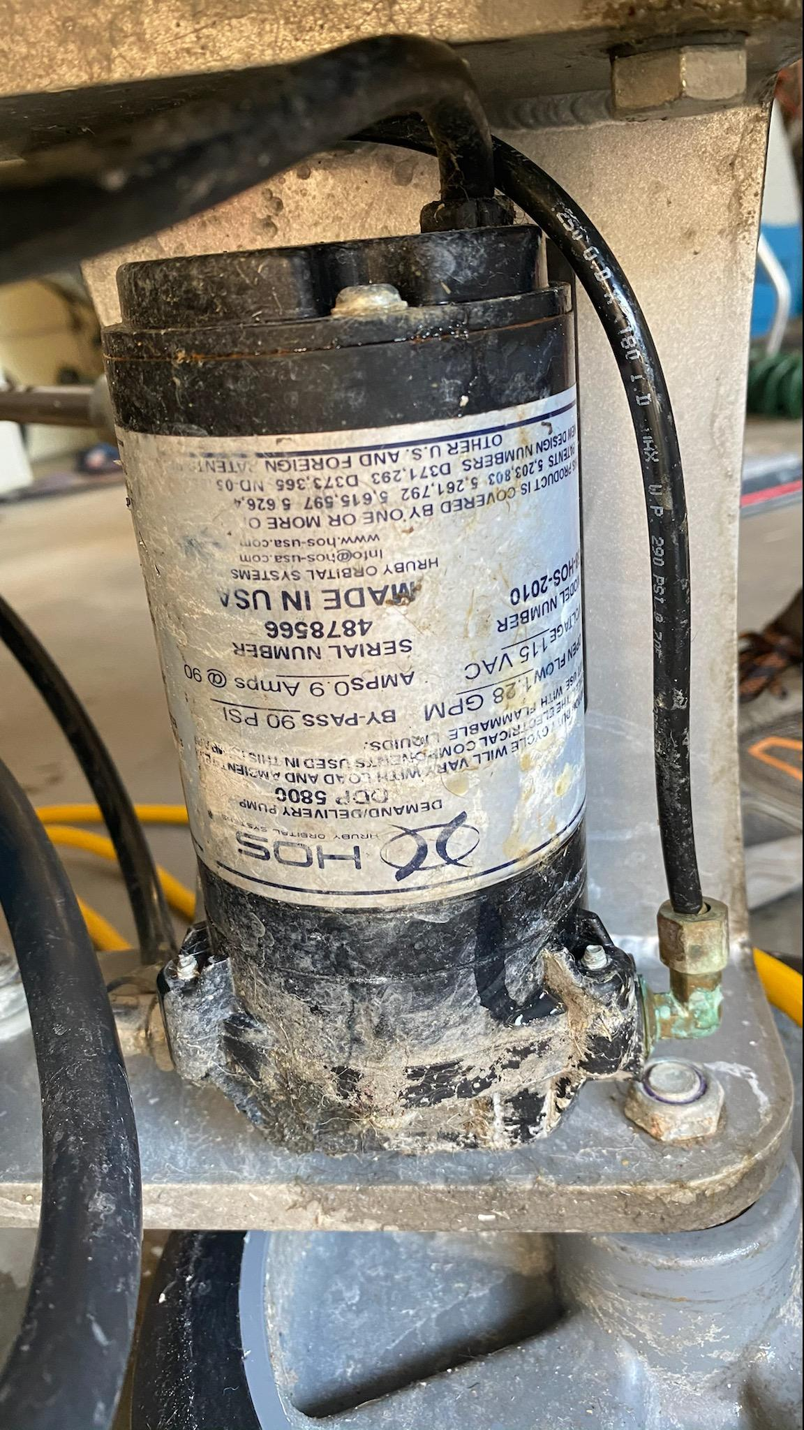

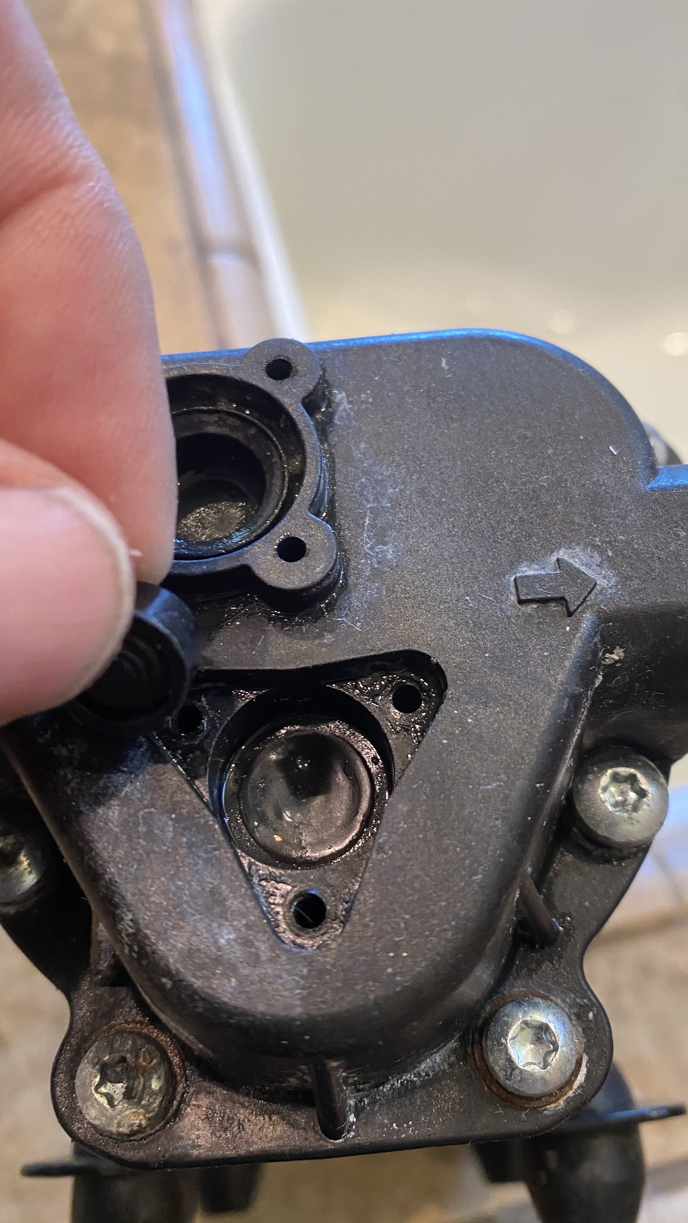

Today I went through the entire system on my Vibe. There were no air leaks or water leaks anywhere. I then pulled apart the motor and tested it in my kitchen sink. it was not making enough pressure to push my finger off the outlet or even make a spray when pinched off. I removed the cover to the diaphragm and it looked to be damaged. Looked like the spring slipped off the plunger and then damaged the diaphragm. I ordered a new pump for $168.
