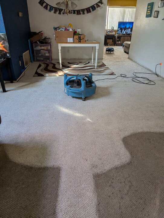

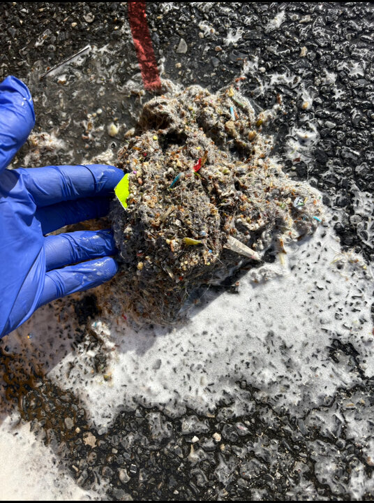

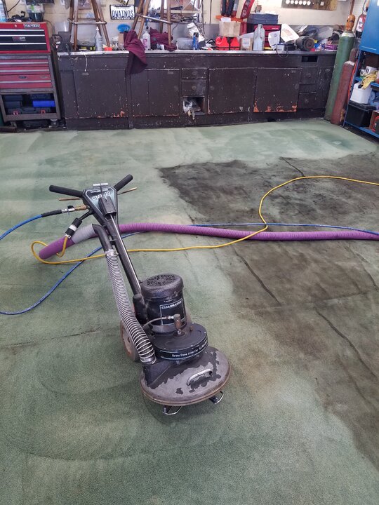

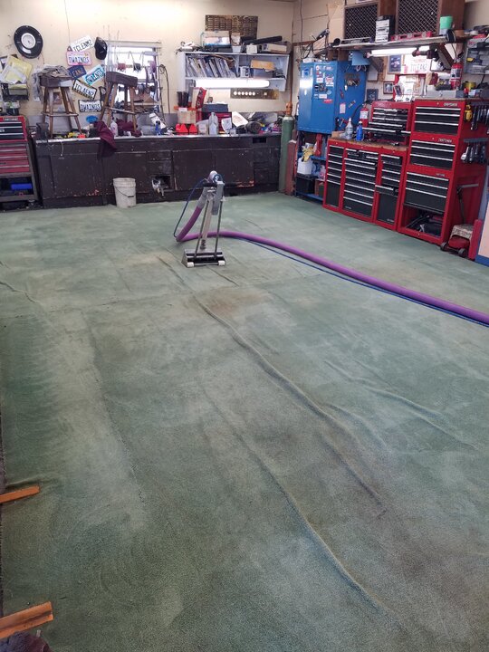

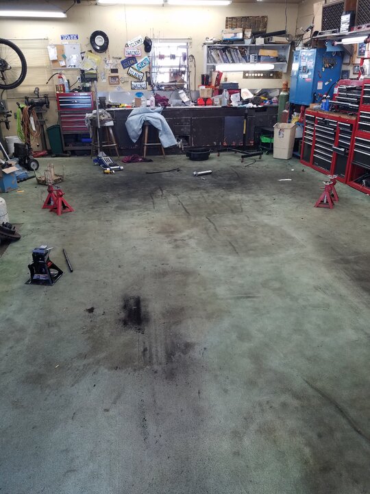

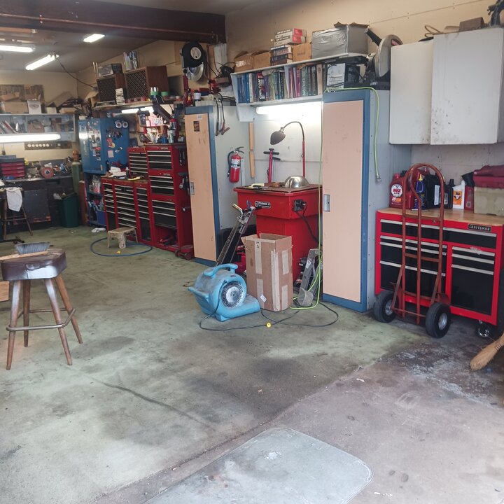

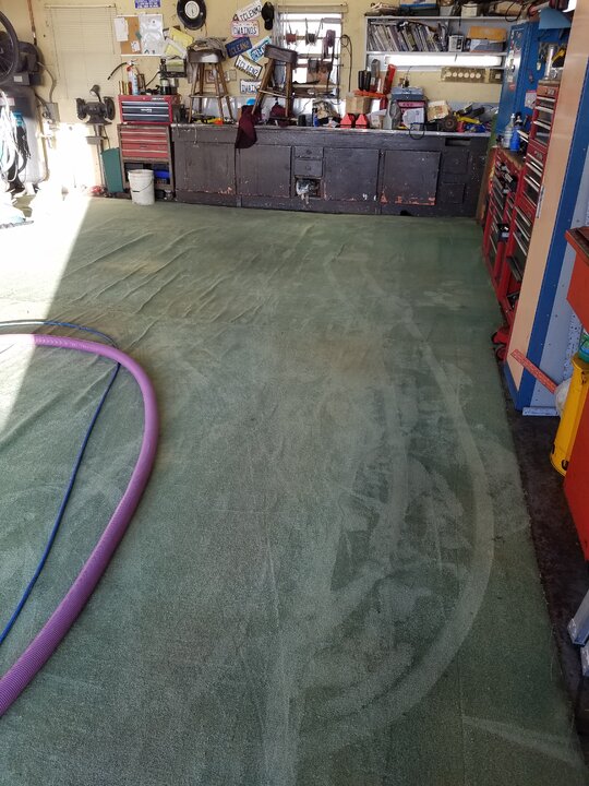

Wanta put your money where your mouth is??? I gots a dirty carpet. We can put a tape line down the middle and you can choose whichever side you want to play around with and ill clean the other. But we'll post the results and make it public. What do ya saylets put that little brush toy of yours up against my truck mount. The last couple of pictures are of the last time i "pressure washed it and pushed the dirt deeper "(lol) anybody can clean a clean carpet with just about anything hell, you can clean a clean carpet with a spray bottle of club soda and a washcloth, but a dirty carpet needs a professional with professional equipment. Im not apposed to even puttin some serious money on the outcome but like i said the outcome is made public, all platforms
20250119_140425.jpg 20250119_140446.jpg 20250119_140454.jpg 20250119_140715.jpg 20201019_151359.jpg 20201019_162938.jpg 20201019_172111.jpg 20201019_172908.jpg

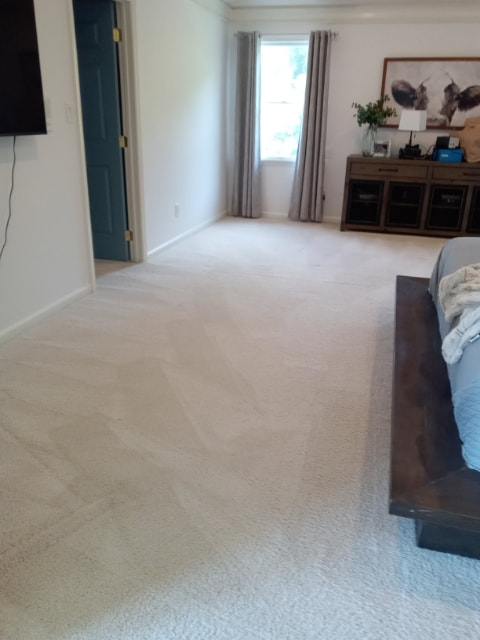

I knew my OPINIONS would cause an uproar
And I knew I wasn't going to change anybody's mind and nobody is going to change mine
Both methods have plusses and minuses
But for me all the minuses and headaches that come with a TM and HWE far out weigh the plusses
After 25 years of HWE and 6 years of VLM I prefer VLM
I love VLM !!!
View attachment 131041 View attachment 131042 View attachment 131043 View attachment 131044 View attachment 131045 View attachment 131046 View attachment 131047 View attachment 131048

Well unlike most, im willing to put my money where my mouth is. I got 100oz of silver that says my machine Frankenstein can do a better job of cleaning this carpet than your little carpet sweeper can. At this moment thats $3,361.00 , you can buy a fleet of them little sweepers with that,But if you take the challenge win lose or draw the results will be posted on all platforms. That's how much i belive in my process

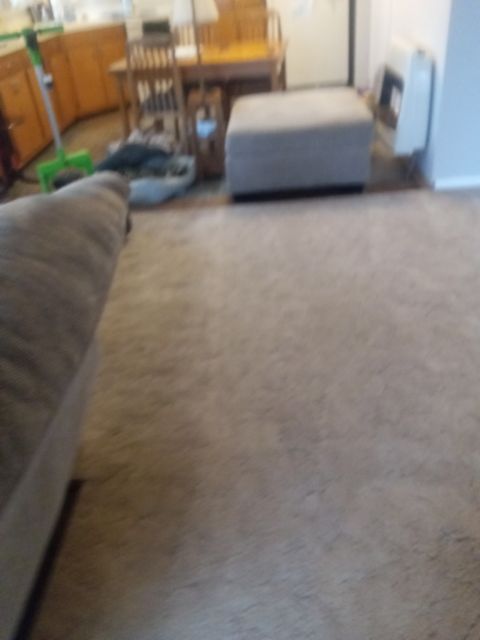

Go back and look. I have three pictures on this page and one pic on page 3. Do you see any corn rows ???
If you use stiff brushes to groom with on some carpets you could leave corn rows. I use soft wool brushes for grooming plus a 10'' CRB is very light
Sorry no corn rows when job is finished
After I use the 14'' CRB to scrub it does leave some corn rows on some carpets but my OP takes those lines out and leaves light swirl marks on some carpets. The 10'' CRB takes the swirl marks out
10'' CRB grooms the carpet better than a brush. It would be faster to groom with a brush but I like the way a 10'' CRB grooms carpet
NO CORN ROWS !!!
Anymore questions ???

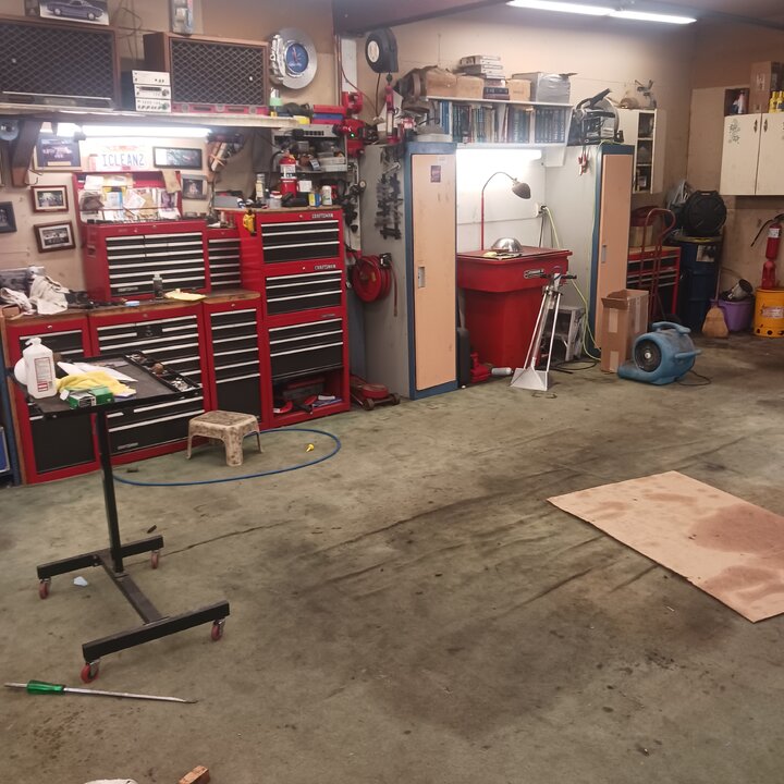

As soon as I get home I clean bonnets. I don't let them back up plus they clean up better if you clean them the same day. No dryer. I hang them to dry
HWE has gallons and gallons of dirty water to worry about dumping. I would rather wash bonnets
There is my dirty water tank
