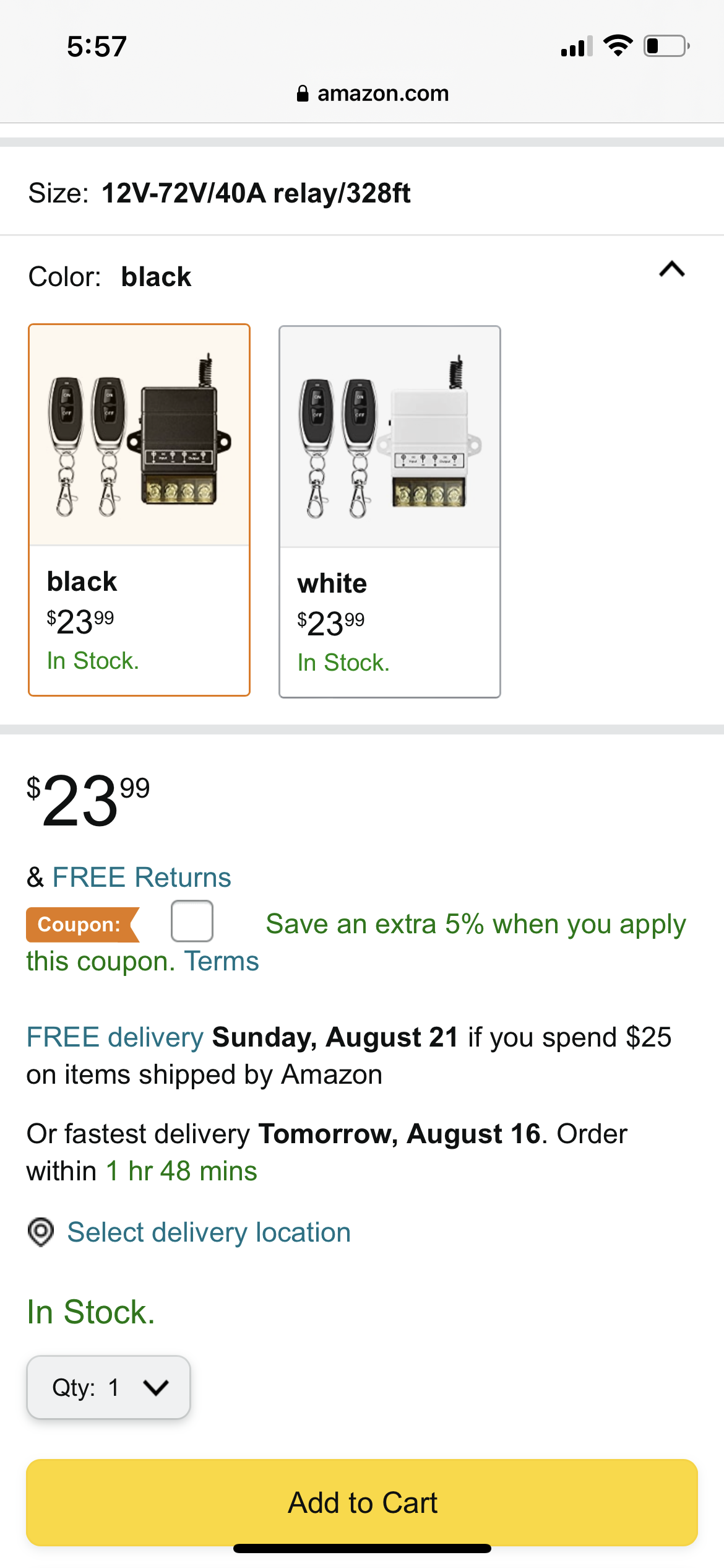

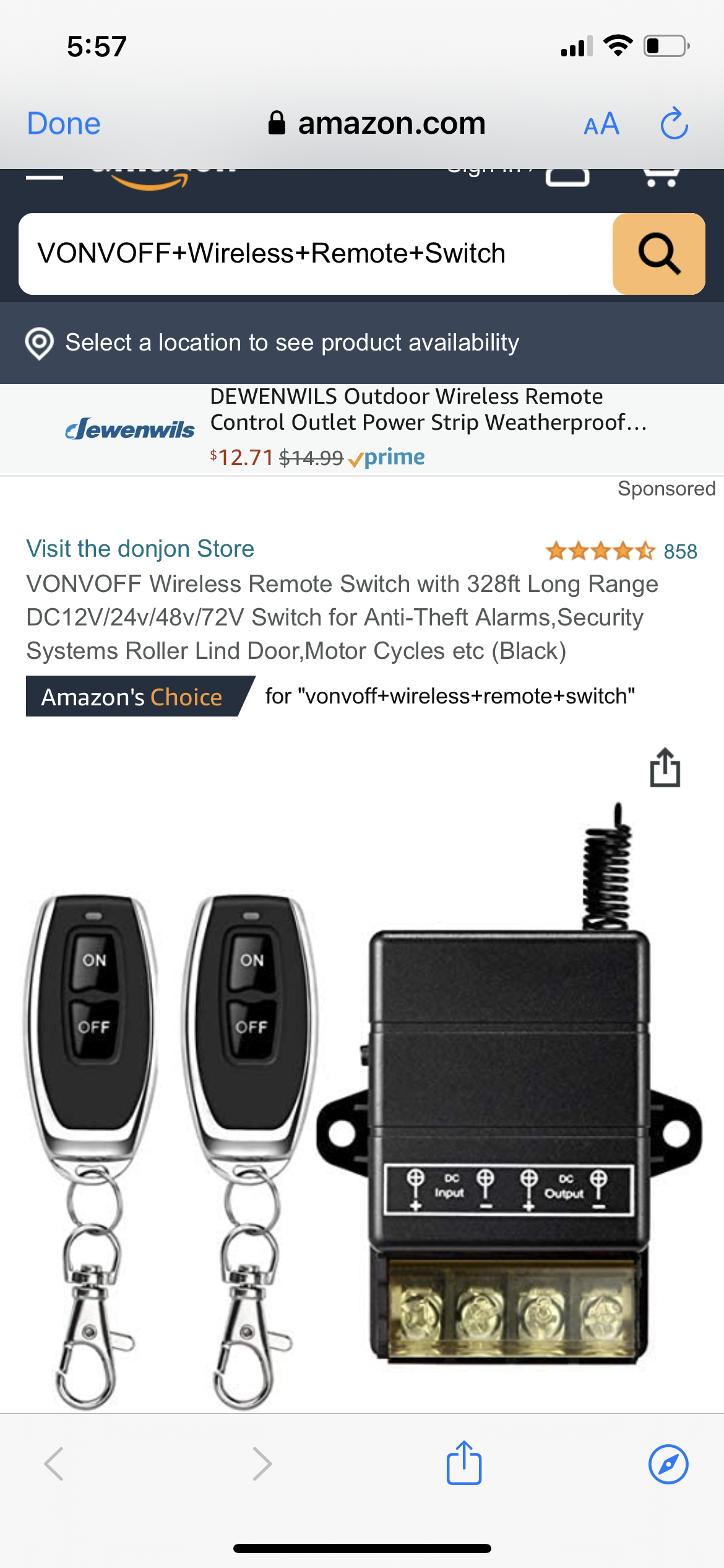

Amazon. My Dad did all the work, I will get you the link.

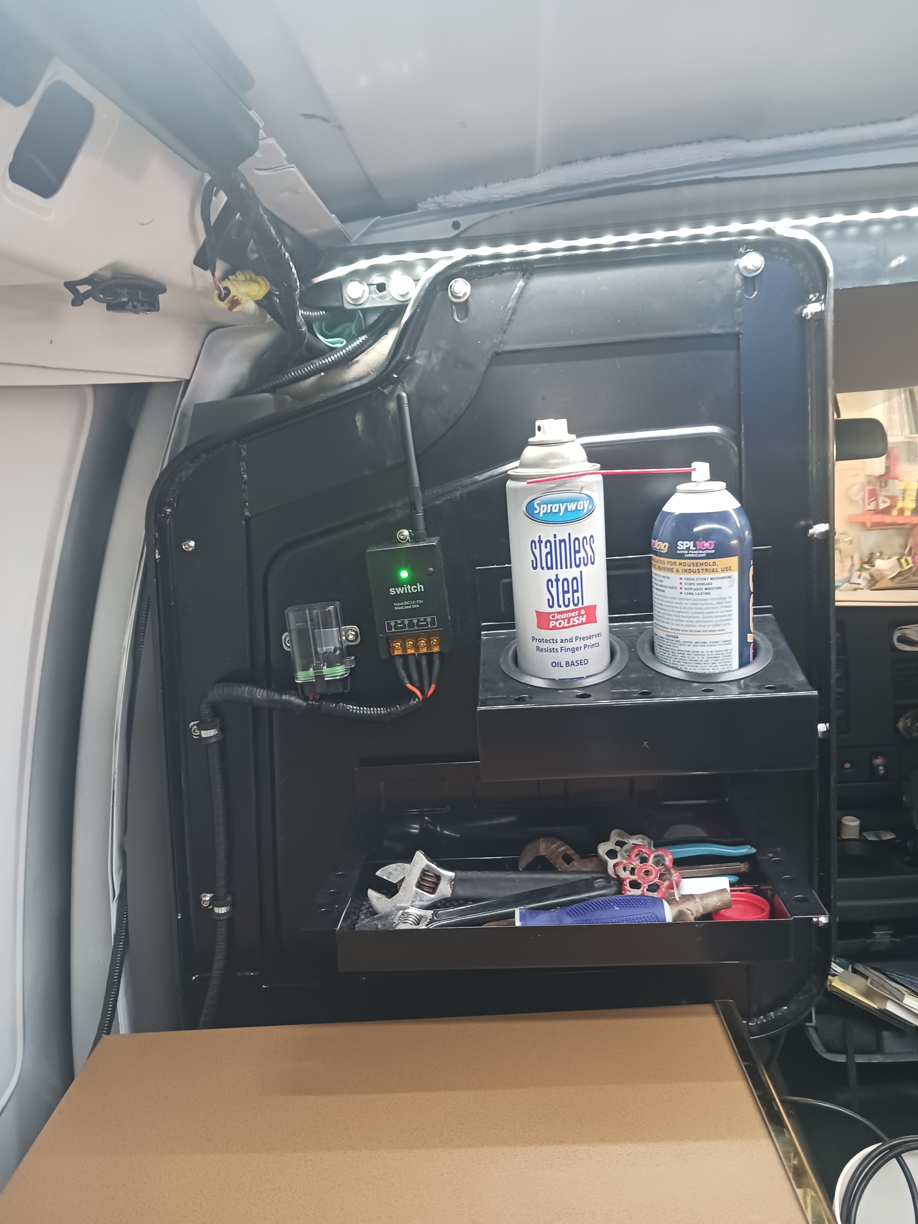

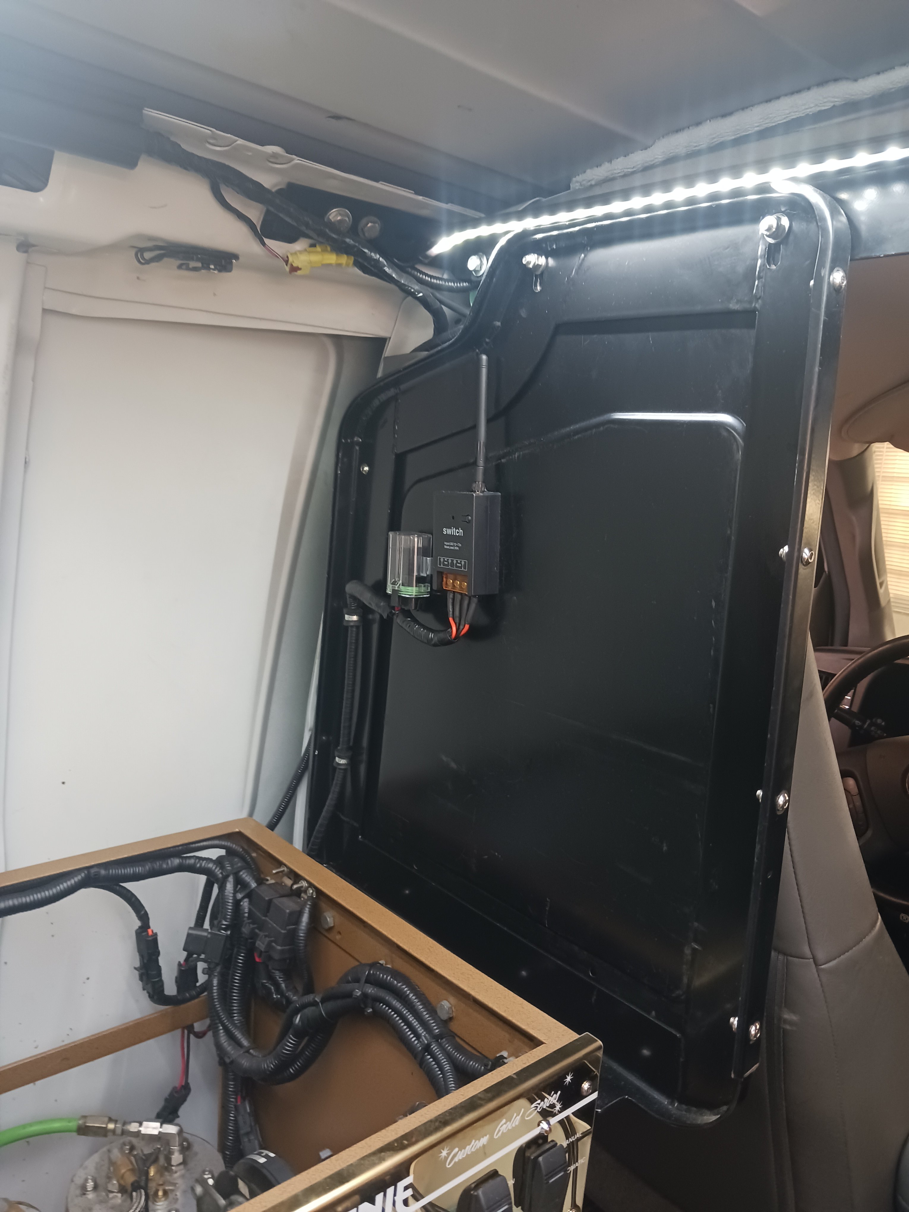

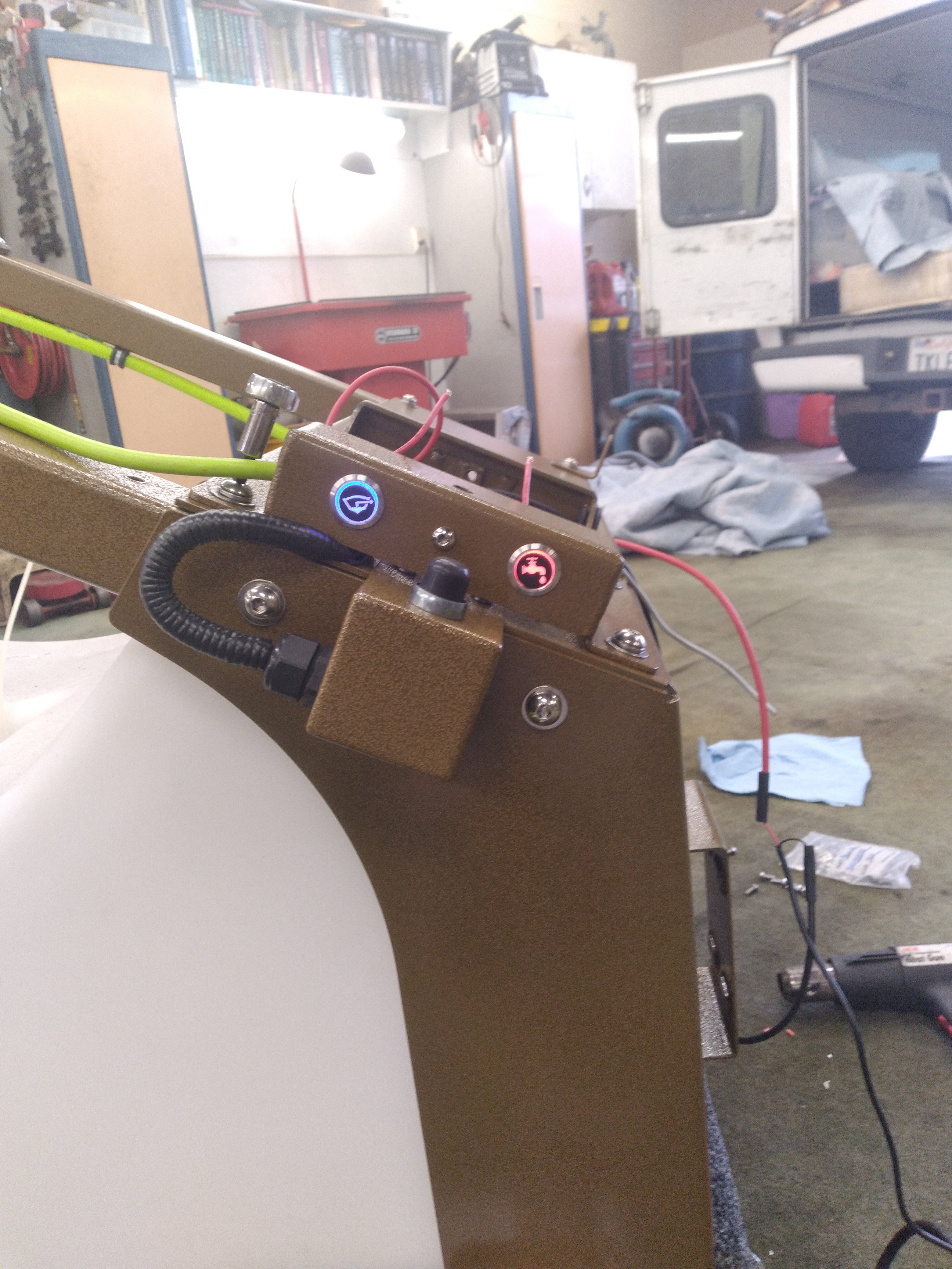

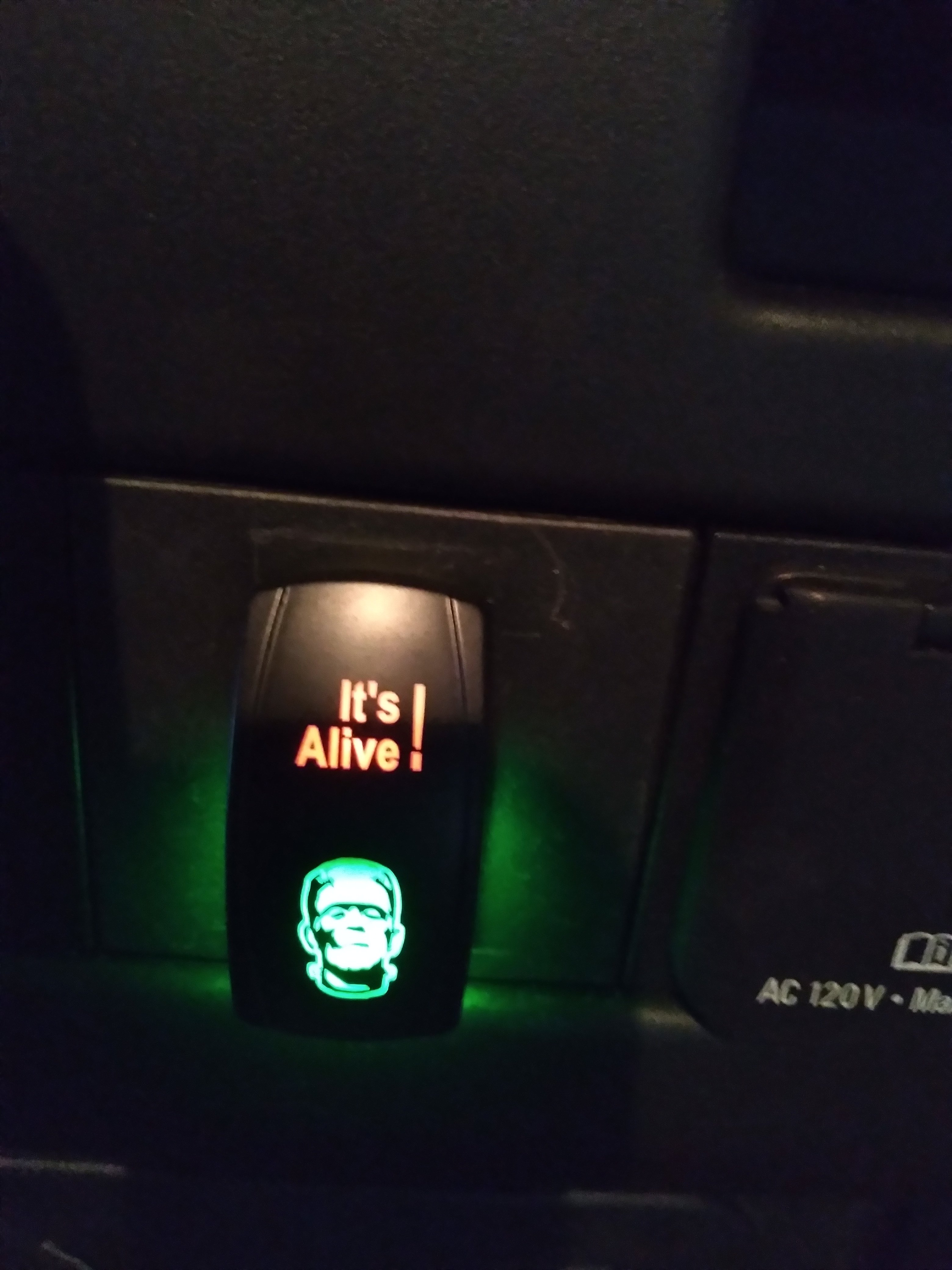

Looking thru these posts i see what youve done on my syst it will be a be breeze all my machines pwer is controlled by a single relay box and is energized with a switch on the dashboard so all ill have to do is wire the remote controller between the master switch and relay box, that way it not only cuts power to the machine but the throttle controller also so my engine will drop to idle and like the waste switch itll powerthe machine backup then throttle up also, or maybe easier tie it into the waste tank float switch which will kill the throttle controller also. ya!! my minds a goin now thanks frankinstien's gettin a remote!!!

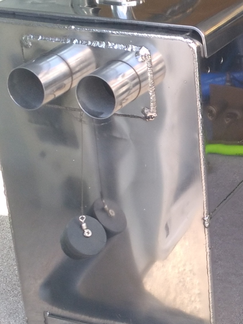

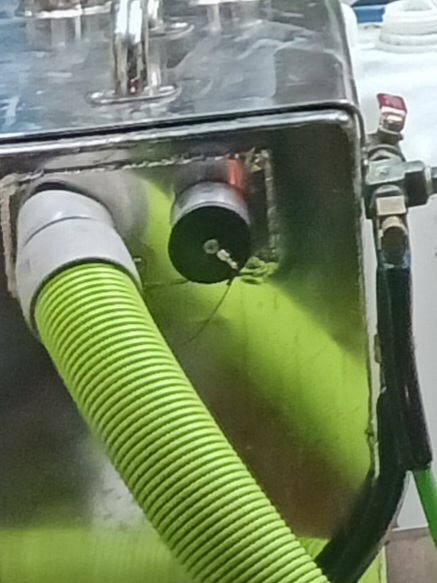

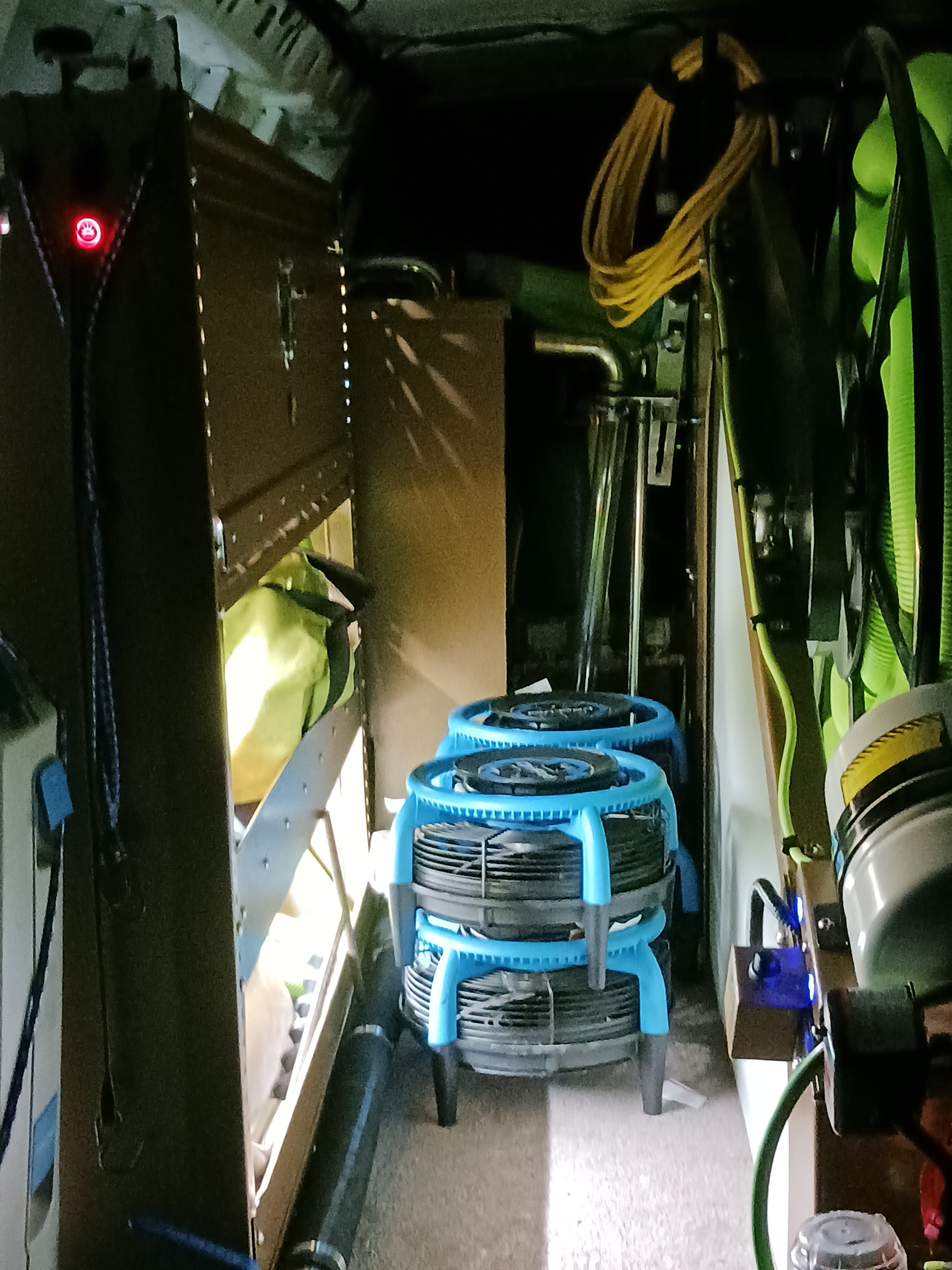

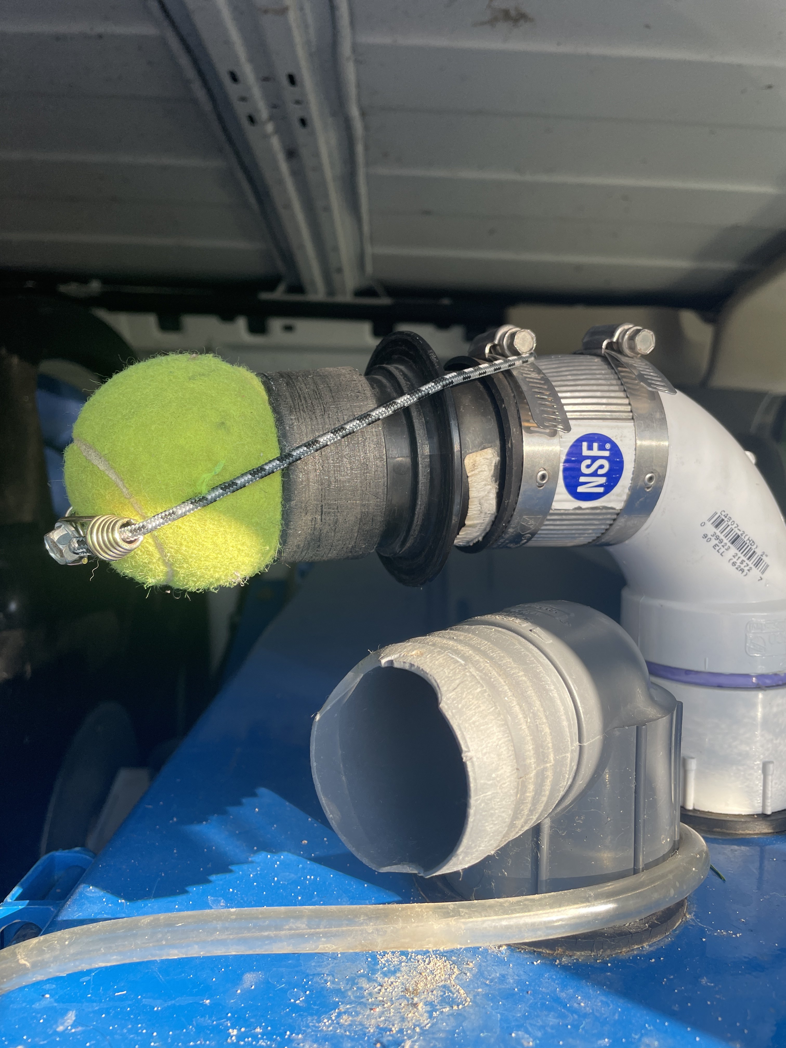

Loving this option after a couple days. First time I restarted remotely I had no suction. the tennis ball fell out of port 2 when machine off. Never liked the ports on this machine and had to customize from the start. My old Thermalwave has nice ports welded on and have rubber cap that I don't need to play around with. On this machine, not the case. I will find one soon, but for the last 6 years just been plugging with a piece of wood or a tennis ball.
Here is the quick fix. Now im set, and looks so high tech lol
Dwain Ray
Jul 22, 2020
389
I use a 2" rubber bathtub plug i got at ace hardware on a piece of stainless fish leader , holds good never falls out lasts forever

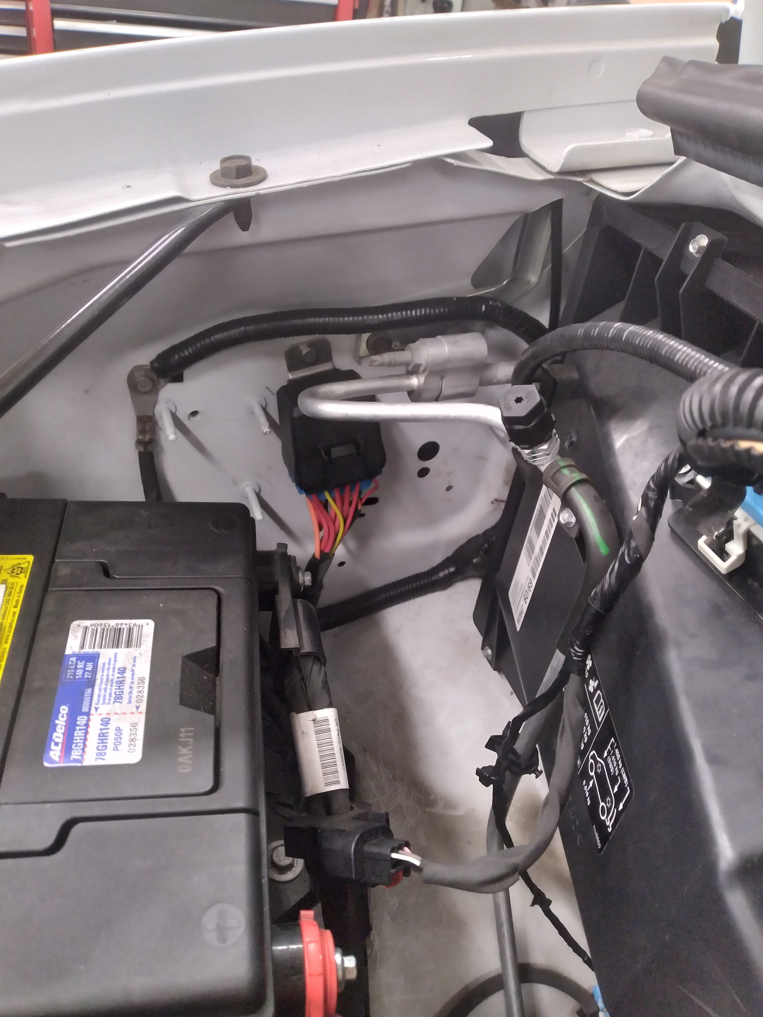

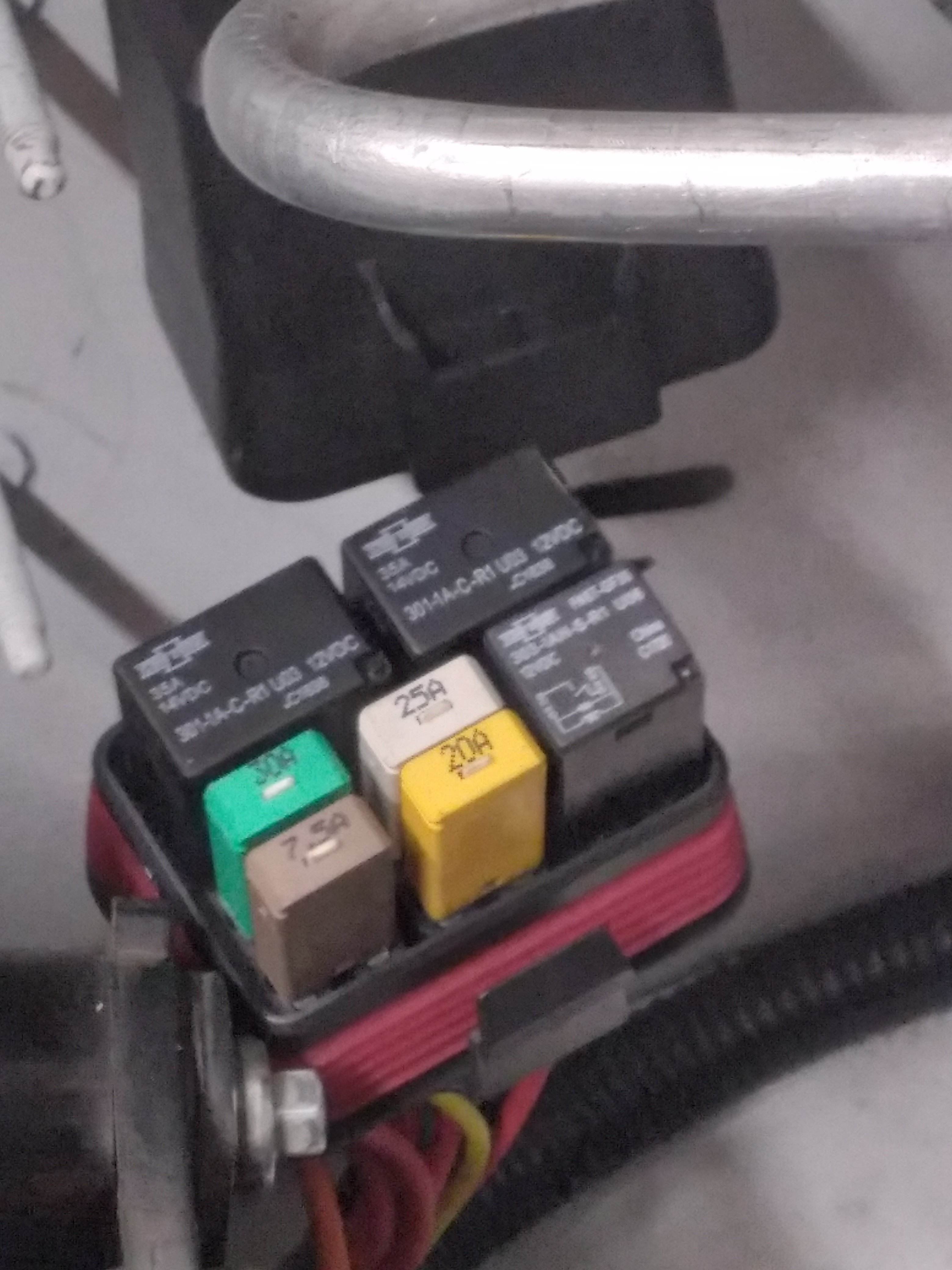

Thanks to Mikej Frankenstein's got a remote also. On my machine i chose to tie the remote controller into the wastetank high water circuit which uses the negative wire to open a relay to shut down the machine when the tank is full in order to do that the controller had to energize a micro relay to shut down the machine , i opted for a longer range remote up to 980 foot. Advantage to using this circuit vs ignition switch is if i forget and leave the remote home the machine will still run just no remote control (last picture is a video just tap it) thanks again mr mikej. Dwaino

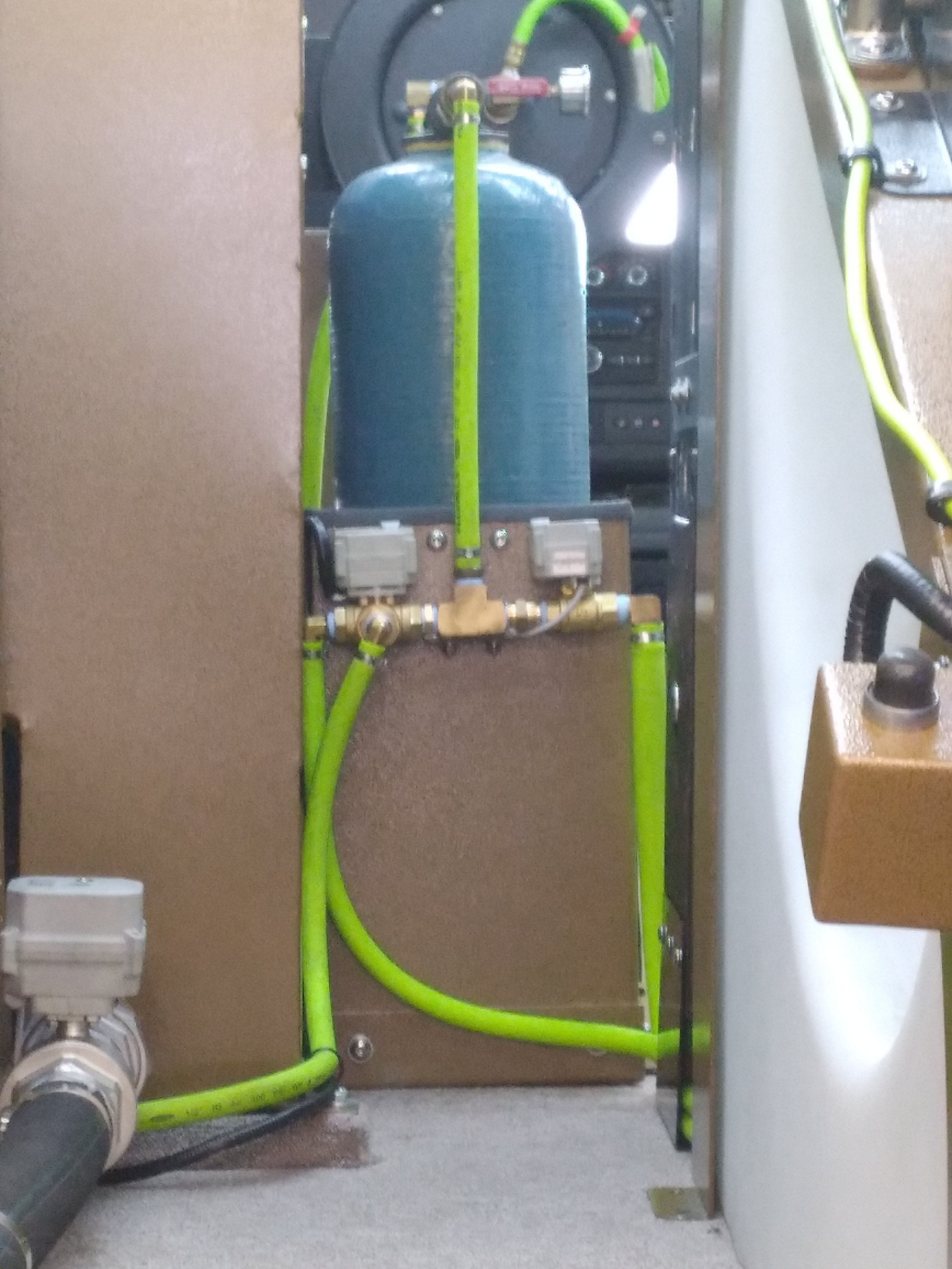

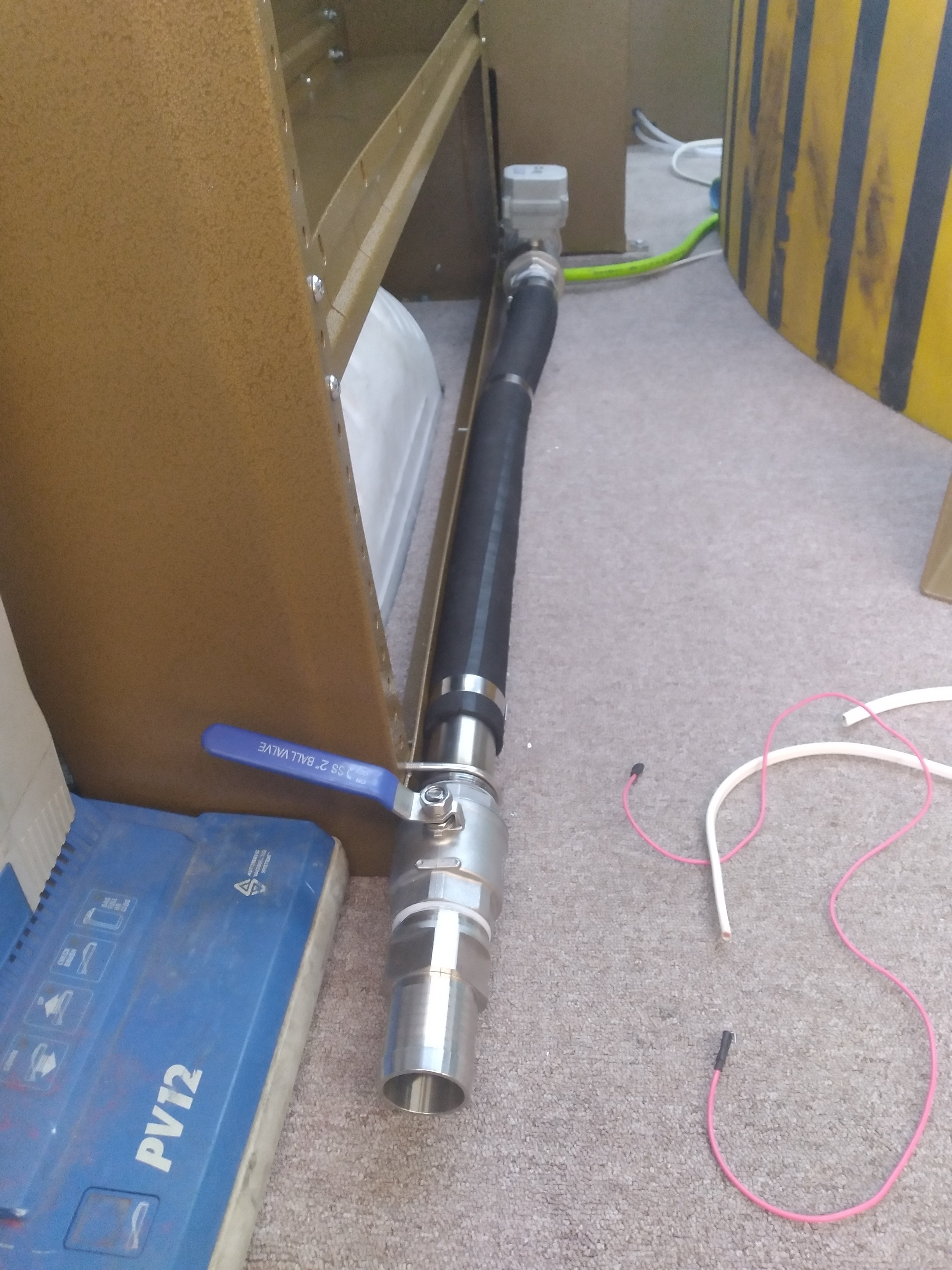

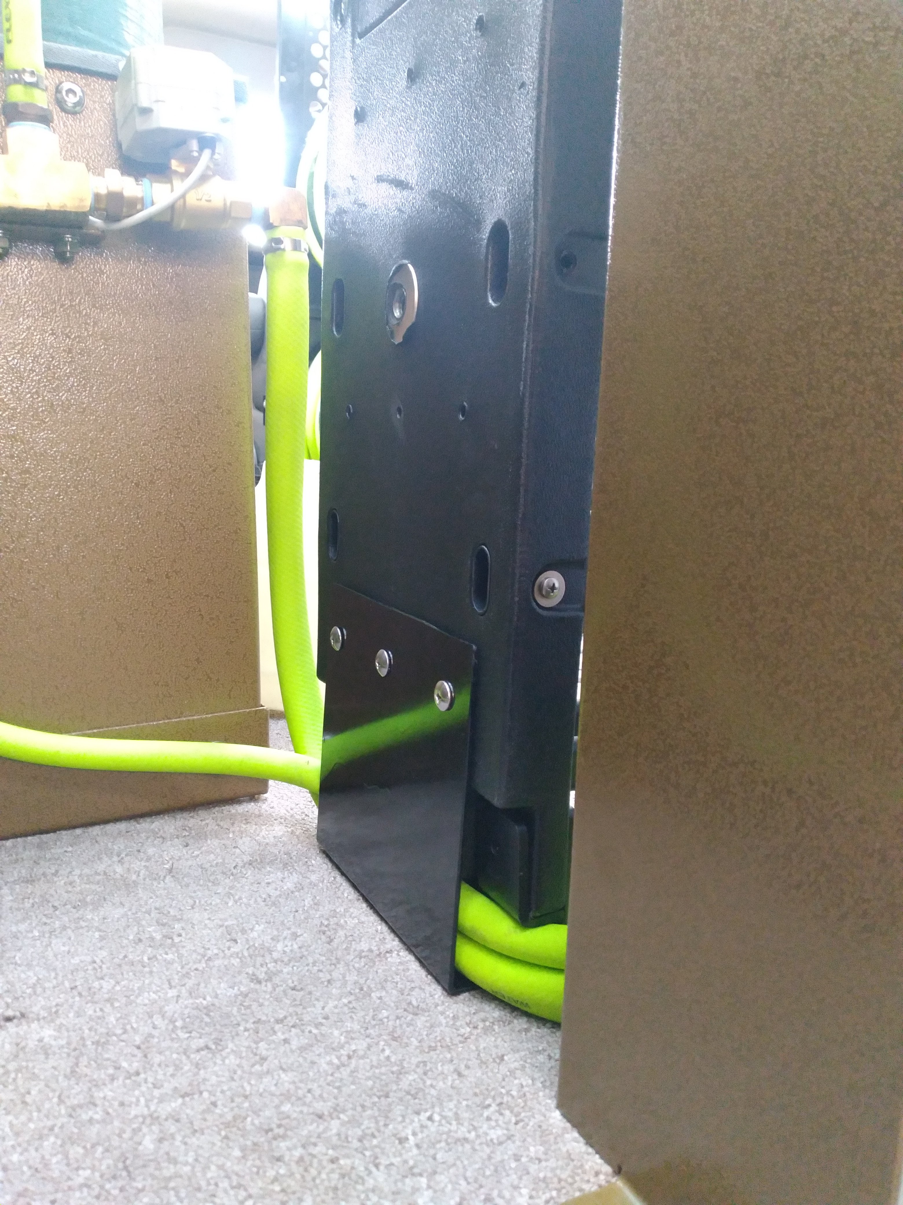

My machine doesn't really have that many special features. outside of the remote start/stop it has a motorized ball valve on the wastetank so as the 4' dump hose doesn't plug with sand between uses, and when i turn on the supply pump on the waterpond 2 motorized ball valves automatically re configures the supply hose to switch from filling the machine to automatically filling the waterpond both are controlled by push buttons on the waterpond (lit blue off/red on)and of course the lighting in cabinet and overhead lighting is 12v or 110v when plugged in other than that every thing else is storage alot of custom work involed but its just storage and shelfing but as far as special technologies go thats about it

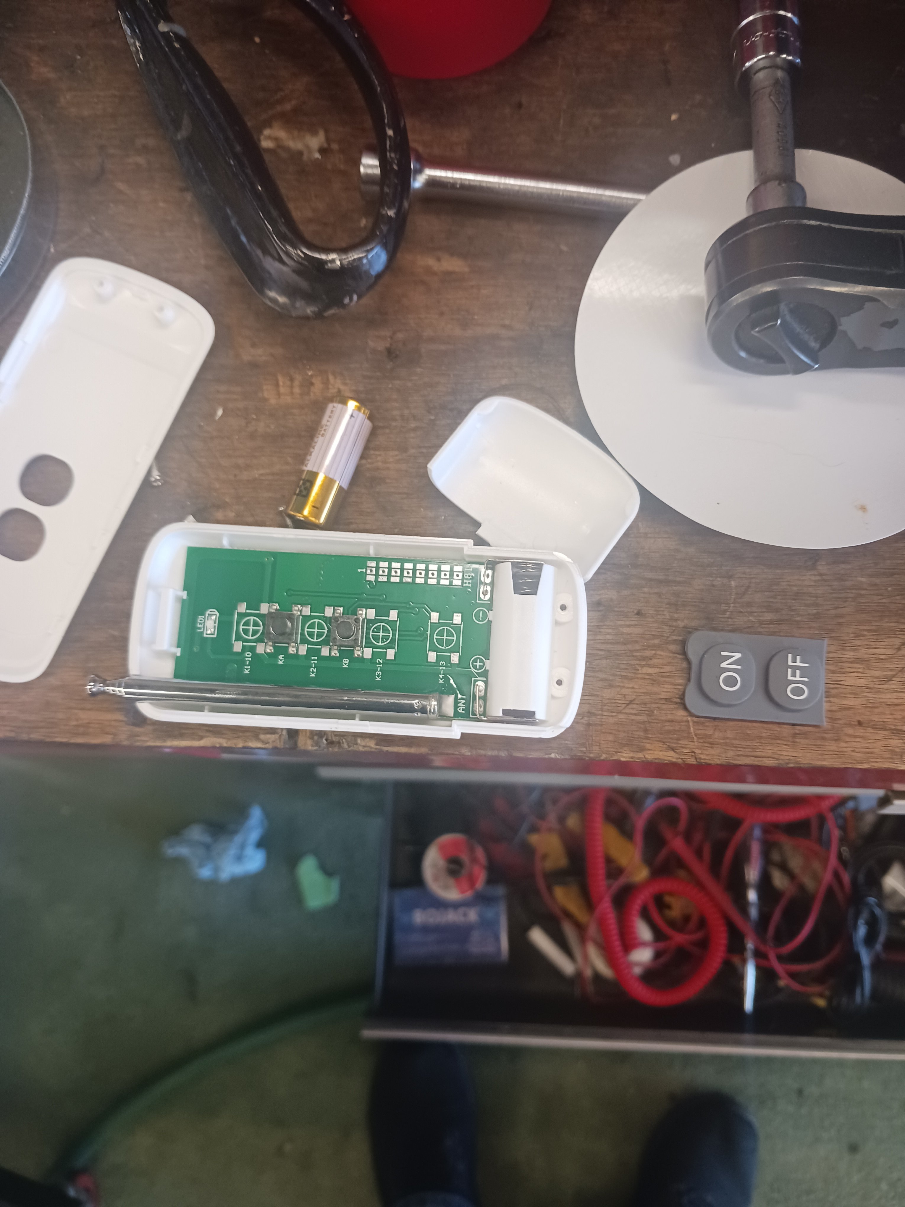

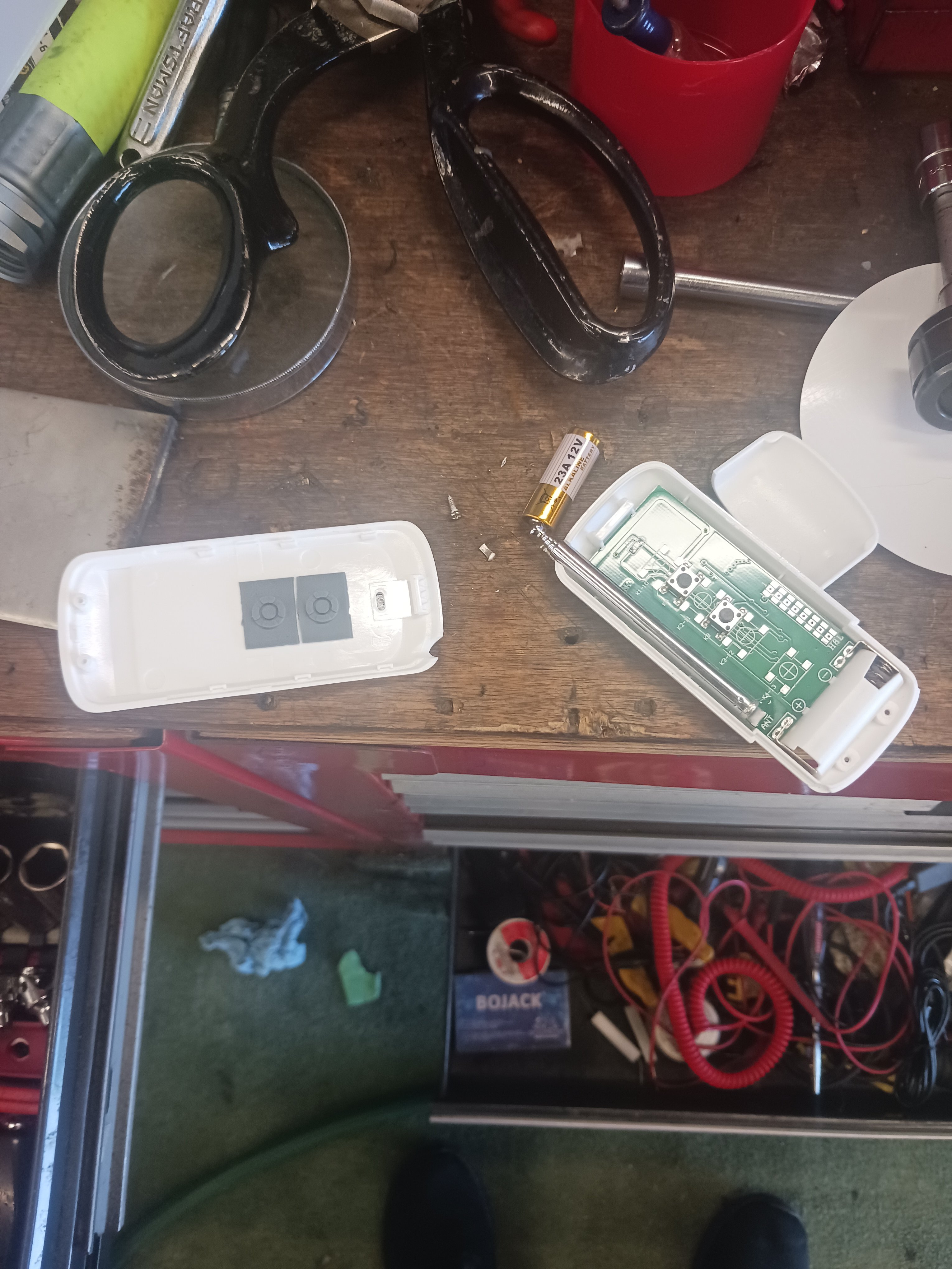

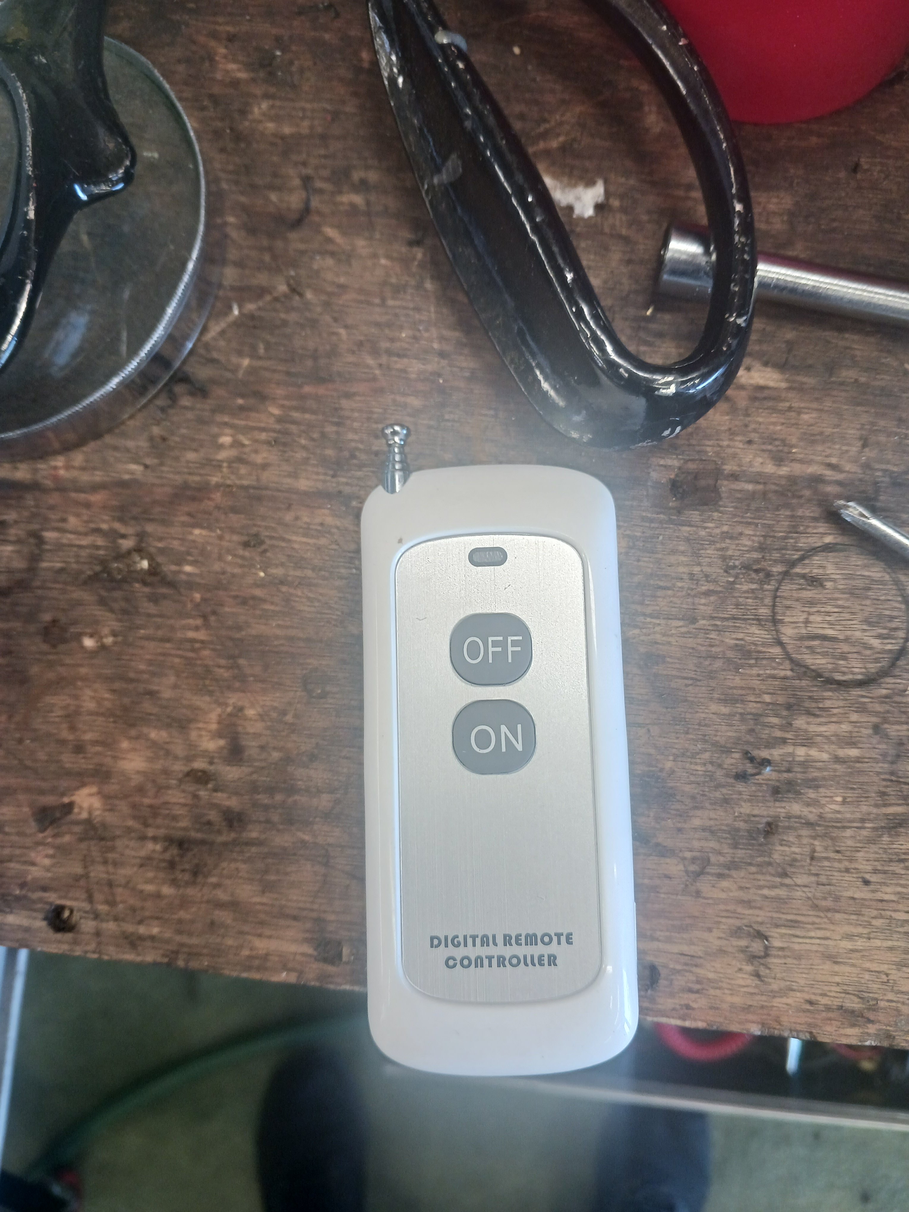

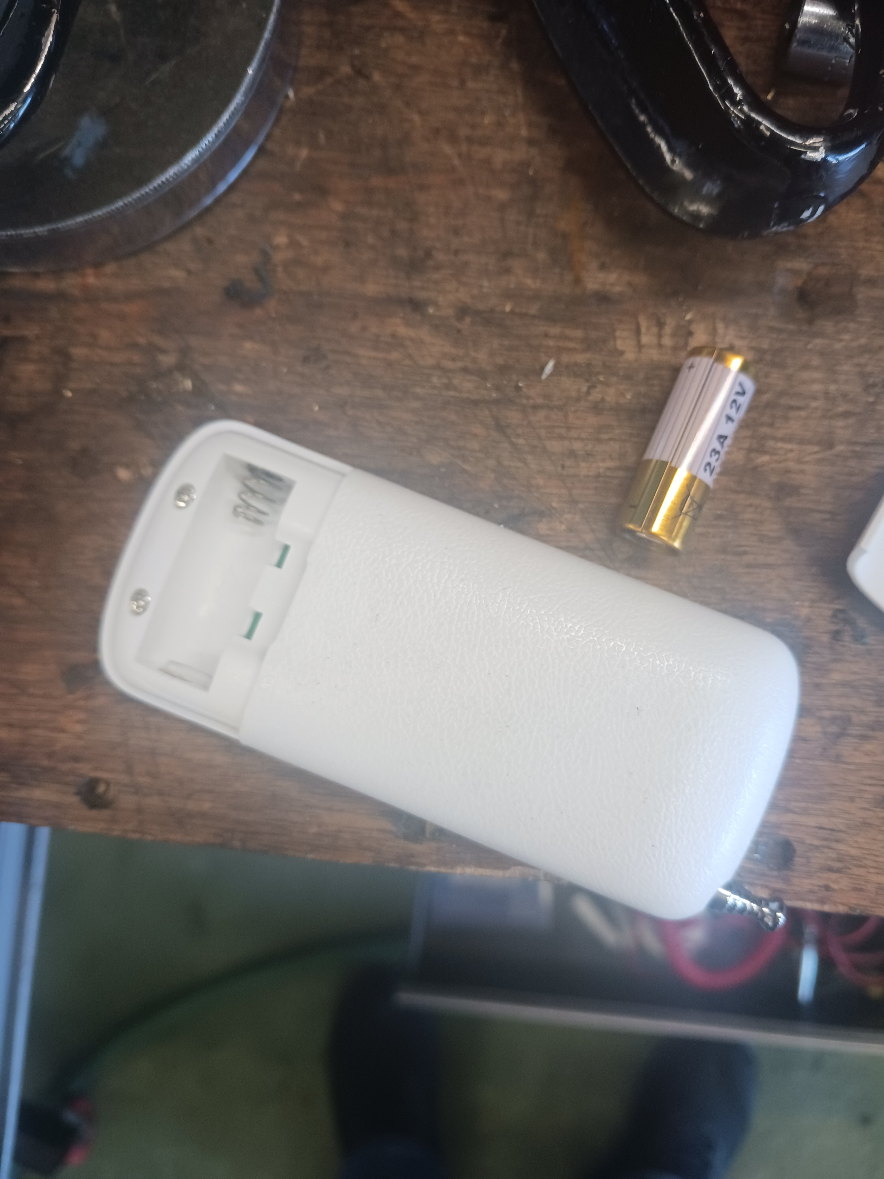

Lobe it love it! Only problem was , the A D D in me didn't like that on was off and off was on but a jewelers screwdriver ,razor blade and 5 minutes and presto! All better off is now off and on is now on!!
