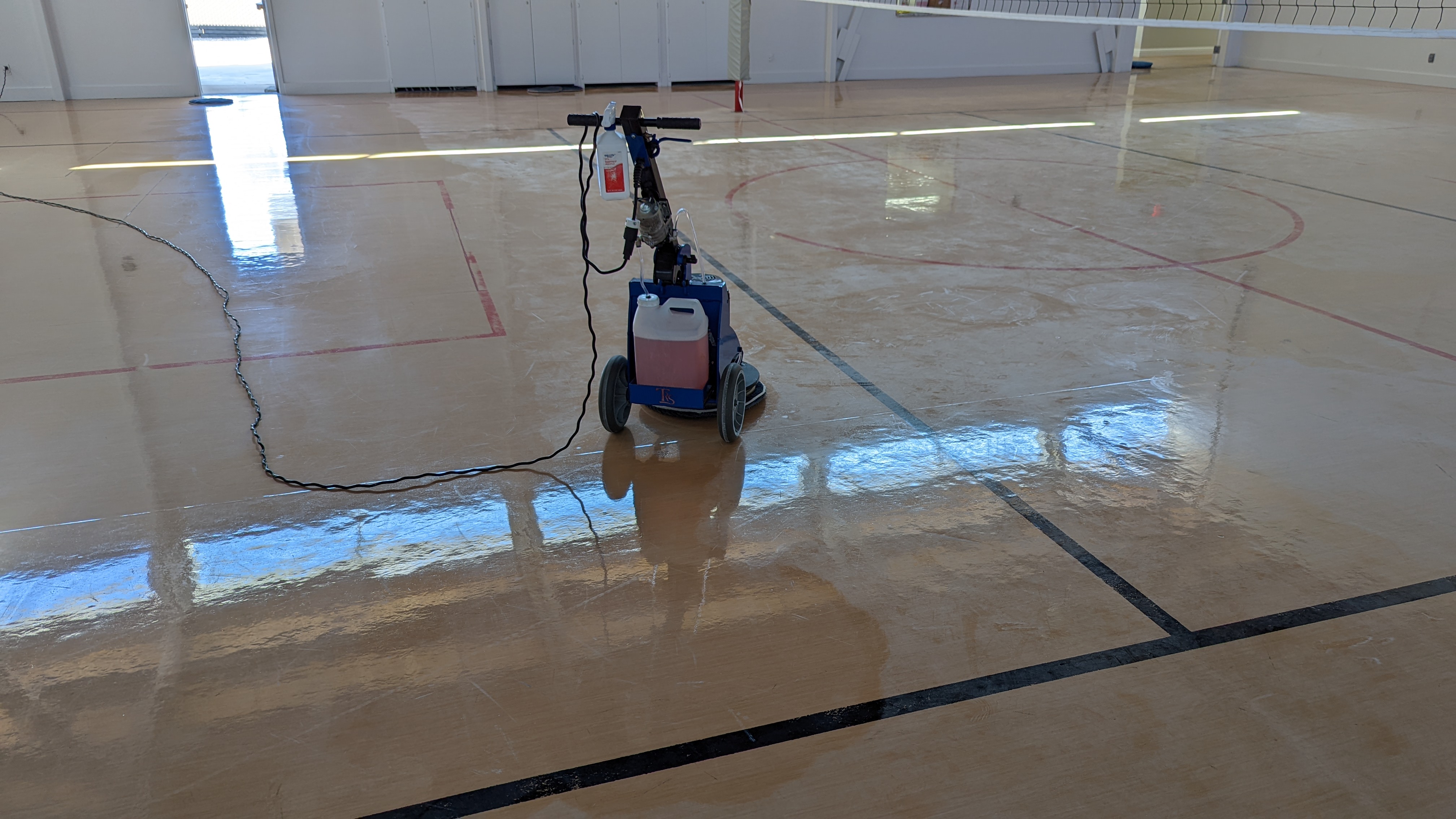

Dry wall dust, paint, goop, splooge etc on the court I just refinished two months ago..
#easypeasy
I'm not a janitor, and don't play one on TV
but how much to rent an auto scrubber?
would it pay for it's self in time and labor savings?
(and according to the janitors here, do a better job)

renting involved delivery from north Carson City, which was $400ish.
I've borrowed used As for a court I maintained in Scruz. Issues every time with the battery.
New is too costly and I have no room to store one

That IS True and I dig it. (Batteries) Scrubbers are like truckmounts, they are for often use and have to be maintained. That being said, your trusty 175 with a tank and some kind of vac, truckmount or set back would Still Be the Ticket.

Why do you think a 175 with a shampoo tank would do a better job than an OP with its built-in? Much better balance wheels down design

Nothing wrong with that, if you don’t have an auto scrubber. However, the WGOP Won’t get bad marks like an 175 and you know it.
