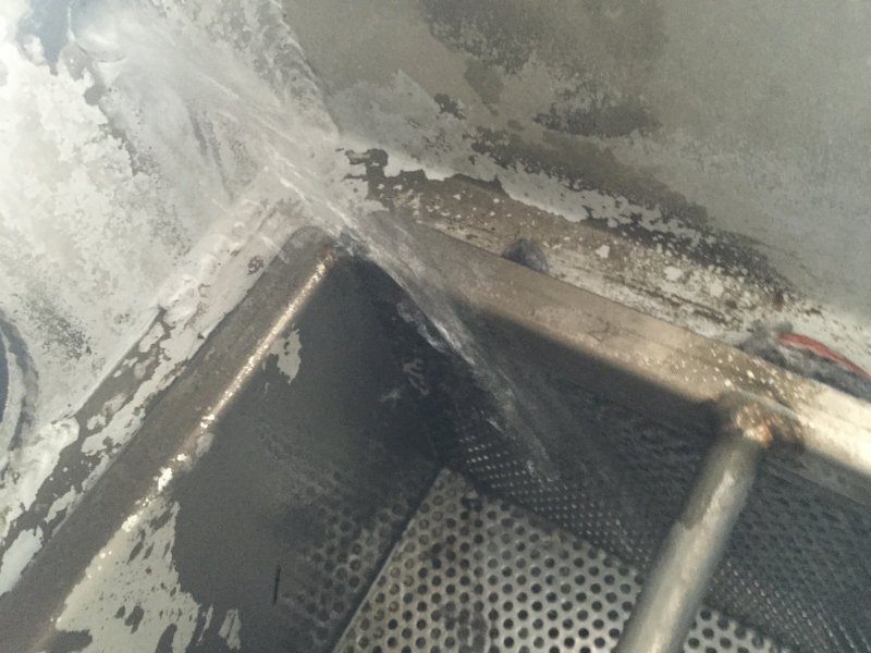

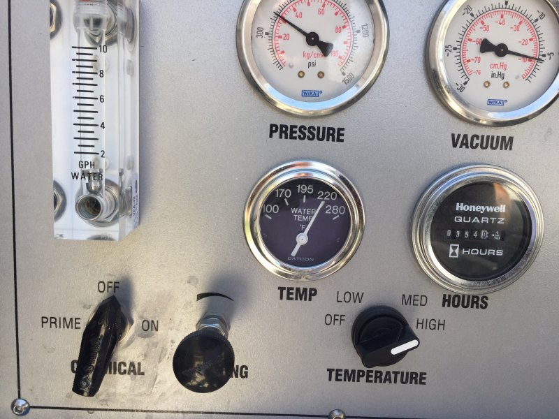

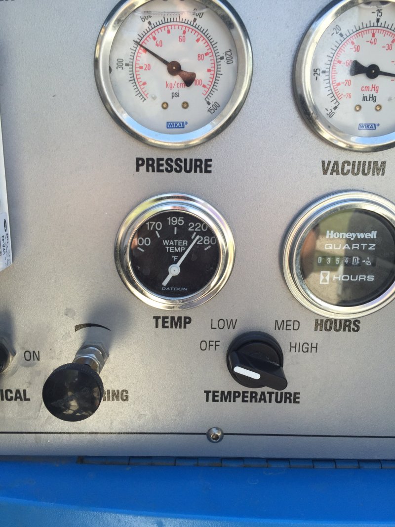

Its constantly bypassing water no matter where I set my temp gauge off low medium high the machine stays about 220 to 240 and bypasses alot like one job full tank.
Had Mitch look at the temp switch, the magic potion had blocked the out bound screen and left alot of white crap so he cleaned it all out said that was the problem. I had cleaned and it was working but He never checked the temp switch which still seam to work.
But as I recall someone else who use RO water says that it bypasses like crazy?

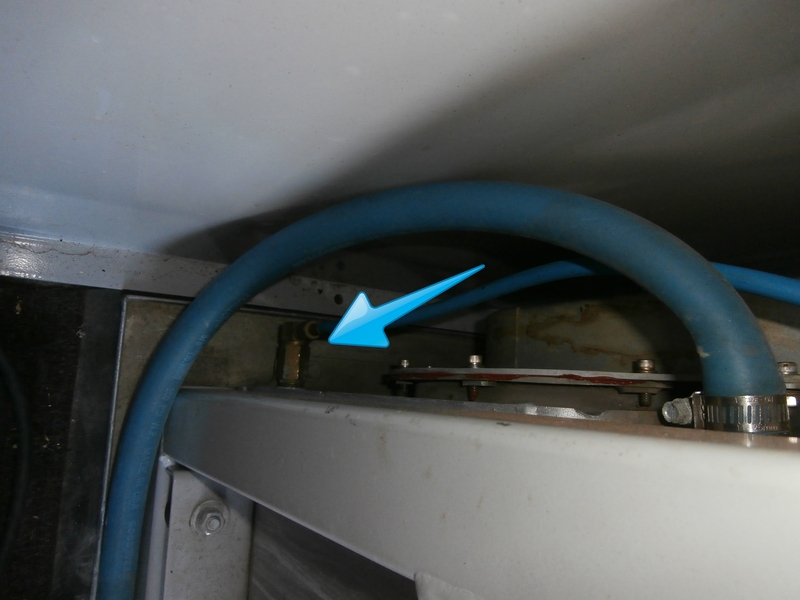

to be honest with you...IMO...I don't think these therm valves can handle the 570....I have been through 2 of them and the one I have now sticks now and then...I know others that have had to replace theres....it is either the location and crap is getting into them and making them stick...or the heat from that box is cooking them...from the 2 I have already pulled...they look like they got way to hot............
I run the exact same one on my thermalwave and I have yet to replace it...
