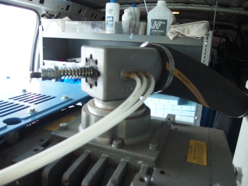

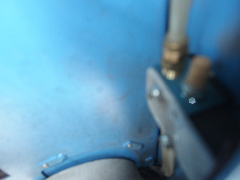

It is actually nothing more then a small pneumatic valve that is located to to the right of the throttle...tucked inside the frame..(Sorry it is hard to get the camera in there)...
when power is sent to it...the solenoid opens and allows the suction to move the Bimba valve....when it closes..the air releases through the vent stone and the Bimba valve goes back...( same theory as the divertor valve on the vortex but a smaller scale )....
or it could be a 2 way pneumatic valve.......

as far as the water getting into the Bimba from the Pneumatic valve....
the air/suction line is attached to the vacuum relief...if your tank gets to full and for what ever reason the blower starts sucking in a little bit of water or foam there is a good chance that the pneumatic valve is getting water from there......

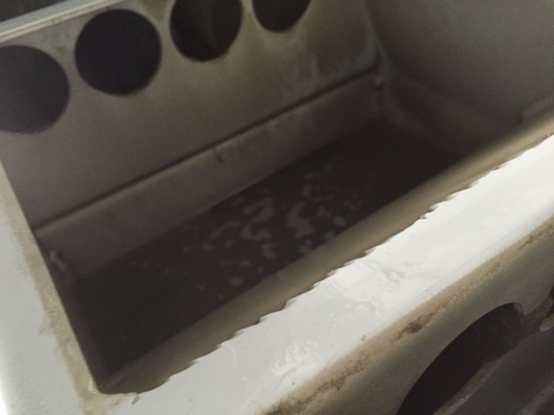

Pretty sure the auto shut off is iffy when it's this full and still running
I am more then willing to bet that because the level is so high that water...and/or foam is being pulled into the blower and somehow into the hose going to the pneumatic valve..probably not a whole lot at a time but enough to get in there over time and start causing a headache....
I have not had a single issue with mine... I am thinking that the difference is that I always pull my APO hose on every job and I never let my tank get full...so the water level is to low for the blower to pick anything......????

Is the water always that high or did the float fail❓The float switch that came with my machine had an intermintant problem. I fixed it and then tested it but it didn't stay fixed. You might have a similar problem. If I had used it I would have flooded my blower over and over. No thanks. And send me a new one please.

another thing to take into consideration is the pneumatic valve is lower then the vacuum relief that it is taped into and water does not run up hill......notice the hoses how they are headed down hill back to the valve......

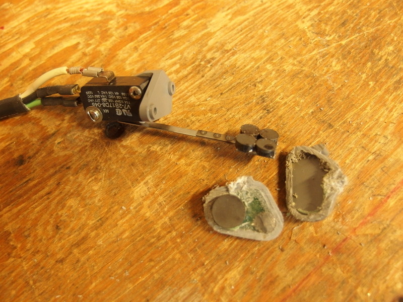

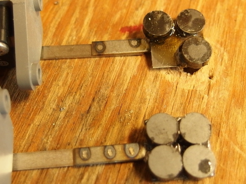

the micro switch is probably good... I am willing to bet for what ever reason the magnets are not making good contact...
I have had one or 2 come in that were weak and when I took it apart it was missing a magnet or 2...
it is getting really hard to trust new parts anymore...never the less...Harwil still has the best ones out there.....
and FYI...they come with the different number of magnets because of the different lengths in the shafts and floats..but when you order a certain model number that has the 4 magnets with the long float and shaft..and then you get the same one but the magnets are not correct..it will not work like it should..

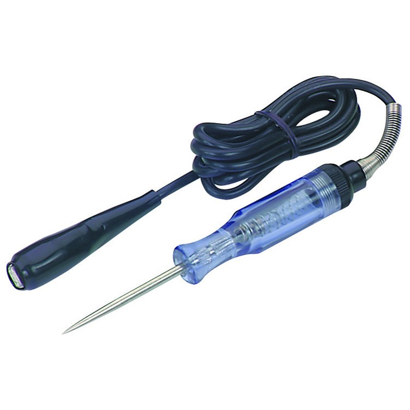

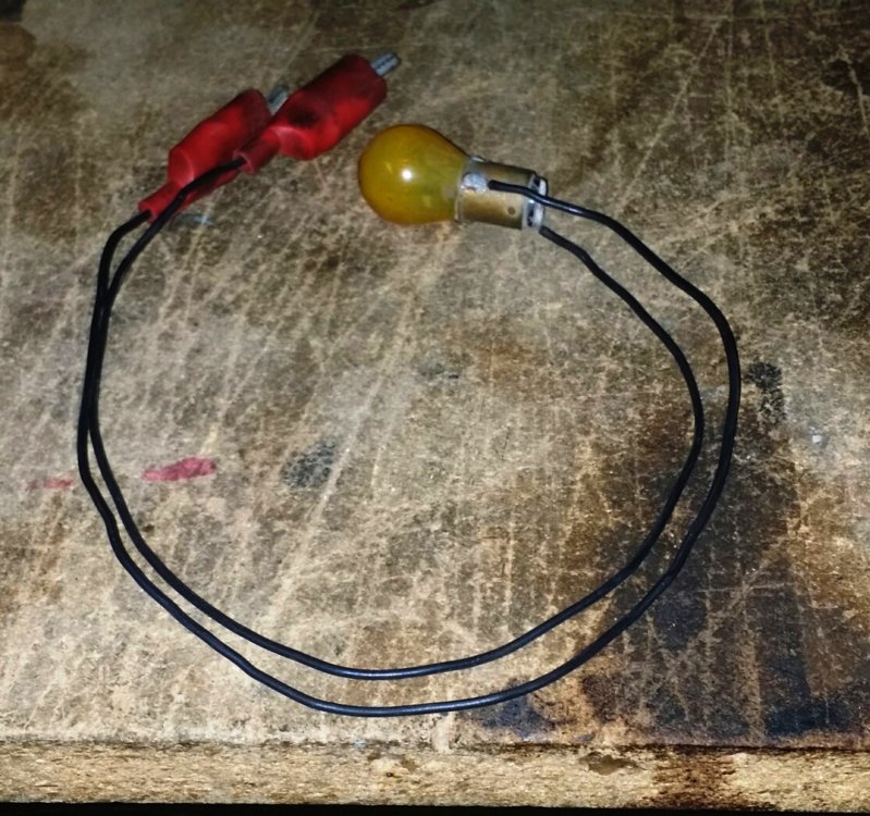

And the obligatory test light. Made this one probably 25 years ago. It draws pretty hefty current (about 2A) so good for sniffing out poor connections - where a meter shows voltage but it drops or disappears when under load:
