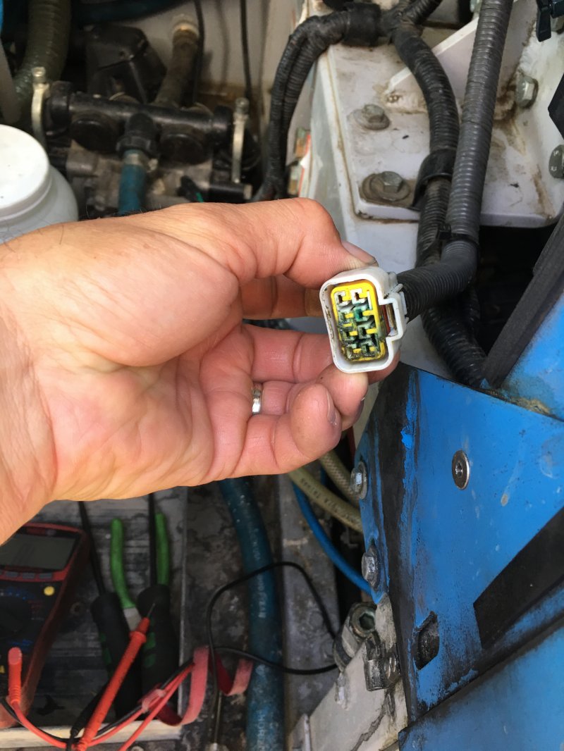

So I posted on Facebook a video with my 570 sounding like a lawn mower.
Ended up being the computer controller and computer harness assembly.
Procyon as a rinse in the jug and for some reason my guy is getting it every where.
The brass pins were completely dissolved.
Ended up replacing the ignition coil to.
