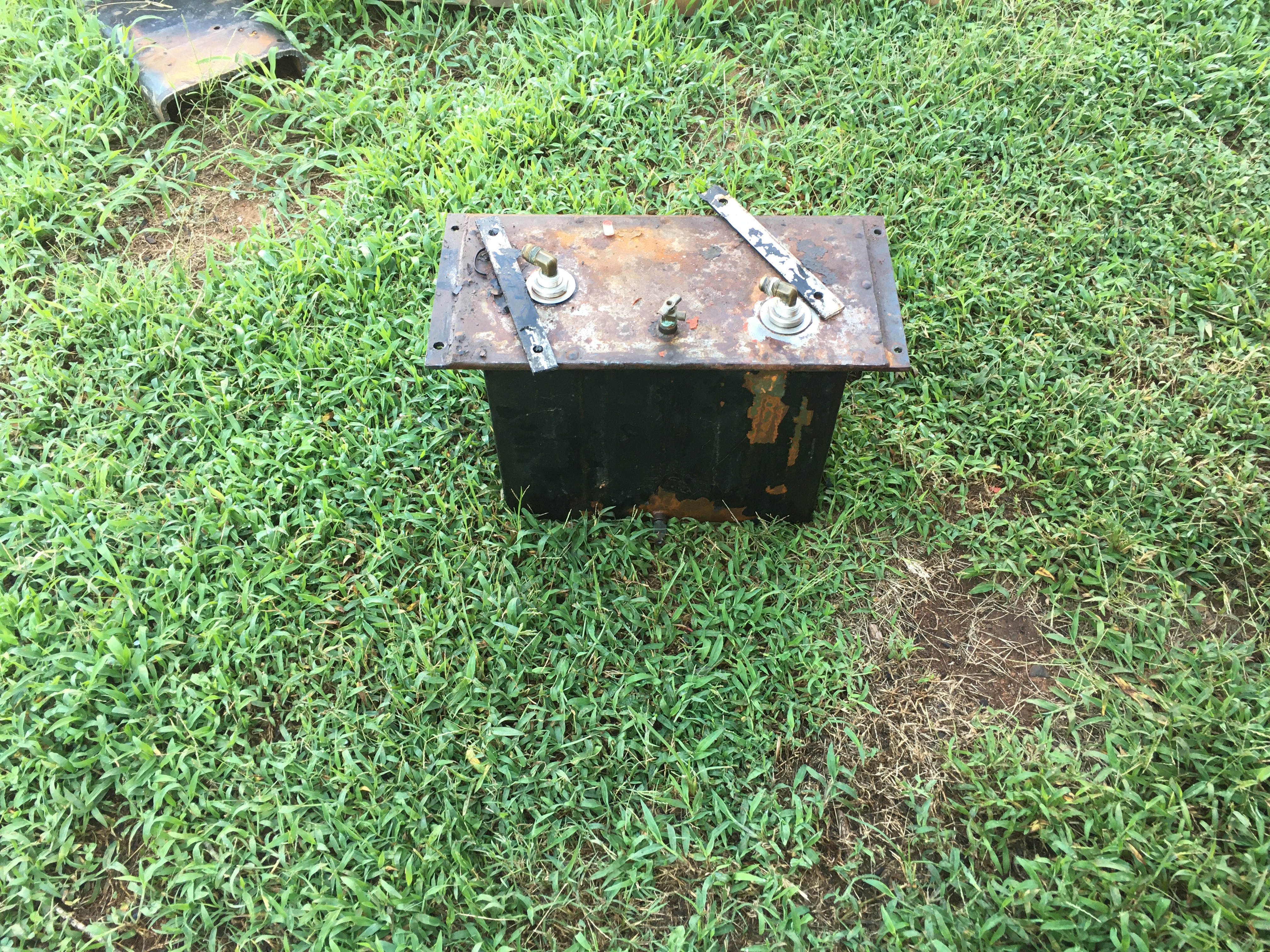

Or you could use this heat exchanger. It’s originally one from my blueline TM2 that used engine coolant. But it is stainless steel fin tubed inside and if the holes were cut big enough for the blower’s exhaust, it’d work just fine.
It might fit if you lay it on it’s side in the port where your round one goes
The reason I pulled it out is because it leaked antifreeze around the stainless steel tubes. It’d be a perfect exhaust heat exchanger. If you have some shop skills and want it, just pay shipping.
