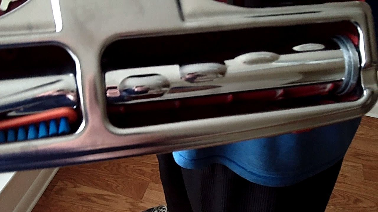

Beater bar / brush roll..... Its the same thing...
I realize it's used universally now but a beater bar is a metal bar that use to be on many brush rolls back in the 70s. The theory was the brush alone wasn't enough to bring the dirt to the surface and had to be beaten like a rug.
I haven't seen a beater bar on a vac in over 15 years. I heard it damages today's fibers.

There's earthquake brush rolls(probably the beater roll, works best with with high cfm vacs..), there soft brush roll, there pet brush rolls, theres cgd brush roll.. many kinds..
I grew up with brush roll and beater bar as the same thing. Even google search cant tell the difference..
I tried to find a beater bar on Google but couldn't.
I was A vacuum repair guy and salesman in the early 80s.

Im surprised that you so called pros dont know the difference. The Beater Bar is there to push the nap down on carpet that has a pad underneath. Then the brush following it lifts the nap. The back and forth motion gets the debris in the airflow and thus into the vacuum bag. However a Beater Bar is pretty much useless on a CGD carpet.
