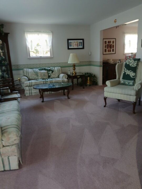

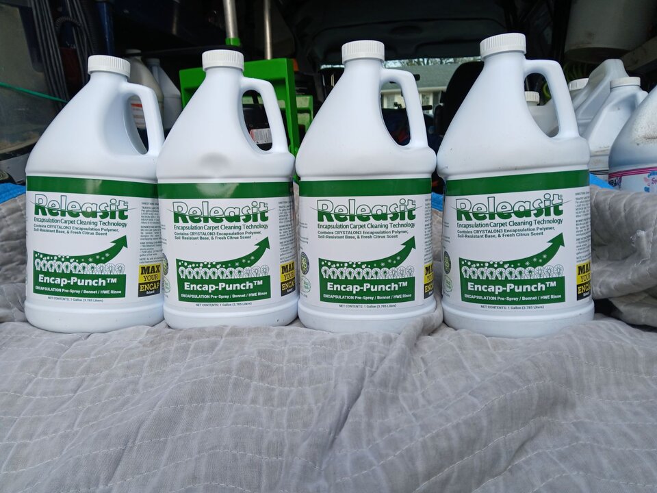

I'm getting excellent results using Releasit Hydrox and Encap Punch on Residential and my Apt Complex
I ordered two cases of Encap Punch but for the second time in 6 weeks Fed Ex damaged something I ordered so I only got one
Yes I know. Nobody cares

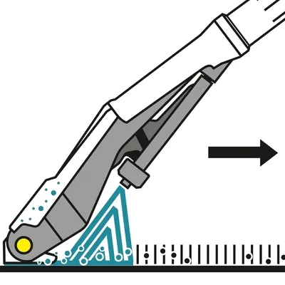

Look at the picture if pictures help with the diagonal jets . Sorry, I couldn't find a video showing how the water is extracted. You seem to be one of those guys that needs picture and video to comprehend

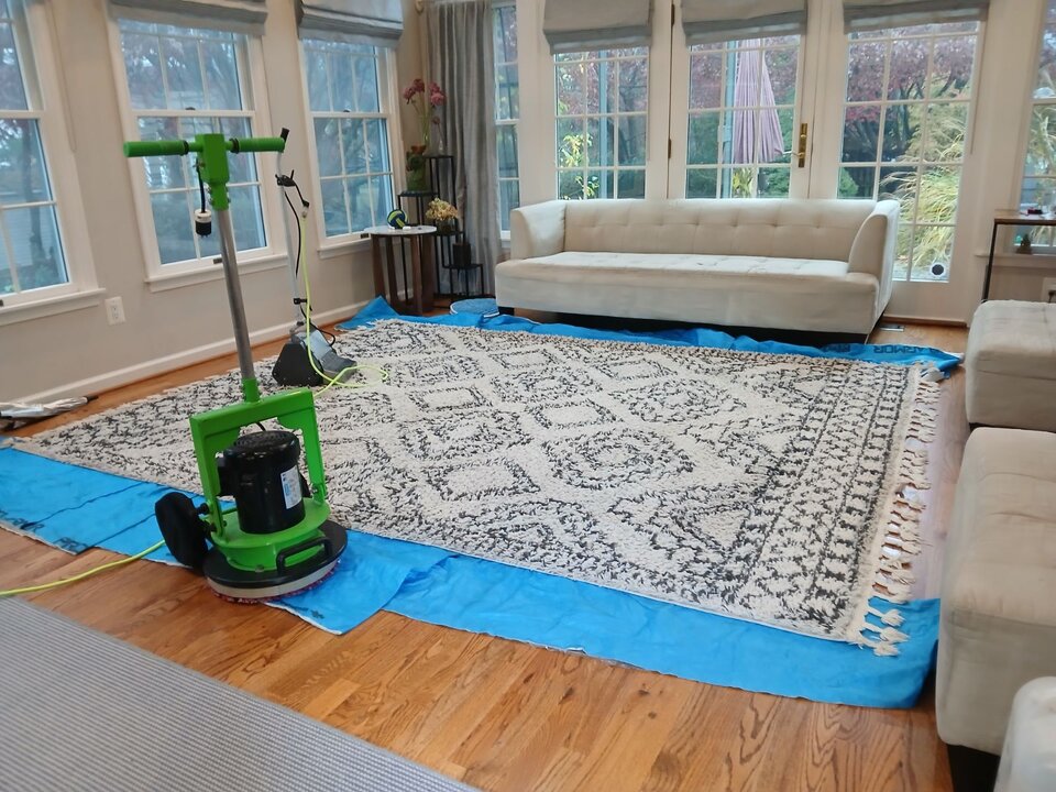

I'm using Hydrox a lot lately at my Apt Complex, on Residential Carpet, on Furniture, and Area Rugs and getting excellent results
That Area Rug was trashed. Customer wanted to see if it could be saved. Yes it was saved with Hydrox using the VLM Method and dry in 1-2 Hours

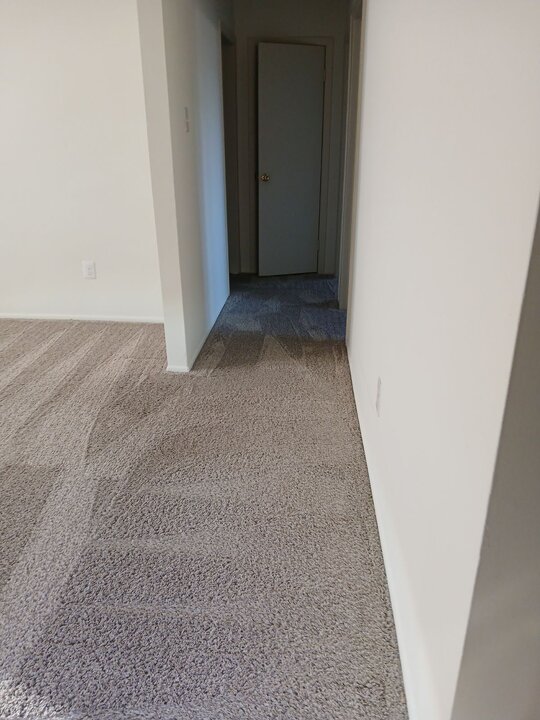

Hydrox is killing it at my Apt Complex
And it has low odor for Residential. Just a nice clean scent
I'm the last step in getting ready for new tenant but you can usually smell paint in those apartments
Fresh Scent Odorcide smells great and would add more to the clean scent and hopefully take away some of the paint smell
I love the Two Bedroom Apartments $$$

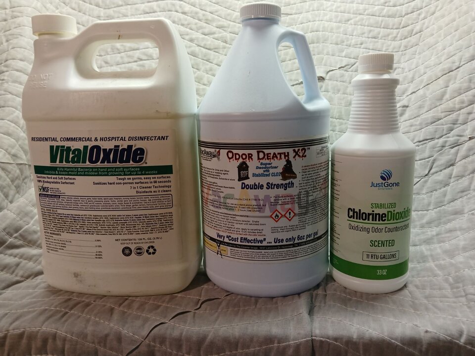

For pet urine and VLM Liquid Stabilized Chlorine Dioxide is a GAME CHANGER
It WORKS !!!
I have 3 Liquids Vital Oxide, VacAway Lemon Odor Death x2, Just Gone. Vital Oxide is CRI Approved
This was a new customer from back in August. She has a old dog 14 years old that she loves so she puts up with the pet stains and odor
Did this again yesterday. She said the first time I cleaned it she was satisfied so she wants to do it every 3 months
Spray down Just Gone heavy first and then thoroughly scrub with CRB with Grey Brushes
Then spray down VacAway Double Trouble and scrub with CRB with Grey Brushes
Thoroughly extract changing bonnets often with Tankless Vibe and 3 weights on each side for better absorption and thick Light Blue Microfiber Bonnets
3 weights adds 24 pounds of head weight
I put my head down to the carpet after cleaning and I couldn't smell anything
There was pet stains near chair that I couldn't see without my Head light, that disappeared after spraying down Just Gone. I wear a Light on my head that shows up everything
I told her the TRUTH about urine in backing and padding and the only way to remove 100% of the pet urine and odor is to replace but this will help the situation. She understands
