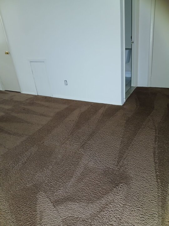

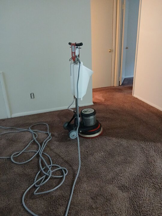

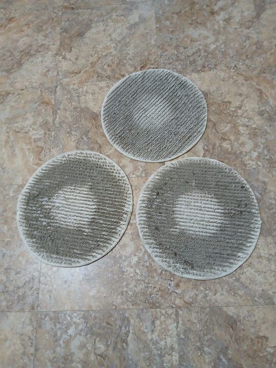

The first time using my 175-300 putting down solution from my tank was a total success
I just used 175 never used the 300
I used 14'' Red Pad on 14'' Driver to scrub and extracted with 17'' Ironman Bonnets. I used both sides of the bonnets
10'' CRB to groom
I used 5 oz of Carpet Details No Peroxide
I love VLM !!!

WOW!!!
Look at those pads!!!
But where does the dirt go????????? LOL

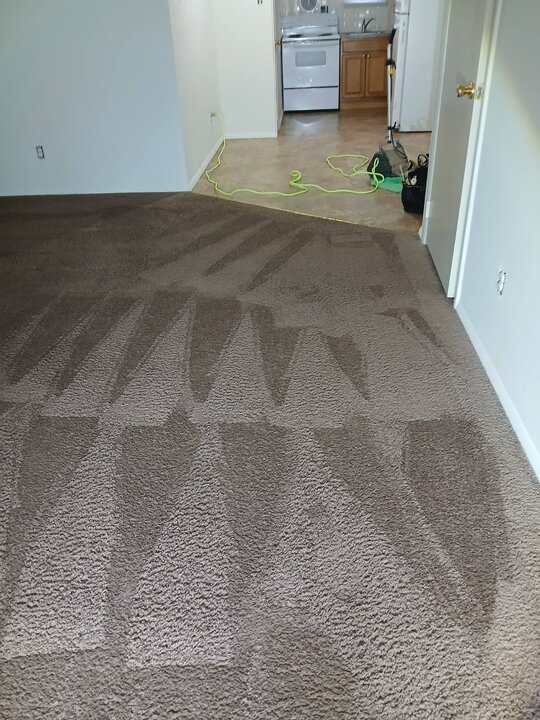

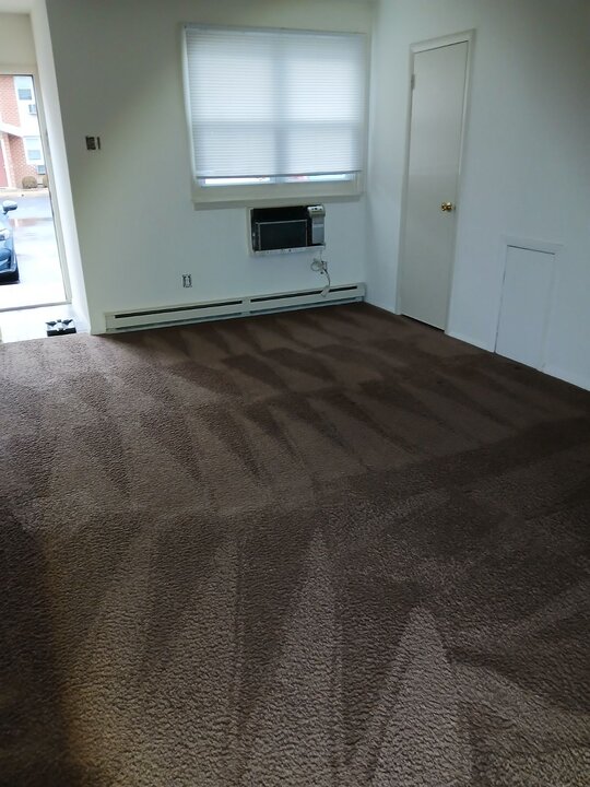

George,
We have, been doing it all wrong?
We need to flood the carpet!
Soak it really well!
And then put 10 or 12 DRY STROKES on it?
I think I finally GET IT!!!!!
I see the Light!!!!!!!!!!!!!
Yea another HWE Guy that's ANGRY
It's not about Corn Rows
They HATE learning the TRUTH about VLM
And SEEING the TRUTH
I warned the HWE Guys that have BLOOD PRESSURE issues to ignore this thread
I love VLM !!!
