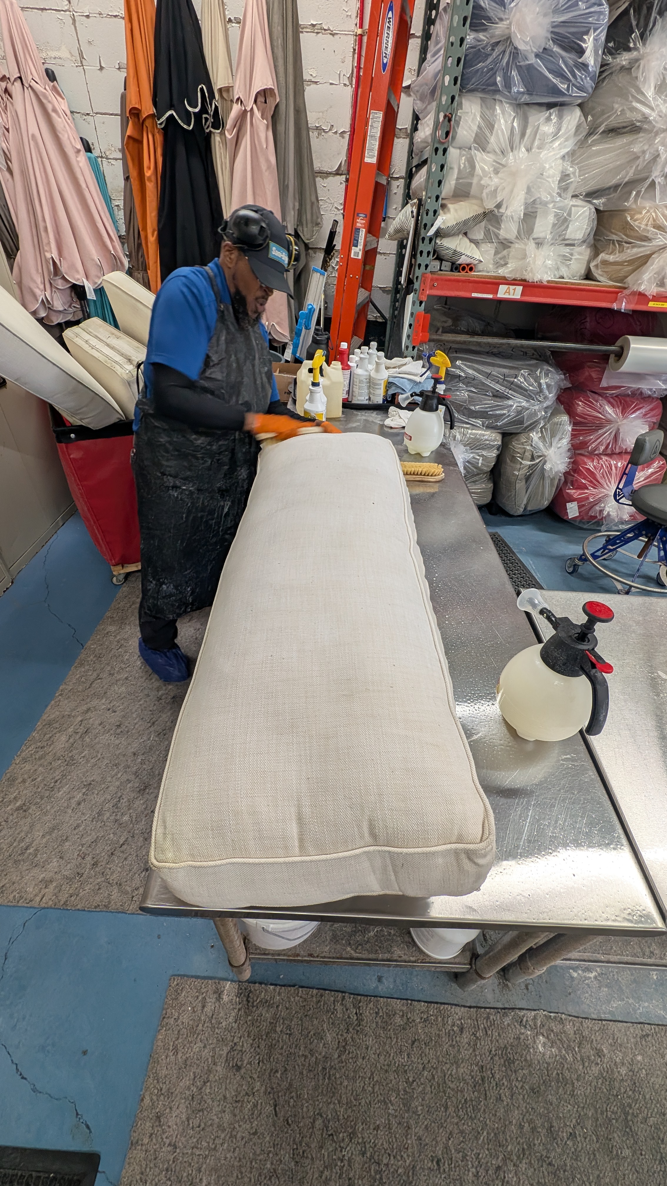

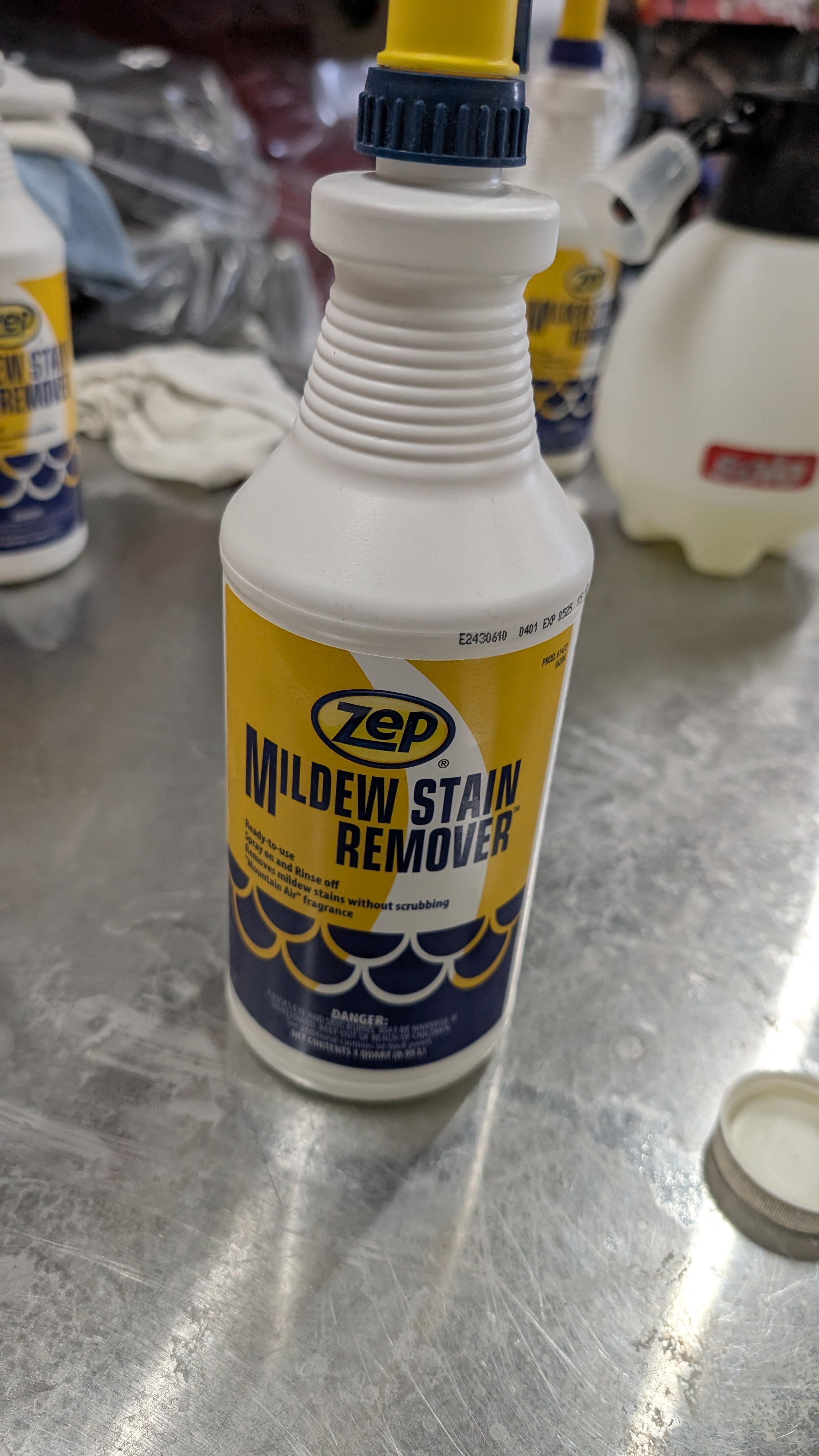

Zep mildew stain remover. Miracle in a can

And is that Zep a chlorine or peroxide based mildew chemical?

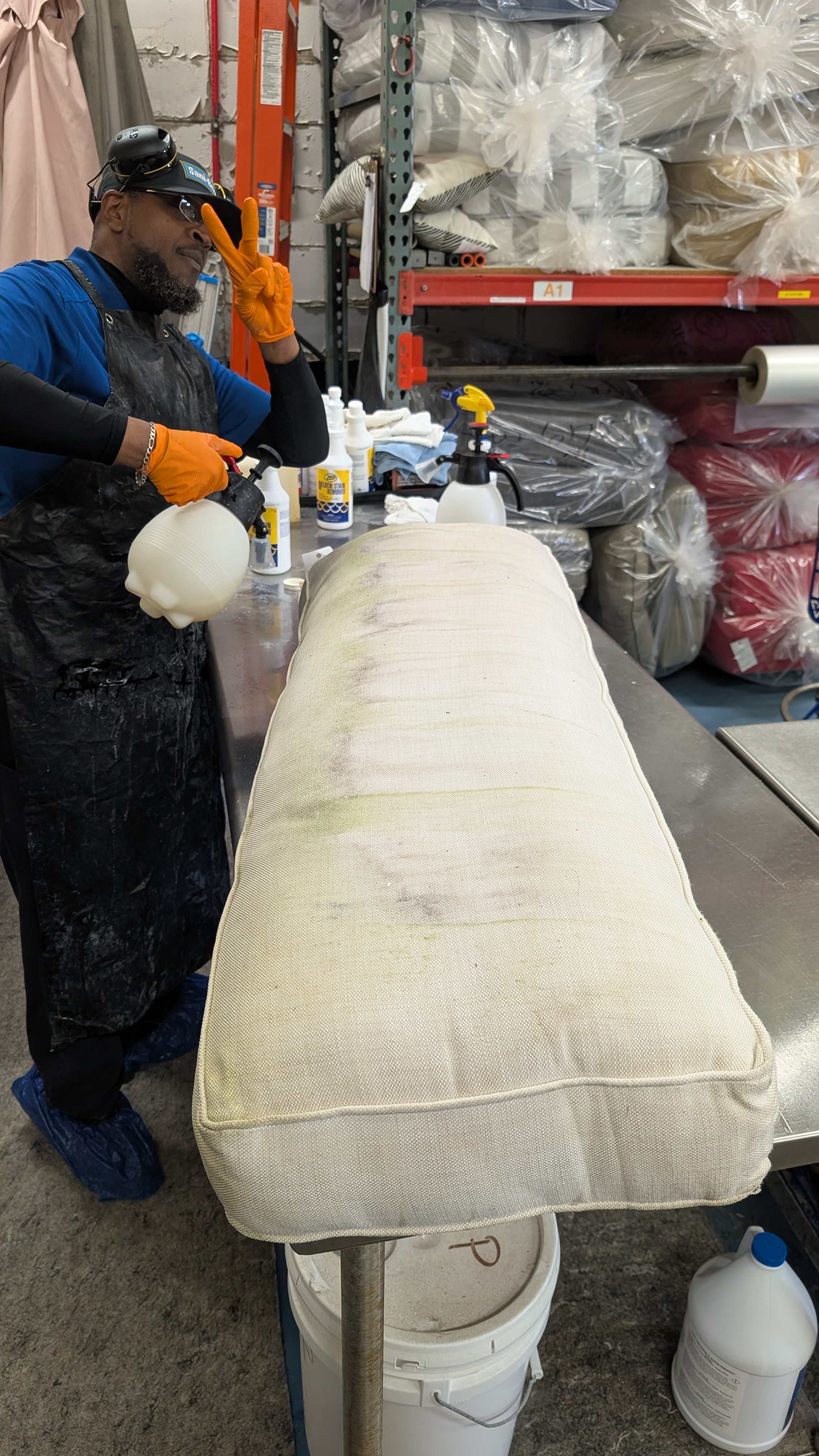

Oxy encap here for the win , spray on use a hanD bonnet and extract
Nope. I’ve used straight peroxide (a very high concentration; 20%), and used straight DS2, no dilution. First used an upholstery bonnet, then to a stiff scrub brush….
It was used in that fashion, because I was desperate to see an acceptable end result. It did not work.
Diluted oxy-encap would not take care of moderate to severe mildew….
I finally got good results after using ammonia and Fels of all things, scrubbed with a stiff brush.

Yupp I used 40 straight let sit and then a meta bisulfite rinse, they popped nicely but still have stains
