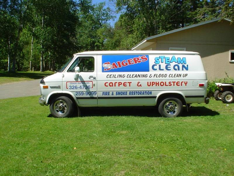

I have one of our old 93 GMC and Butlers showing up today at my shop. Over 260,000 miles on the van and original motor and drive Trane, as well as over 11,000 hours on the Butler unit. That's about 593,000 miles on that ORIGINAL motor. Transmission is also original.
For the rest of the vans, we have the oil pans dropped and filters and oil changed as well as any differential fluids done the same.
Lot's of maintenance will keep the heart of the unit going.
In the cat pumps and blowers, 500 hours is the recommended time for changing those oils, we change them around 300 hours.
Our opinion is that the oil is cheap, and keeping it fresh makes the things last!
My old High School Band director owns this thing now and cleans part time with it.

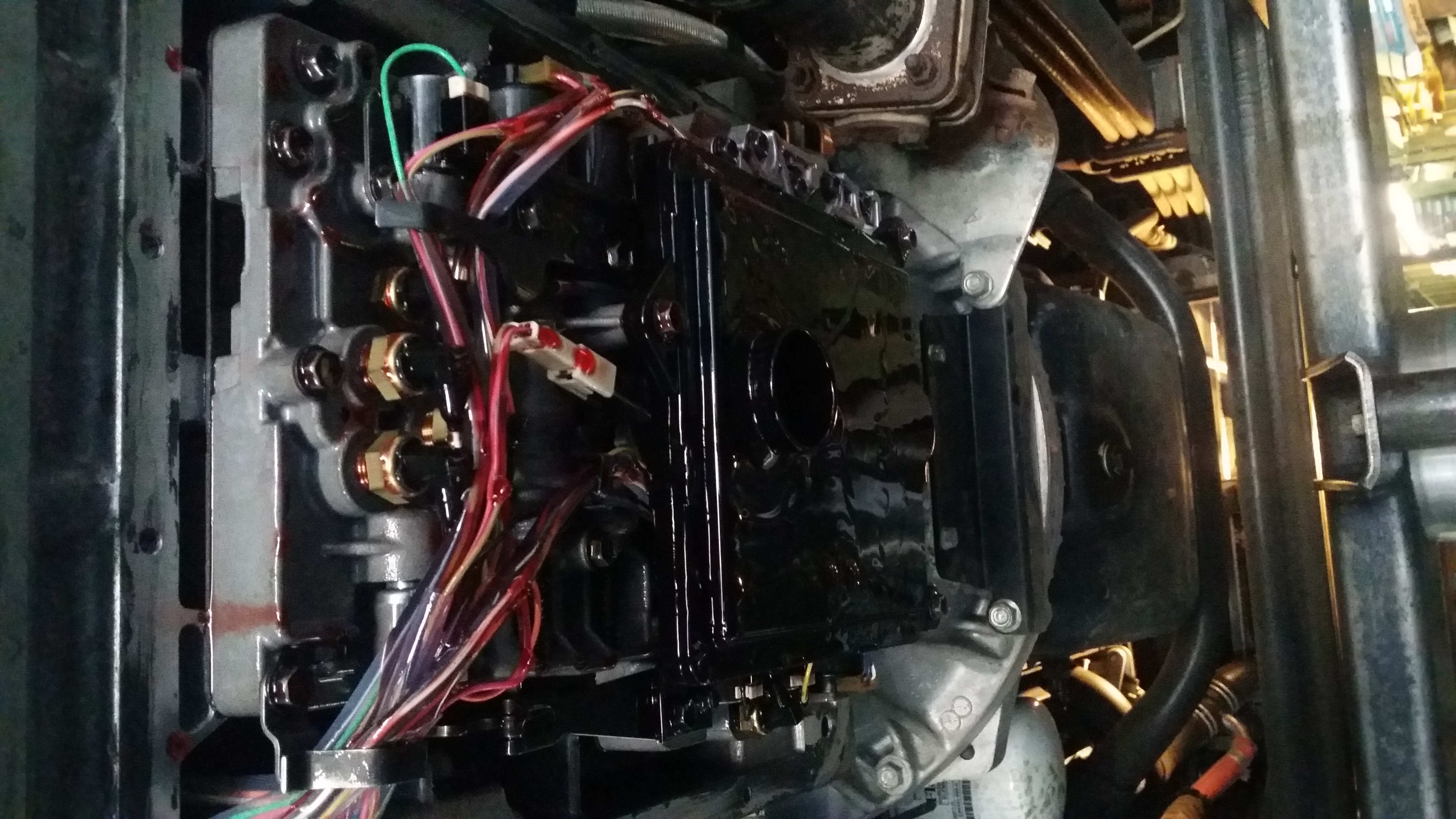

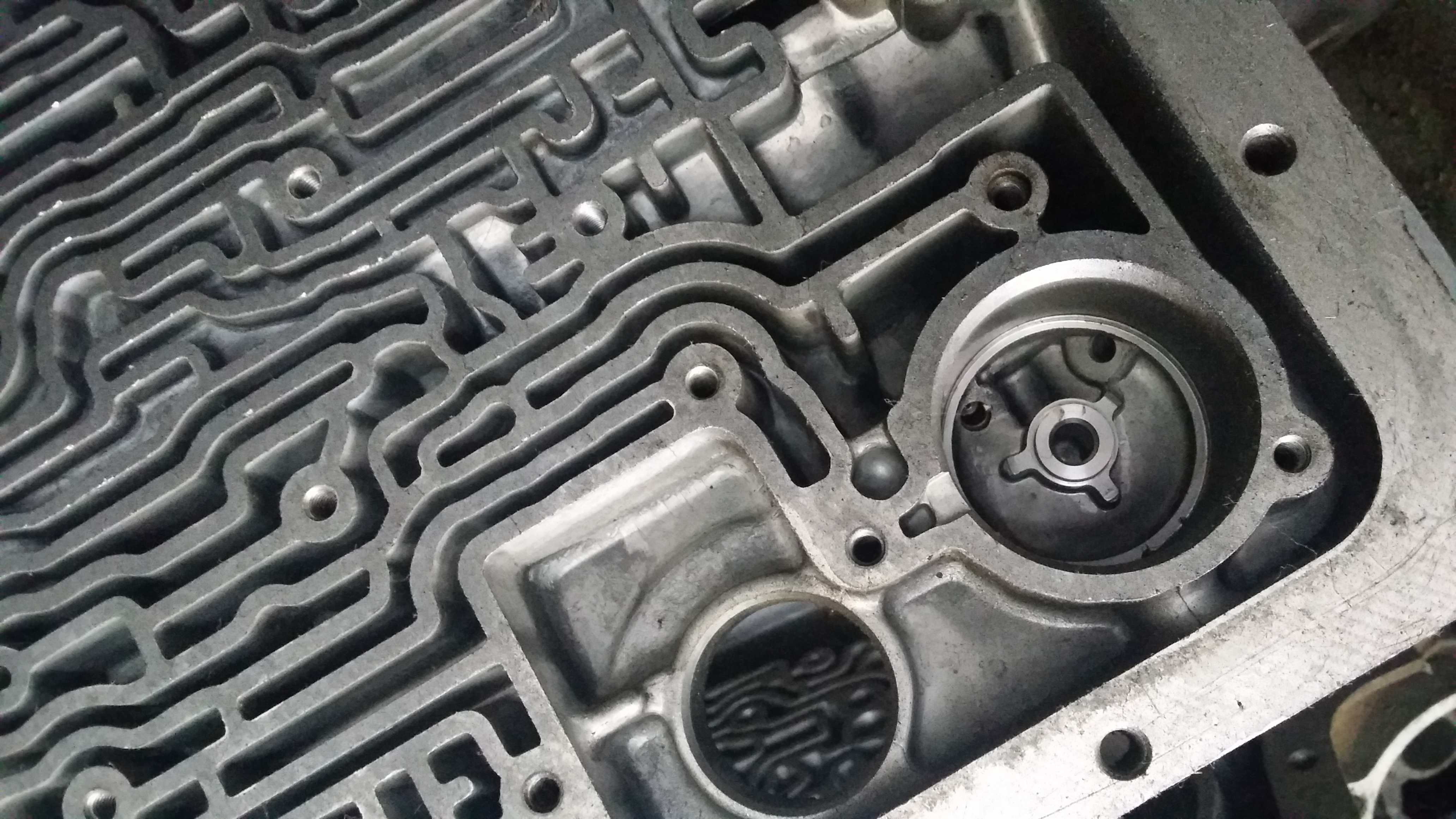

I go 100 hours on mine.
At the tranny guy now getting a full service, flush and filter
$250 worth of fluid alone..yikes
Ever seen inside an automatic transmission? (Not mine)
