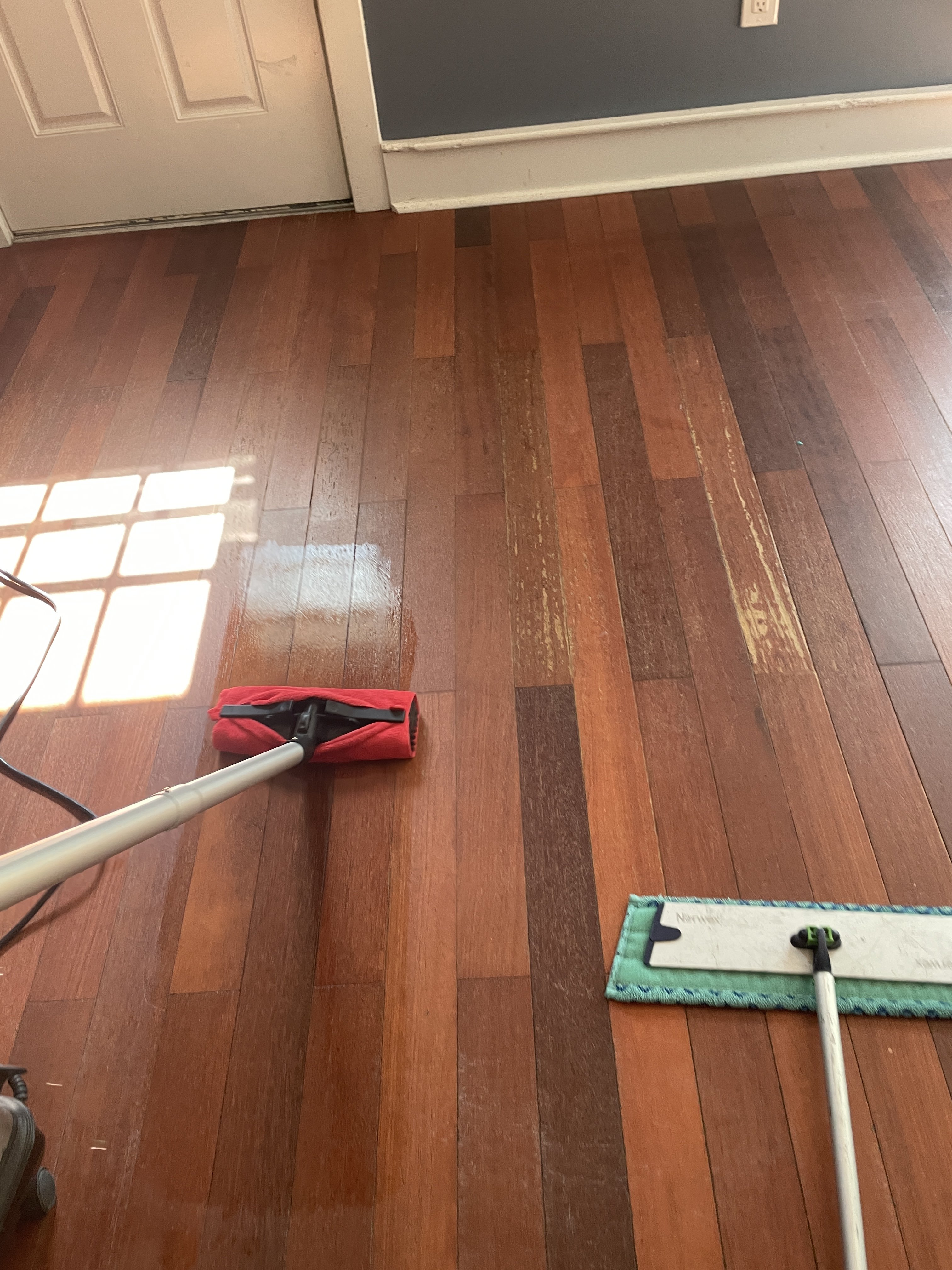

Was a fuse blown. The bottom of the unit had moss and was pretty dirty, around the fins. I sprayed with garden hose and sucked with truck mount and cleaned it up nice. Been running all day. it is 19 years old.

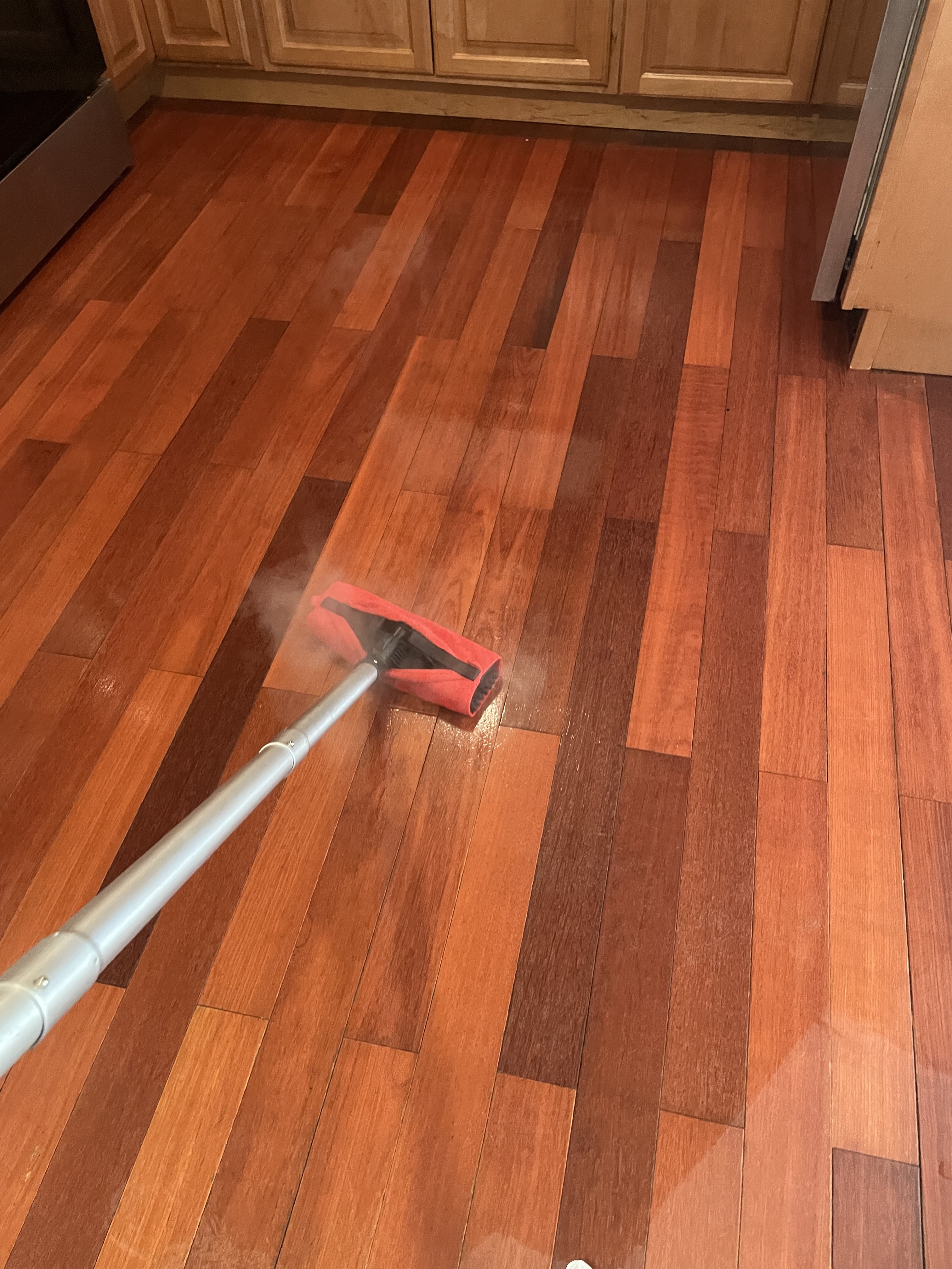

I'm wouldn't steam it I would mist on a wood clean crb it or use a 175 then extract only with the tile tool if you wand to raise it up and mist the floor lightly and extract and drop fans

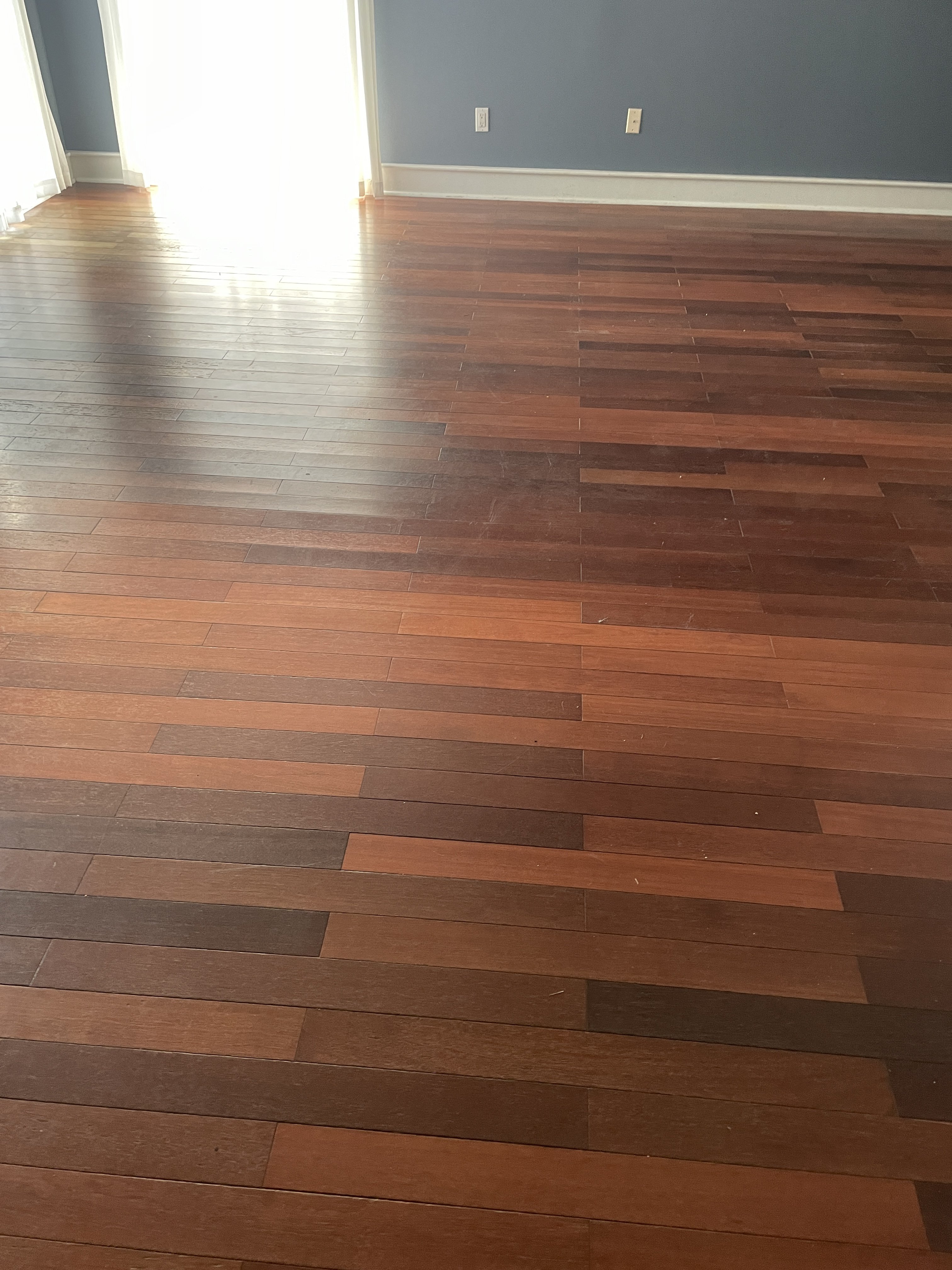

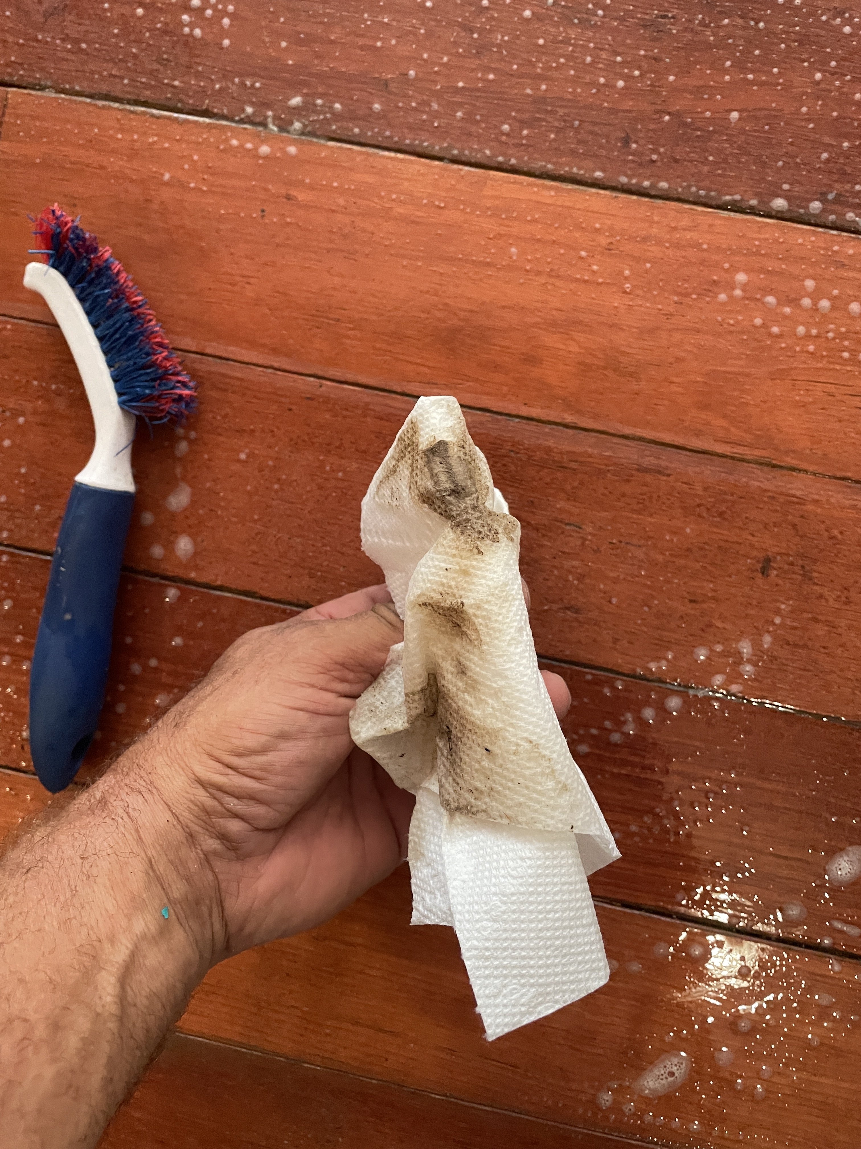

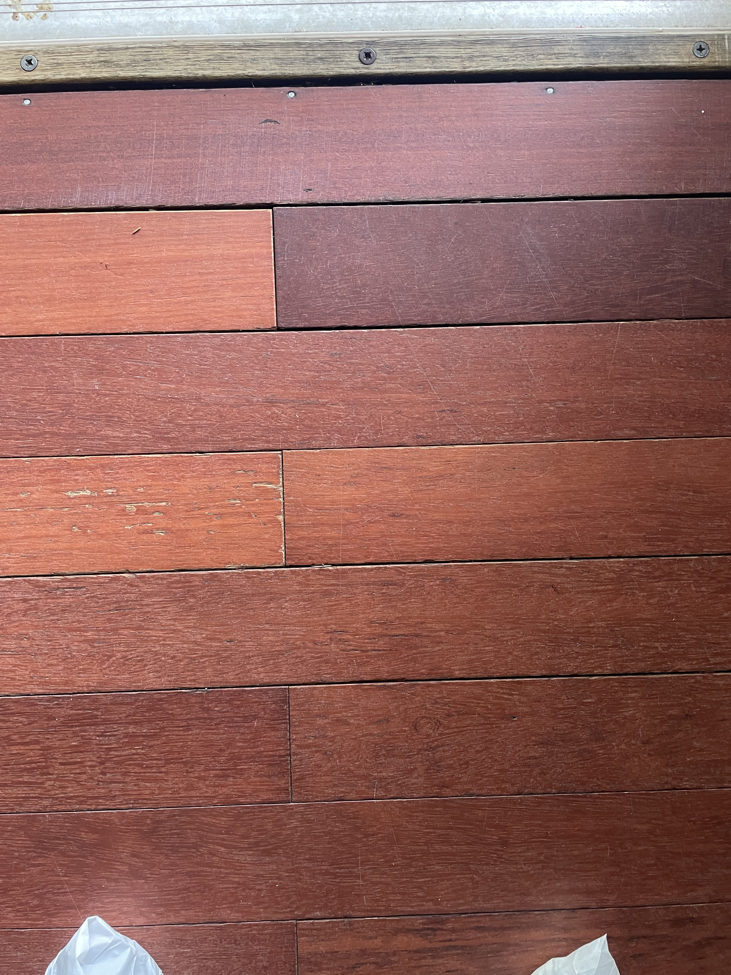

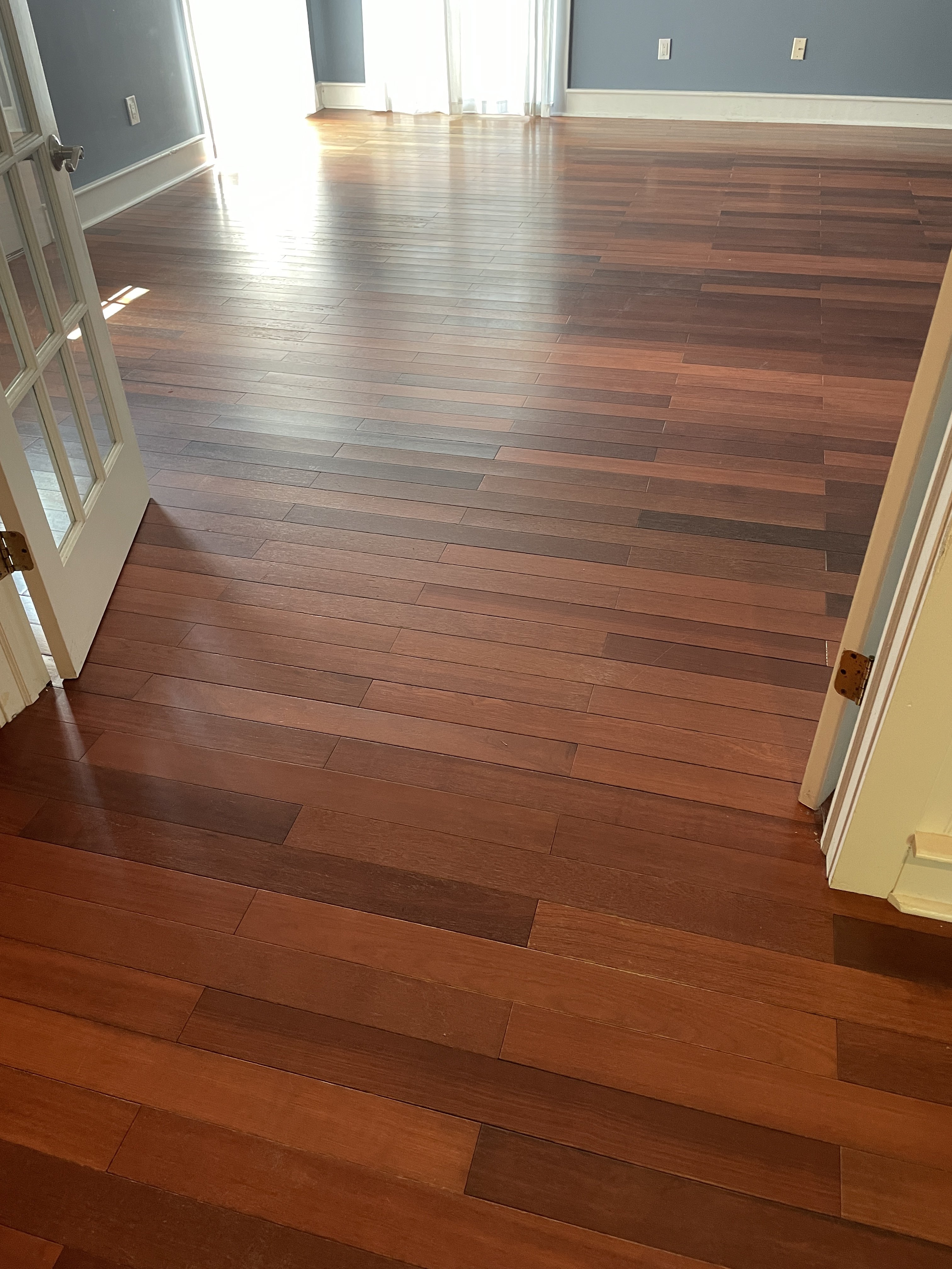

I can see how that can satisfy a customer. Im not into "letting things dry" though. I believe there is a lot of good cleaning results by force drying. Whether carpet, tile, or wood. Fans and microfibers finish the job for me. At times I towel dry staircases and entrances during and after running fans.
A combination of being busy and solo, I can't get into mopping techniques for results. Any other cleaner can do that without the commitment of a truck mount. If I pursue this sector of hardwood, I will get an OP, but would like to see it in action and learn it over the slow winter.
Really all I was doing was cleaning a gross floor. I stunk. And it was already buckled and needs to be refinished. (Just hope im not the guy paying for the refinish job 😅). Didn't lose any sleep but will be relieved when I get a text how awesome it came out.

Honestly I was giving a quick way to do something more of a bandaid hoping you wouldn't steam it with the gecko wand.
But yeah that floor is shot.
I would usually use my vibe and a bonnet with a neutral cleaner post pad with a white pad.
But that's just cleaning.
I've done a couple wax removal on wood it's a pita.

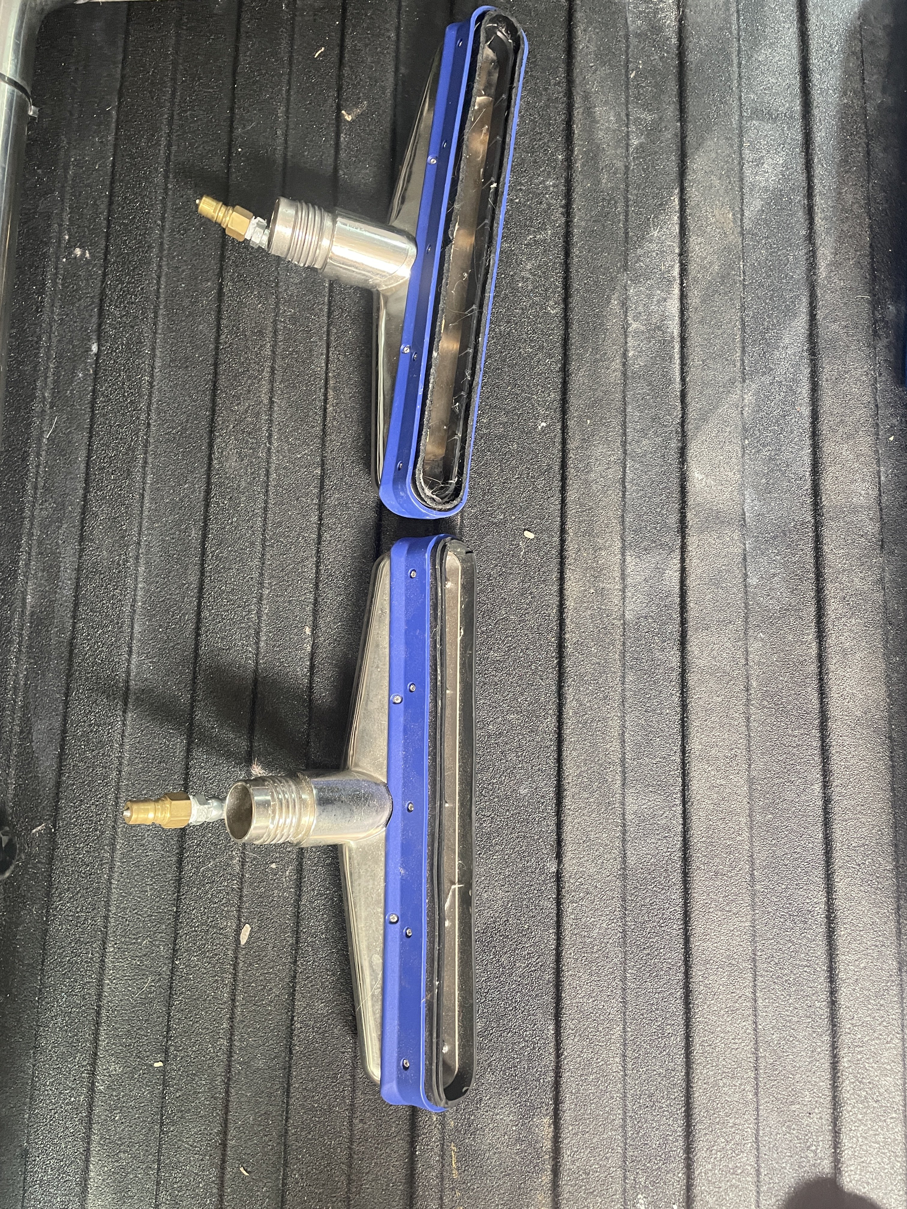

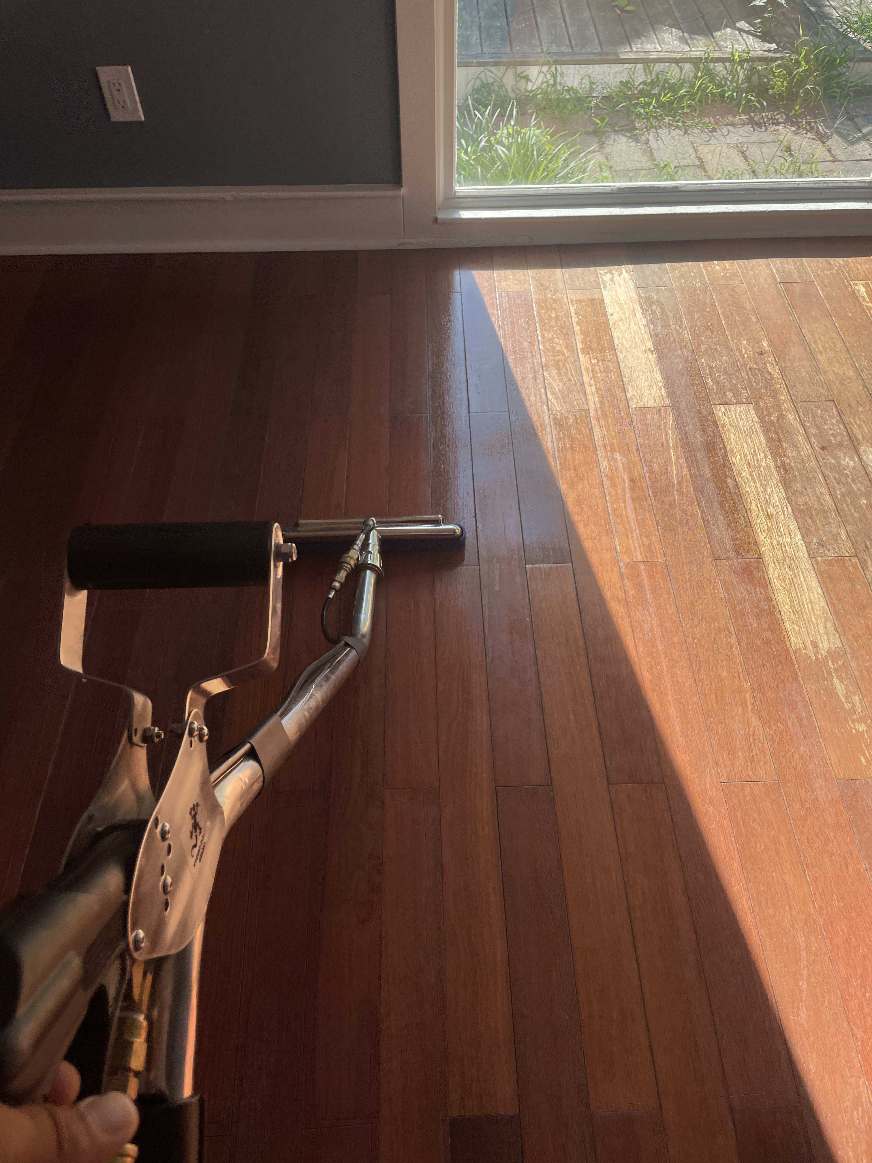

I use my hydroforce tile wand on wood floors occasionally. It works great. Just have to do extra dry strokes.
It makes dull finishes shine again if there's still finish on it.
Yeah but OP the way to go if you get serious about it on a nice job. I finally got the word that my job was good, but have to admit I was thinking about it ever since I did it. Probably will still hook up the truck mount for the intial vacuum, but I won't touch a "real floor" until I get the OP down. I just take the ones that already are beat.

I had trouble with the edges fine cutting the pads and bonnets causing more issues of lint or dust getting back in the gaps.
Just wanding has been working good.
Better than lugging the buffer too. Imo of course.
