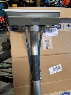

I took that stance too. I have a Prochem 3 jet wand (an oldy but goody) and put a GreenGlide on it. Loved the ease of use. then it wore some and got loose and fell off. I used it unglided and thought it did recover more water (dry faster) and agitate better even tho I use a CRB. So I used it that way for a couple years. When I get to one of the carpets where its hard to push, I just slip the slotted glide on it. I did find that there really wasnt that much difference in drying. so I only use it when I need it.
I did try the Devastator wand. Nice tool and did get the same drying times. Didnt like the swivel (yah I know that you can lock it but why pay for it then?) Still looking ... Been eyeing up a Mach 12
Would be nice if there was somewhere you could go and they lined up all the wands and you could try them all...

I have the mach 12 and it is a good wand. The glide is flat and provides a good seal on tthe carpet. After using Tom's 12 inch wand in Phoenix, everything else pales in comparison. The swivel is great when cleaning under beds or other large furniture.
