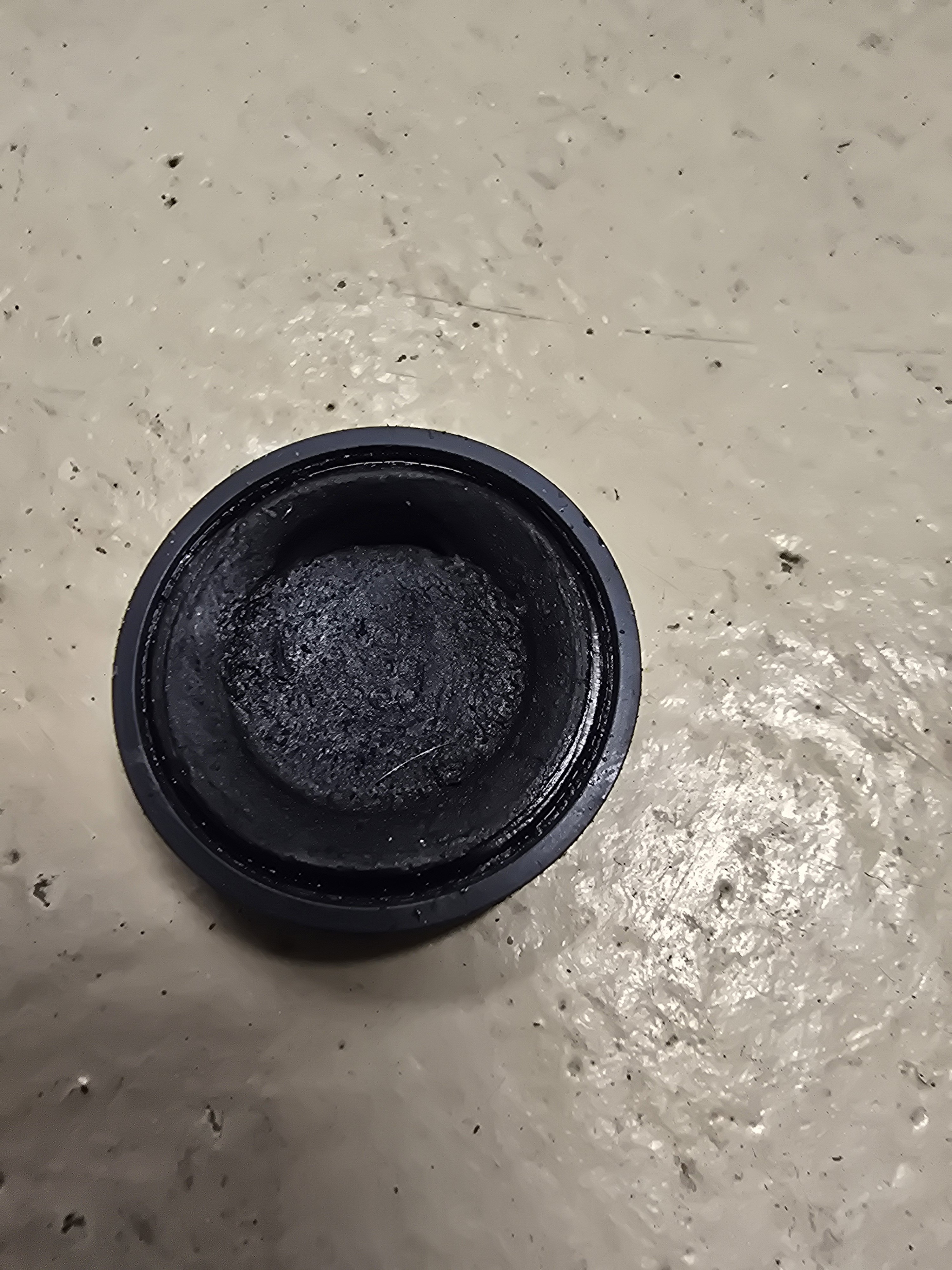

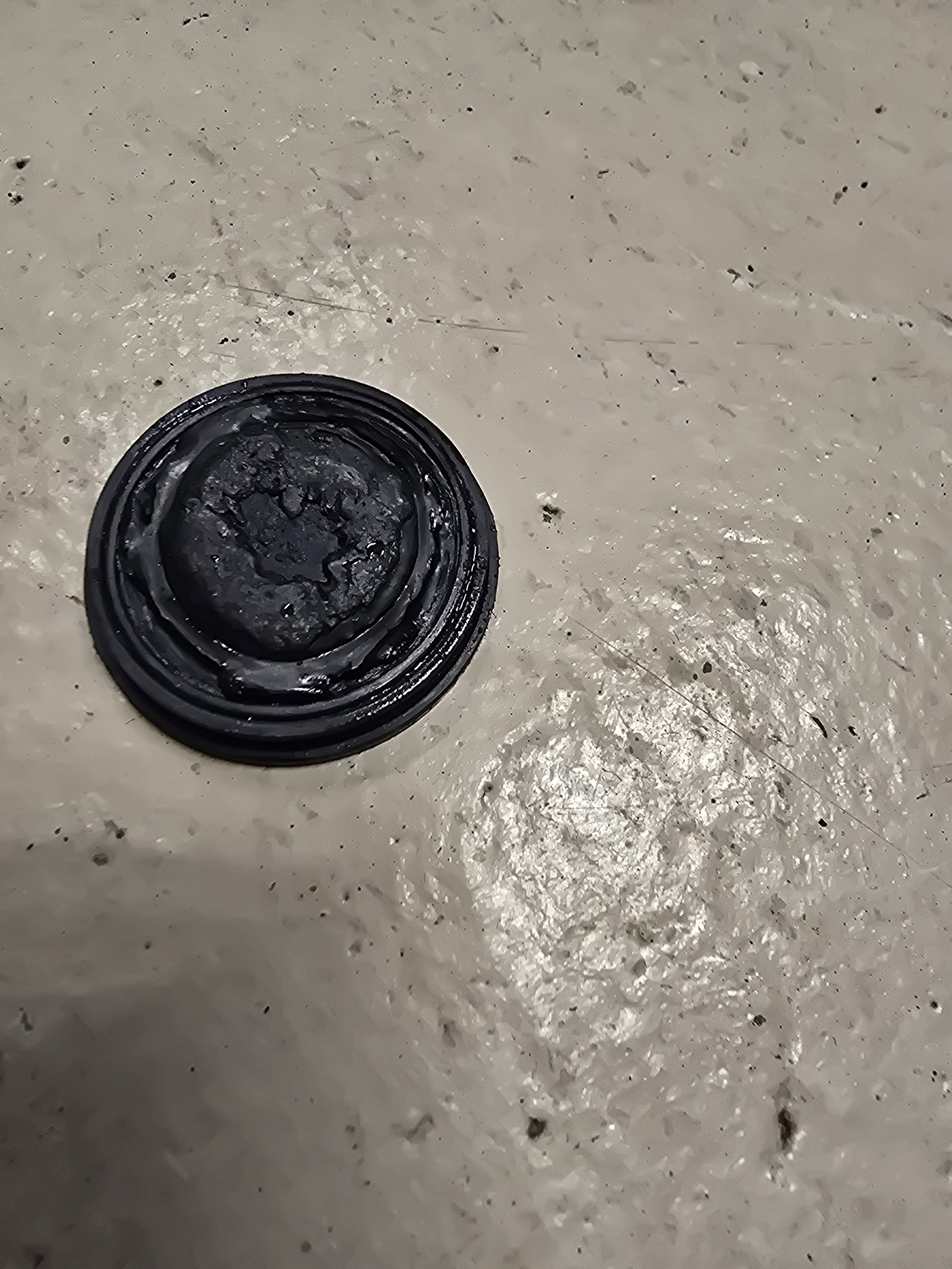

The new diaphragm looks different and is smooth with less impressions on it. Jon Don said they sent the correct one for my machine. Are the impression there because it's old or happen once installed?
12,679
The new one should be smooth.
The impressions are damage from the pulsations against the air in the “dry” side of your diaphragm.
Is there a deep impression around the edge of your diaphragm?
Post a pic, or send it to me by DM if you don’t like being roundly criticized by the insensitive and gleefully critical crowd here

photos

I think you'll find the problem to be solved...though you still might have a stuck check valve as well.
