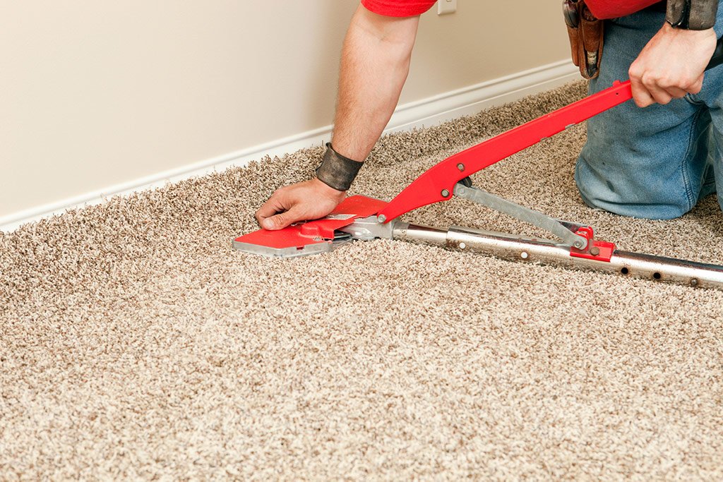

No way it wasn't that way before cleaning. Mike needs to pay for restretch. 🤭
If it doesn't tighten back up when it dries, we pay for the restretch. Even though we explain how it wasn't our fault, they never really believe you. Better to pay a few dollars for a restretch than to lose a customer and risk a negative review. We probably have 3-4 per year that we have to have restretched.

36 years, who knows how many hundreds of swellings caused...
To my knowledge I or the company I work for is ever had to pay for a restretch although that we did have one lady who had a installer next door who didn't know better and stretched it the same day of the cleaning and of course.. when it dried it ripped all the tack strip loose from the perimeter
