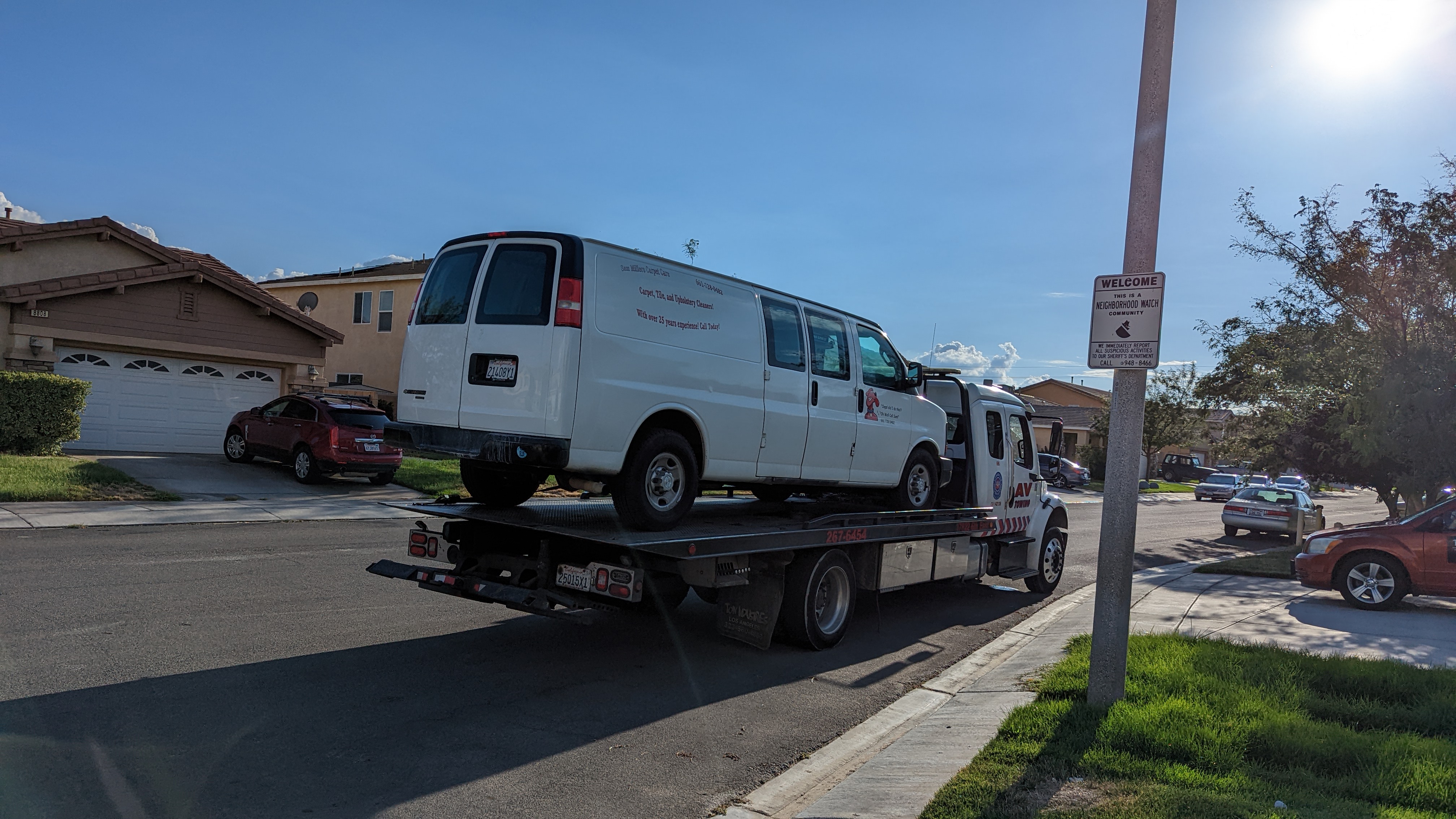

So I took @Cleanworks advice.
Sent it to a mechanic a po300 code is multiple misfires, and there is a boat load of possibilities.
I did manage to replace 7 out 8 spark plugs and wires.
They say a fuel pump going bad can cause this code too.
